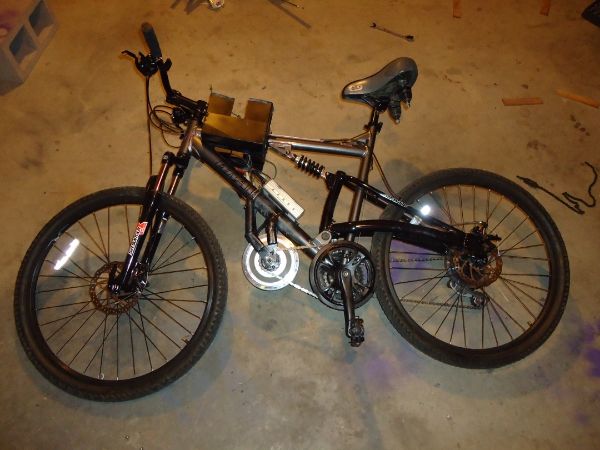

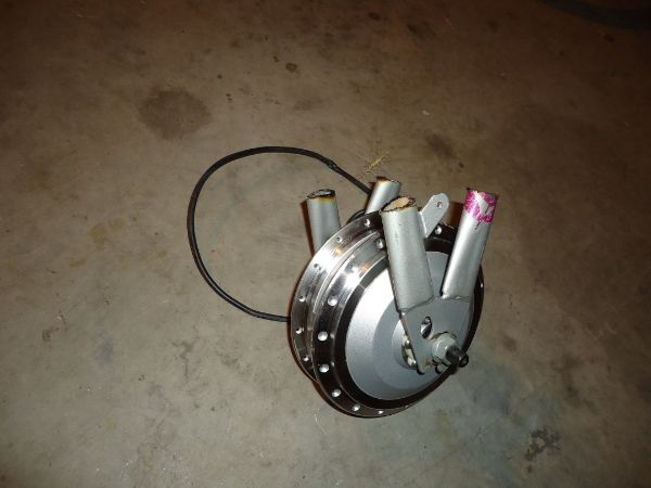

My GNG setup bit the dust back in July and I have been wanting to go off-roading again so I am building another off-roader.
For this build I am going to blow about $500.
Bafang BPM from evassemble.com $122
"Force" brand 48t crank from ebay.com $12
donor bicycle from thrift store to chop tail off of and put motor in dropouts $5
muffler clamps to attach donor bicycle dropouts to bicycle $10
velo-solo gear from ebay.com $25
Gravity FSX from bikesdirect.com $329
My trusty Lyen 12 fet sensorless.
Misty Glamour Fun bicycle riders best look away now!

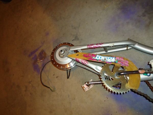

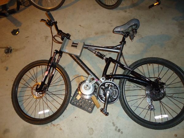

CHOPPO!

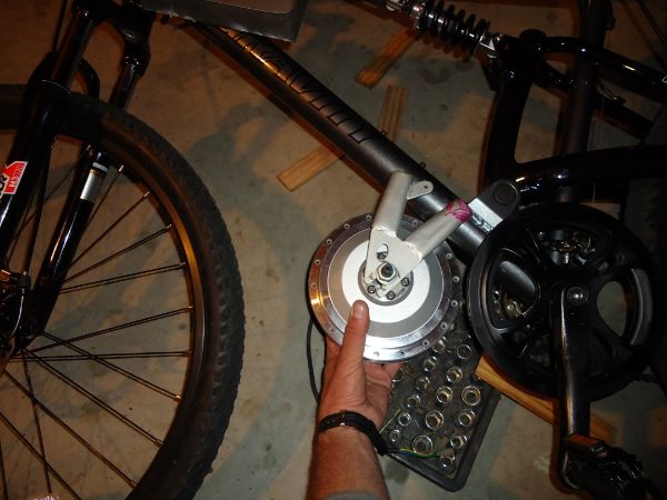

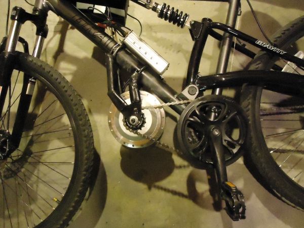

My original plan of having the dropouts like this fell through
and I ended up building them like this because the dropouts were blocking the chain. This is just a girl's bicyle dropout welded to a muffler clamp base; nothing too special

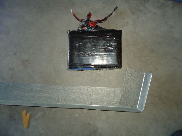

I built the battery bay out of roof flashing bent into a square.
All done

Looks good. Keep the updates coming. I hope everything goes smooth for you and you can be back on the trail soon. I like the left side pedal assist design, it has worked well for me.

I still have a dozen or more leftover laser cut dropout reinforcements in 7mm plate going to waste - I should post you a couple. They were made to precisely fit a BPM axle with no slack for my custom frame projects.
Must get a lot of torque back on the mid-drive dropouts. Or is spinout not an issue?

If the motor has a reduction of 3:1 to the BB, and then the BB has a common 1:3 gear-up to the rear wheel, then...the ratio from motor to rear wheel would be 1:1 and the drop-out torque on the axles would be the same. Typically, though. The benefit of a BB-drive is that the motor has the use of the gears, so when starting from a stop, the bike will be in a lower gear, so the motor can provide adequate acceleration with fewer amps = less stress on the axle/drop-outs. Of course the motor will top out at 10-MPH (as an example), and you will have to upshift.
If you take a hub-motor that is designed to provide 25-MPH when it's in the wheel, and then as a mid-drive you gear everything so that top-gear can provide 30-MPH, then...starting out in top-gear (whether by accident or on purpose), it is possible for a mid-drive like this to actually put more stress on the axle/drop-outs. Of course when you now have gear choices for the motor, that means it would be normal to make good choices.

I like your mounting bracket!
Great idea
