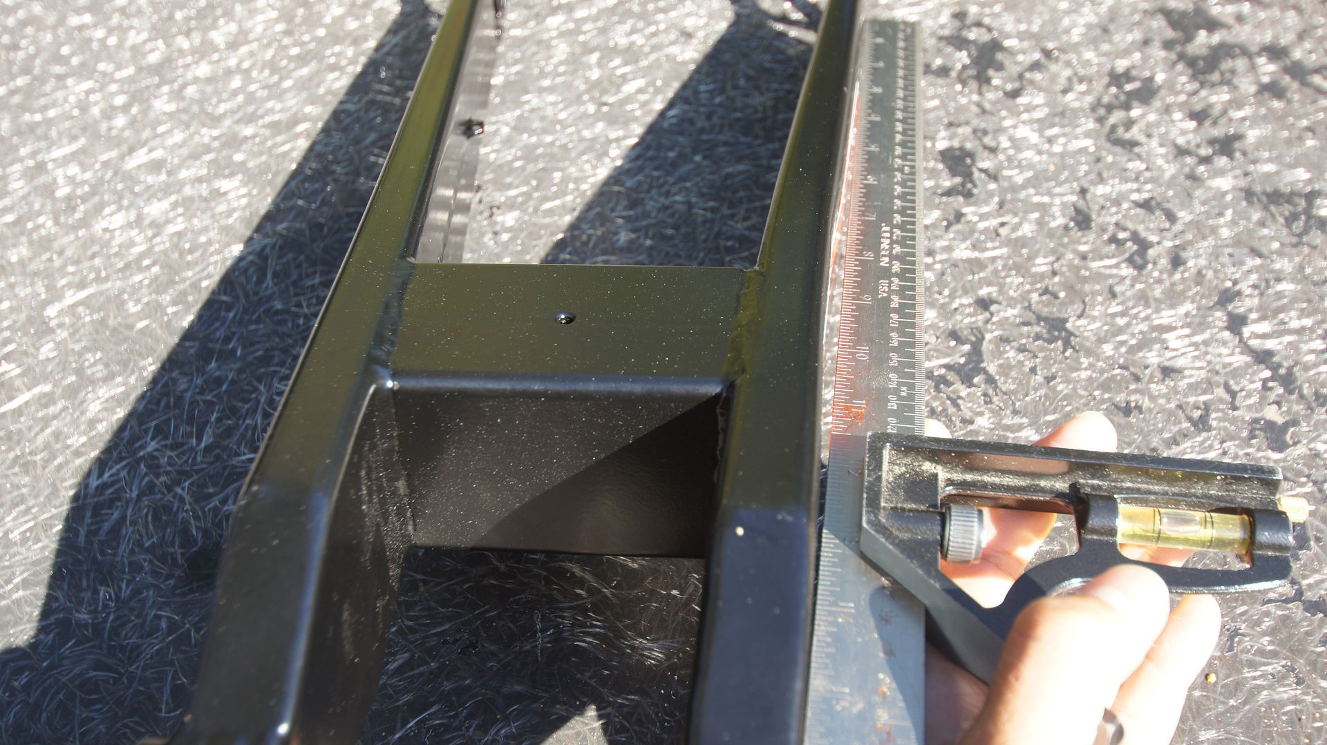

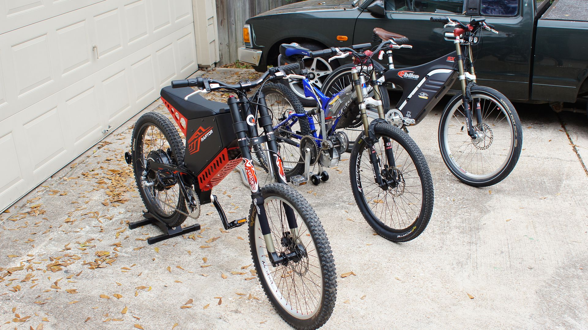

Here is what I received today. Shipping to the USA took about a week. 3 weeks wait time before shipment.

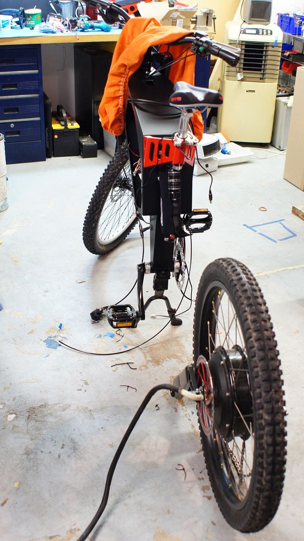

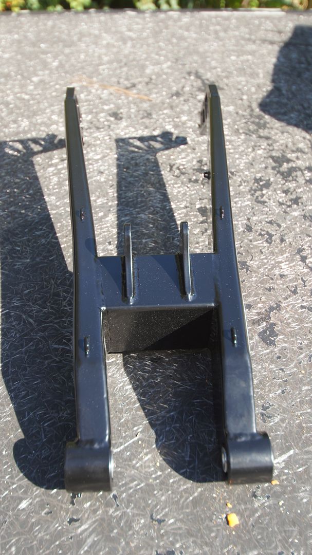

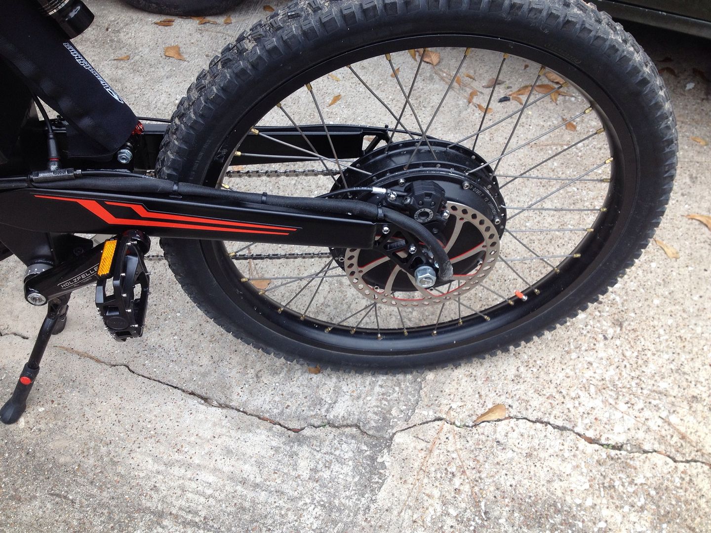

I installed a 26 x 2.3 tire on the 46mm rim. I had requested the dropout to support a Cromotor and 5 speed freewheel, thus 165mm dropout spacing. Well it looks like I'll go with a 3 speed or two speed freewheel instead. Too bad a Schlumpf drive can't/won't fit.
I am disappointed in one thing. For the money I have spend on this frame, I expected a non-tweaked chainstay to get too the 165mm dropout.

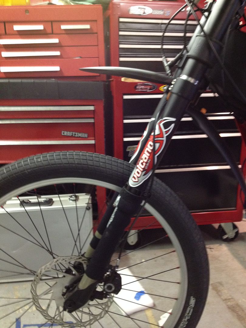

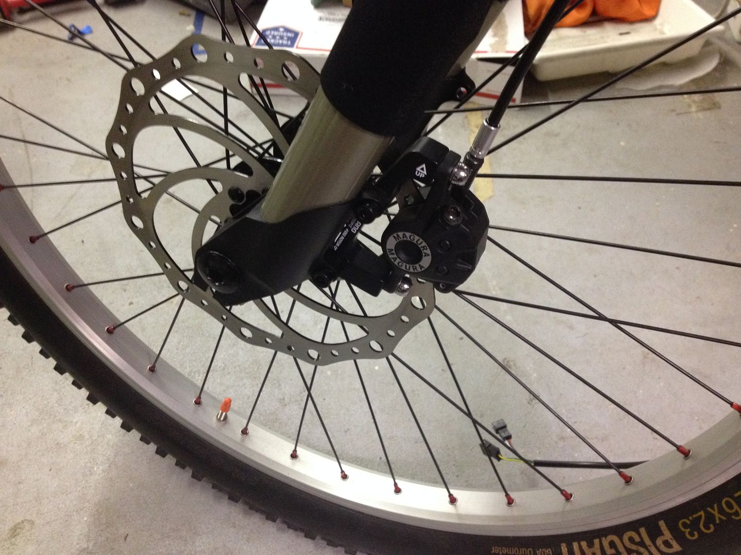

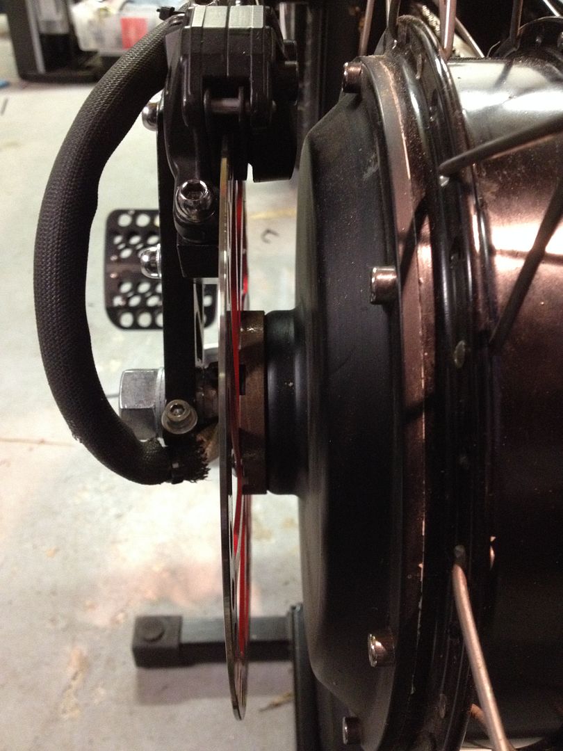

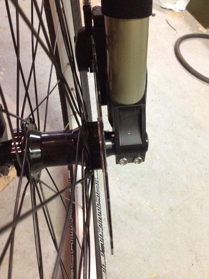

I have the DNM fork with dual disk brakes for the Raptor. Still deciding on a rim to mount on the hub. I have Zombies brakes as well.

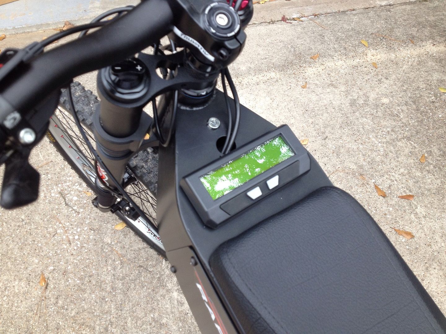

I have the CA V3 and Zombies 18fet controller to go. But I will start off with Lyen 18fet sensorless controller. Batteries will be the same 18s2p Skylipos that I've been using on my other bikes.

No shit, they actually bent out the rear swingarm to fit 165mm? They should build a wider arm later, and send it to you for nothing, or maybe just the shipping cost. Or did you bend it?
Nice dual disk brake options sounds nice, I might just get my own Torque Raptor next summer, winter is almost here and it way harsher than most places
dogman said:
Looks fun to assemble as it will be to ride.
I didn't bent the swing arm. The dimples are at the exact same spot on the opposite side. Kinda mess up on their part right.

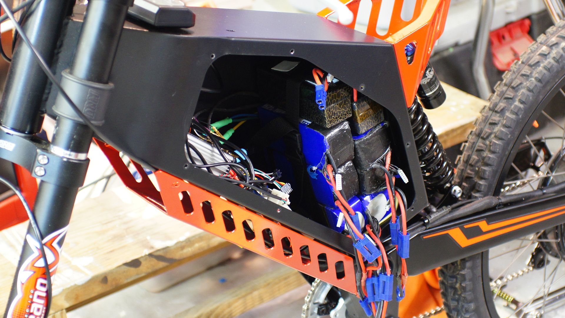

The build looks like it will be fun. This thing has so much more space for batteries compared to my EVG bike. That EVG bike is due for a rebuild, as it's acting up a bit. Lyen send out the 18fet controller yesterday, but I used my old address by accident, so I'll have fun tracking it down.

Everything is steel, the body is 160mm wide. It was intended I believe to fit 150mm lipo batteries sideways to really stack them inside the case.

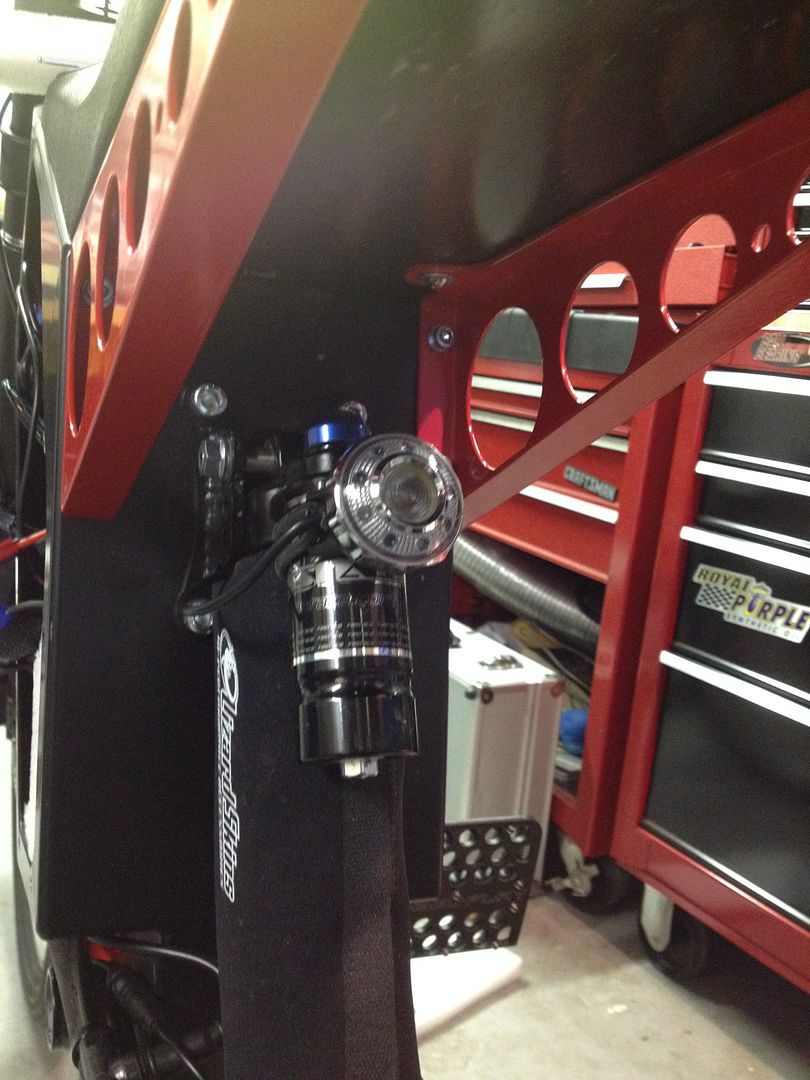

Here's Zombies 18Fet controller. This is when I want to play with regen at 24s. But for real running on 24S, I will need a bigger controller for the Cromotor.

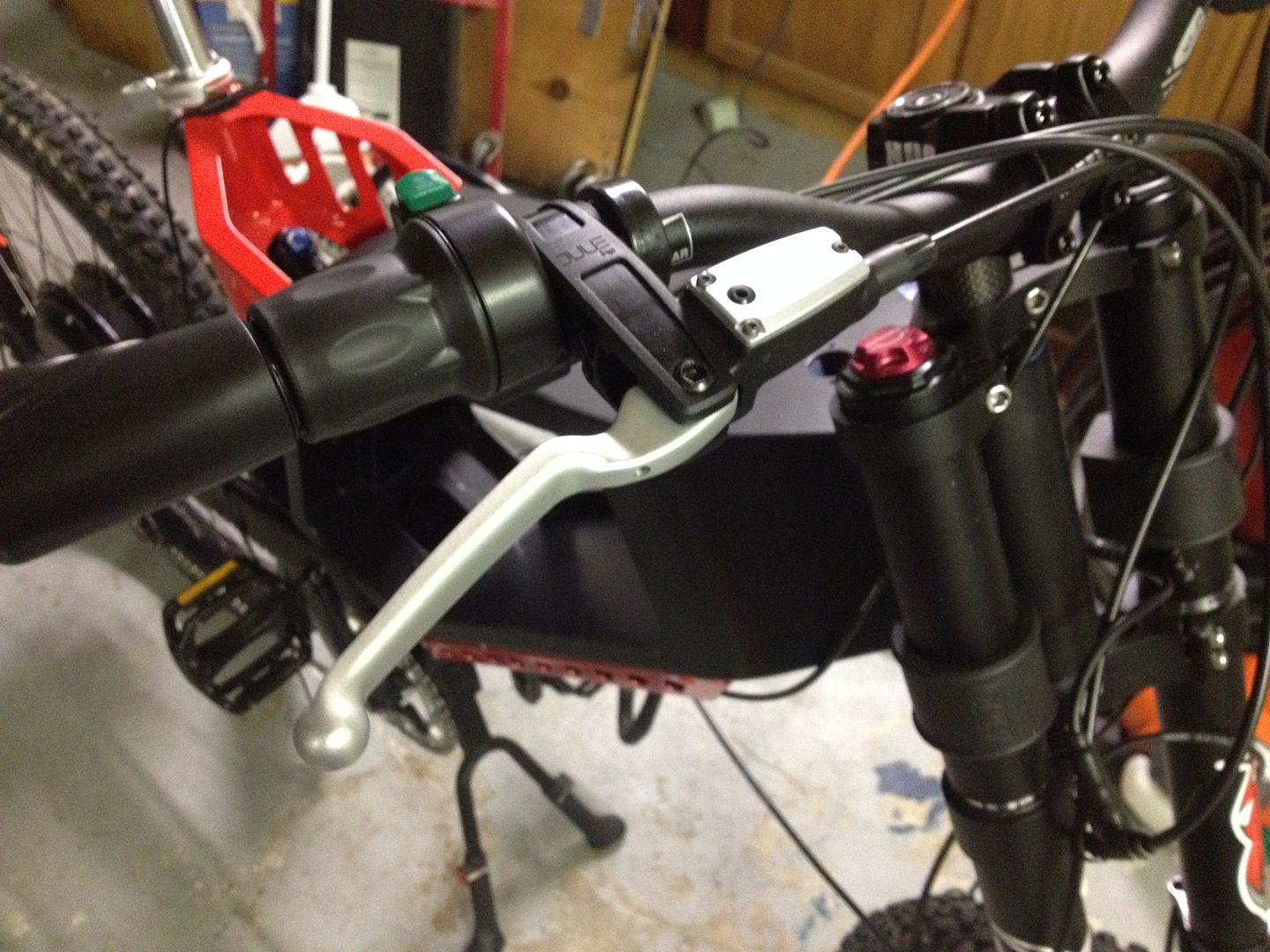

This is the Hygia E-hydro brakes I got through Zombies. Uses a hall sensor that is screwed on the bottom of the brake handle.

Mine came this way too, I also have the 165mm swing arm however, I was not sure about the reason until I put the cranks on and pedals if those dimples where not on the swing arm at least in my set up using an 89mm Bottom bracket and crank it barely clears it if it wasn't for the dimples my pedals would hit the swing arm. In other words if they weren't there I would have had to go to a 100mm BB and 100mm crankset and that would narrow your choices quite a bit. So in my case I am glad they are there. My 2 cents and thoughts. I don't know if its on purpose or from bend but I don't think bending it 5mm in each arm would cause the dimple.
bending / crimping the frame chainstays during production is a pretty common practice to get clearance for tires, cranks, etc..

I received an email from Torque regarding the indentations. After seeing my picture, they are going to send me a new arm. They mentioned that they worked on some new tooling to to fix this issue. So it's good to know that they stand behind their product and wanting to put a good product out on the market.
