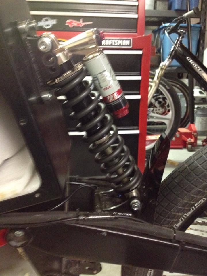

Scored me a Manitou cheapy 10.5"x3.5" shock. Used a 300lbs vs the 400lbs spring on the 9.5" x 3.0" shock. Pedals just as nice on my way to work. I haven't gone off road yet.
It's the last shock on the right.

My vendor took back the batteries thank god for him, and is shipping me 220 Sony 18650VTC5 at even a cheaper price so all is looking good.
Hey I see you have Crazybobs on the back how are they holding up? You still recommend a 400lbs spring on the 10.5 x 3.5 shocks? I ordered a TI Spring at 400lbs in Gold :D
In that last pick I think I see a T connection is that for a break light mechanical switch?

The Crazy bobs work great for me. Roll really well at any speed my bike hits. I'll buy a 400lbs spring next week and see how I like it. I'm going to hit some dirt trails on my way home today and see if I need the heavier spring. Or maybe I'll just stuff the shorter 400lb spring on the current shock and see what's up.
The T connection is indeed my brake cutoff switch.

Ok, went offroading a bit on my way home. I'm liking the softer spring with harder damper setting. My behind was happy went I made it home. Lots of suspension travel.

As of this morning, I'm 180lbs. Road riding is smoother with the new shock and spring combo. I'm still going to spend some more time tweaking the HS and LS settings. I will be ordering some new shock oil too. Most likely going with Torco medium shock oil, as it can get pretty hot in Texas.
These are the shock specs
Damping Shim Stack
Adjustments Preload
Rebound
LS Compression
HS Compression
No Tools Volume
Damper Shaft Material 14mm Aluminum
Damper Shaft Finish Hard Anodize
Damper Body Color Black Hard Ano
Bushings Steel/Teflon
Eyelet Hardware 2-pc Aluminum through 37.9mm 3-pc S.S. at 38mm and wider
