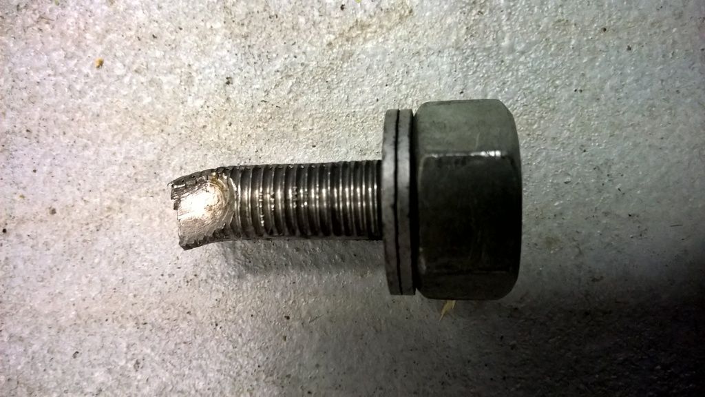

In other news, I broke the axle on my Cromotor riding around the backyard.

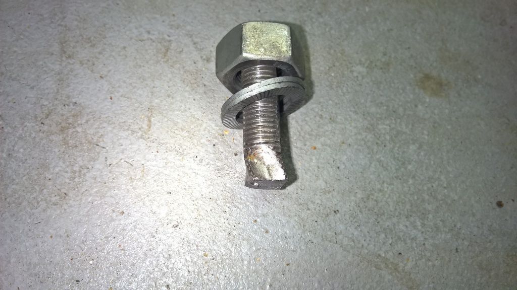

I think the V1 had some failed axles, but I could be wrong. I'm just glad the axle failed at very low speed while I was giving my kids rides in the back yard. Failure at high speed would of hurt badly.
The axle failed where the threads on the axle ends towards the disc brake side. I'm wondering if the crazy regen is what caused the failure during my commutes. I didn't over torque my axle nuts as I'm using Nord lock washers.
Now to find a new axle or getting somebody to make me a new one.

I broke an axle on a v1. It was due to a controller syncing problem with the motor. It went from full throttle to locking the motor up at about 40mph and 15000w or so. The axle sheared on both sides and shot out of the back of the bike. I don't have the pictures on my phone but will try to find them later - I can't make this shit up haha. Pretty scary stuff. Luckily it was raining and the roads were wet so I just slid across the pavement and was unhurt.
There is a 3D drawing of an enhanced Cro axle here on the forum. Search for Cro axle. IIRC that cro motor had the axle snap at the exact same spot. After new axle was milled problem was solved. Maybe you can use the same drawing? If you like it and think dimensions are the same as your axle you could just send the 3D drawing to any machine shop and have them give you a price quote.

I'm thinking regen did it over time. I would say the Sabvoton pushed it over it's limit. The 18 fet controller before hand did not regen as hard as the Sabbie.
Well I know a machinist here in Houston and I'll go ask him what it will all cost me for 3 units. I'll bring along the pics to give him an idea what improvements I need over stock.

I'm using 180A regen with the Sabbie. That is border line lock up with the sticky Michelin's. The motor is a V2 that I got through Zombies Greyborgusa site and I have less than 2700km on mine.

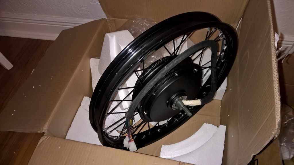

Post by snellemin » May 25 2016 7:31am
Received a new QS motor yesterday. 19" moto rim with 5T motor. Wheel is laced for a single speed freewheel, so it's offset. Going to have to move the rim to the center of the motor. That way it seems I can use spacers just on the freewheel side and still put on my old 5 speed freewheel.
Silent speed Racer

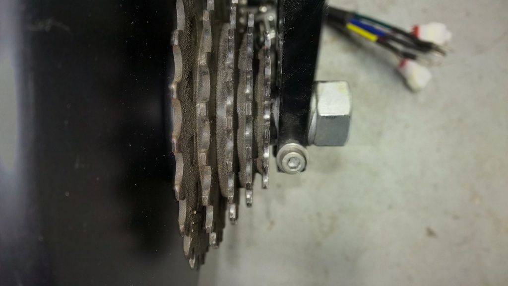

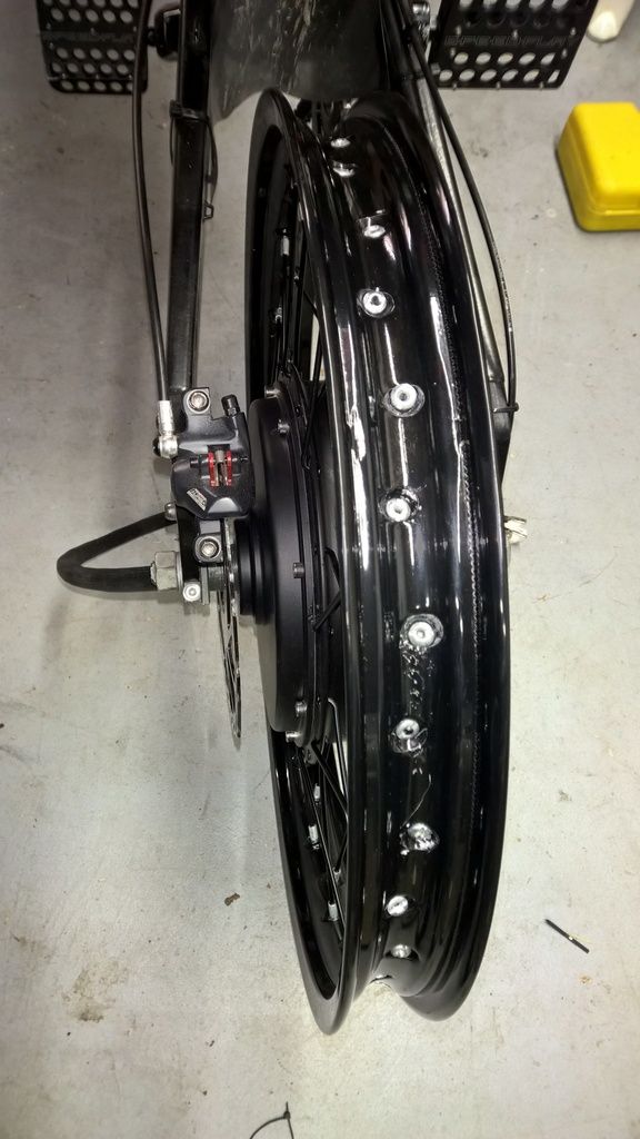

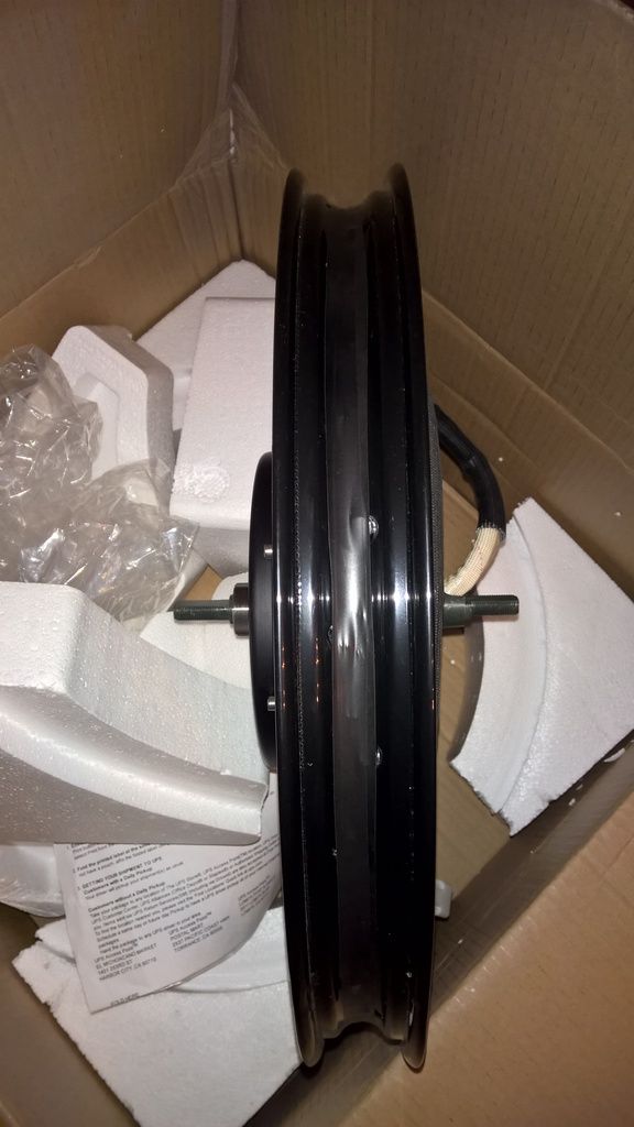

Post by snellemin » Jun 10 2016 2:27pm
With some spare time, I'v test fitted the new QS onto the Raptor. I must of gotten a version that was made on a Friday. One spoke was over tightened and a few barely took any force to loosen up. So the over tightened spoke just snapped when trying to break it loose.
Plus side its that I don't need a lot of spacers to fit the the QS into the swingarm with the 5 speed freewheel. Spokes have been ordered from Holmeshobbies and some disk rotor spacers from Fleabay.
The Cromotor side covers is where the big difference is between the QS covers. I never heard anything back from Greyborg in regards to a replacement axle, so they lost me as customer for good.
I got me a Shinko SR241 19" x 2.75. It's just a bit shorter then the 26" x 2.3 Michelin Pilot Sport.
