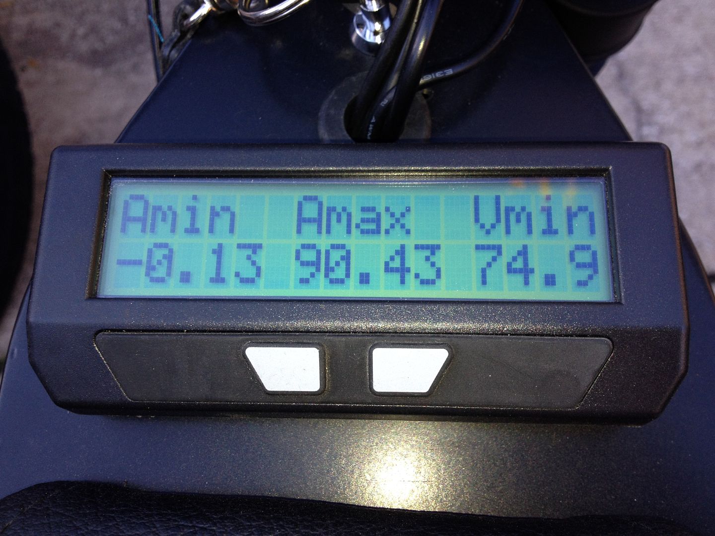

I increased the phase current to 150 and the battery to 73A. That little bit made quite a difference in how the bike behaves. Torque went up and throttle is a bit more aggressive. Climbing power is better too. Time to mess with the throttle setting in the CA.

I finally found the correct shunt value of my Lyen controller. My CA reading matches what my charger puts back in. Value is 1.233 ohms.

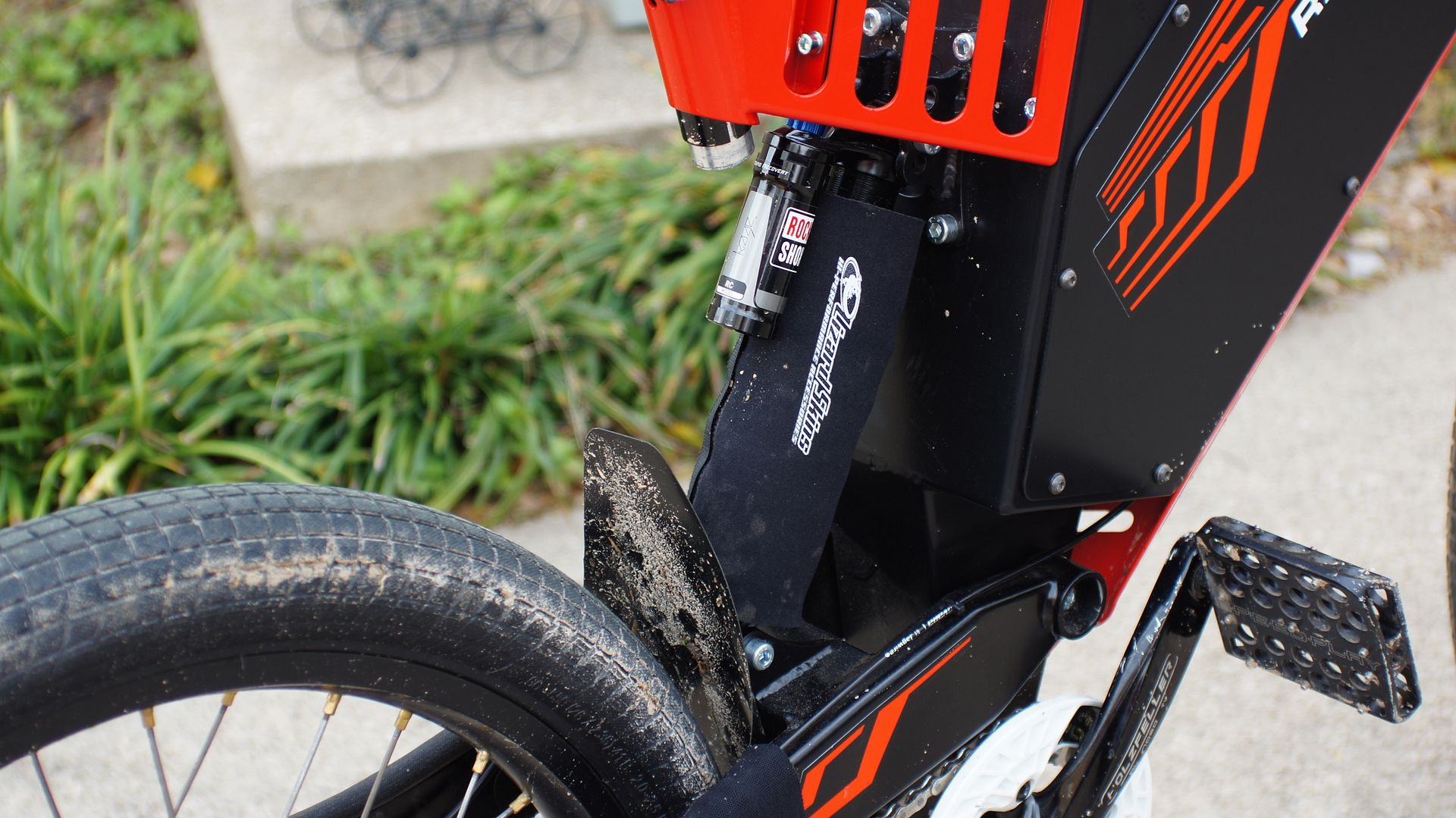

Made me a fender based of Mucky nutz. I used some privacy screen for an LCD monitor I had laying around. Still need to punch some holes in it to mount it.

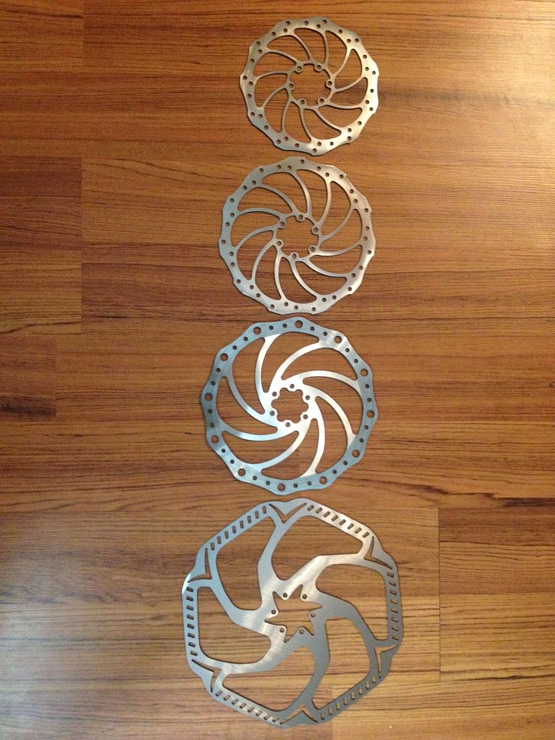

I got me some 255mm rotors. These are big!!
This is the 203mm on top of the 255mm.
From the top: 160mm, 180mm, 203mm and 255mm on the bottom

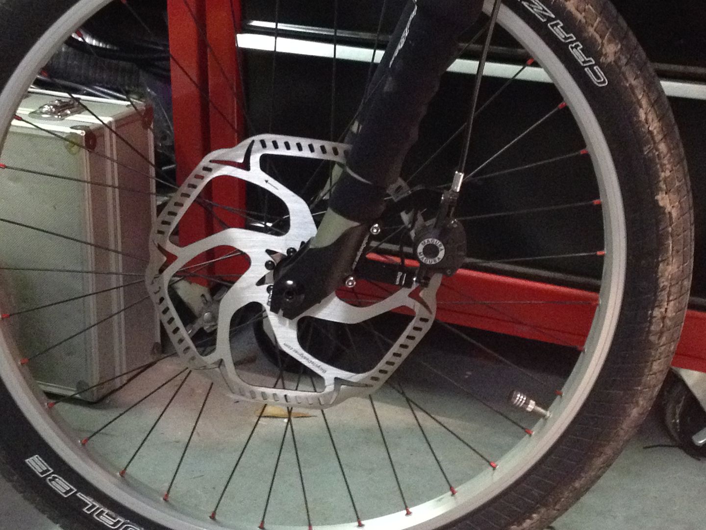

Well, I broke my front caliper. The brake caliper broke by the screw mouthing holes. I ordered a new brake and some other adapters to take the side stress off. I'll see how well it does before spending money on some better brakes.

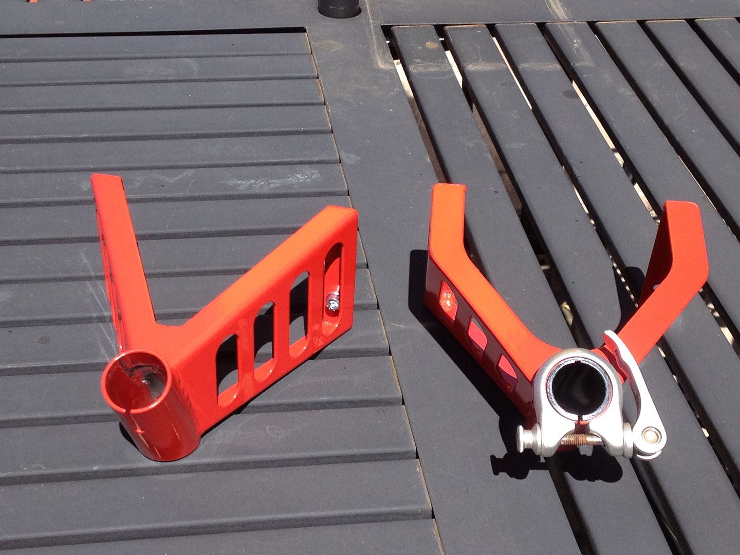

I received my new bike seat assembly along with a new shock and shock bushings. Now I just have to find my bushing tool for that Rockshox

I installed my new bike seat assembly and tried out a new battery and phase current setting. Almost 11HP. Fun for offroad, but not so much for onroad.
My inner thighs don't rub anymore when pedaling with the new narrower bike seat assembly.

Qulbix had posted the new seat assembly and I jumped on it. I had to wait a bit, as it had to get painted to match my original assembly.

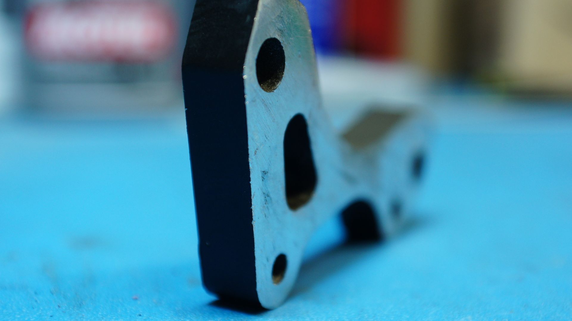

Messed around with the bike today. Swapped shocks and springs along with a new brake mount for more clearance.
Swapping springs. New spring is 400lbs. Left spring is 300lbs Titanium, center is 350lbs and right spring is 400lbs.
I just hang the bike when I work on the shock or drive train.
Shaving off some material from the original mount wasn't enough.
