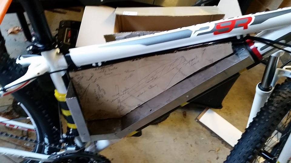

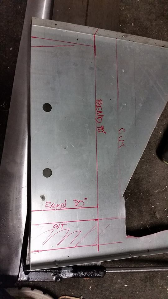

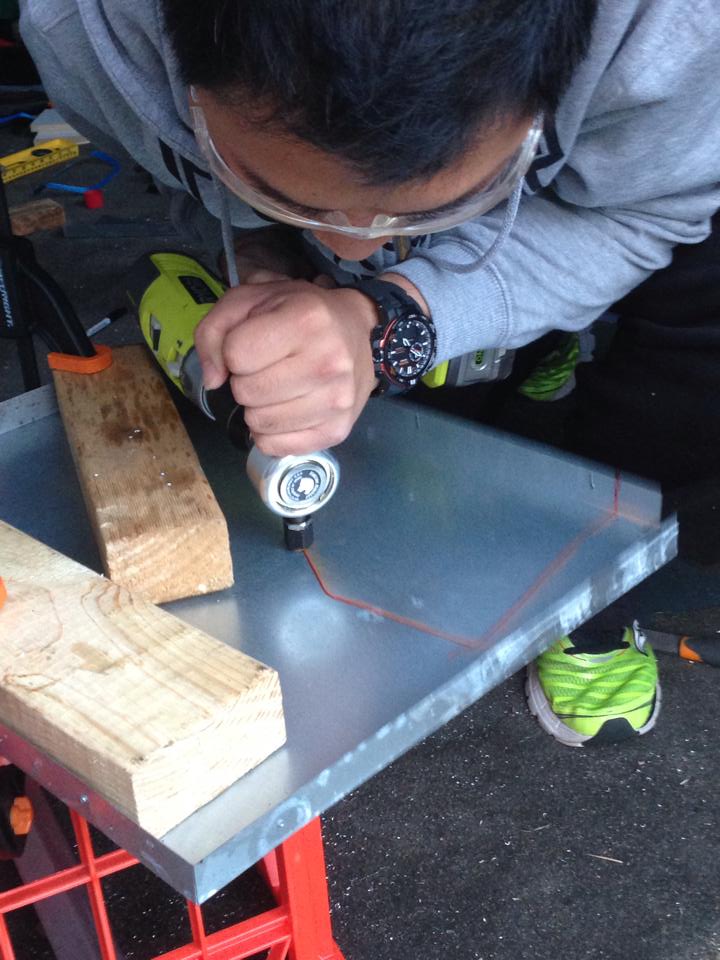

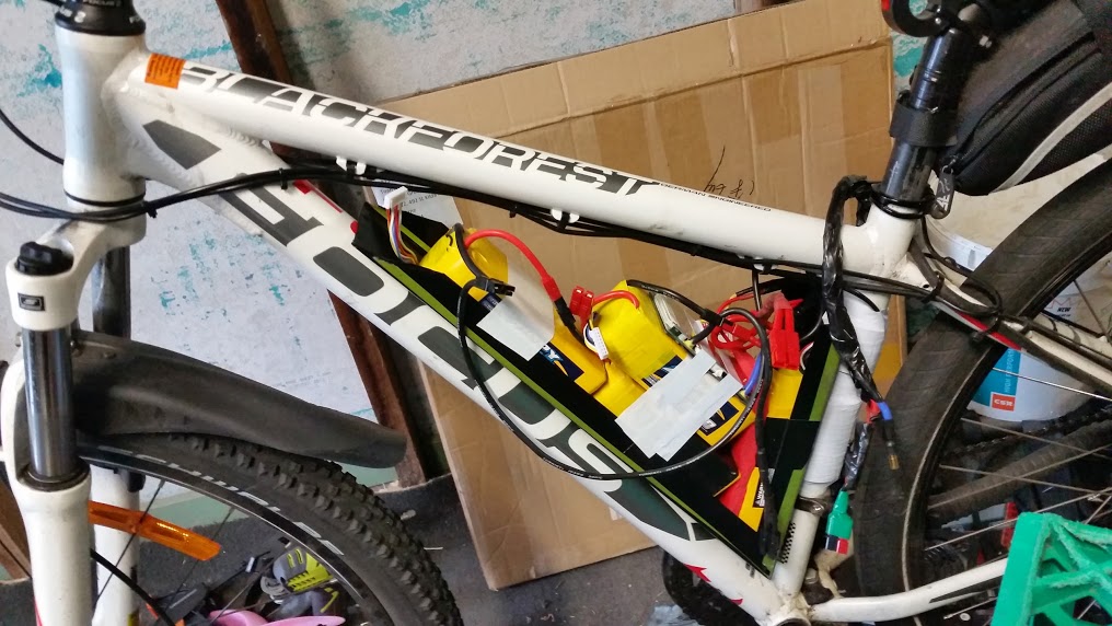

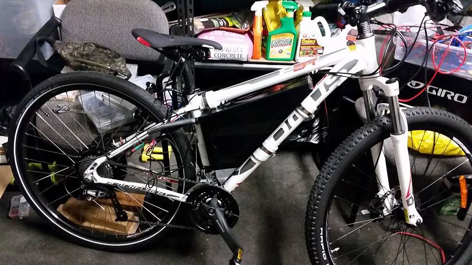

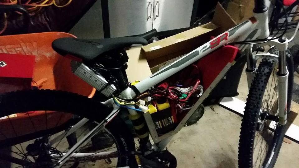

I've finished my build with a centre frame made out of sheet metal (cheap galvanised steel). it measures 13.5cm wide so still room to pedal (although my feet sit on the middle/edge of the pedal until I get used to it).
Here's some build pics :
Bought an Irwin sheet metal nibbler (cuts sheet metal for $100)
I bought a sheet metal bender ($80) to do it properly :
Did some frame templates out of cardboard.
lid design (my design isn't that complex)
test fit 1 :

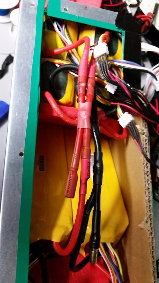

I can fit another 2x 5800mAh lipo in there (waiting for stuff to be delivered sucks =/ )

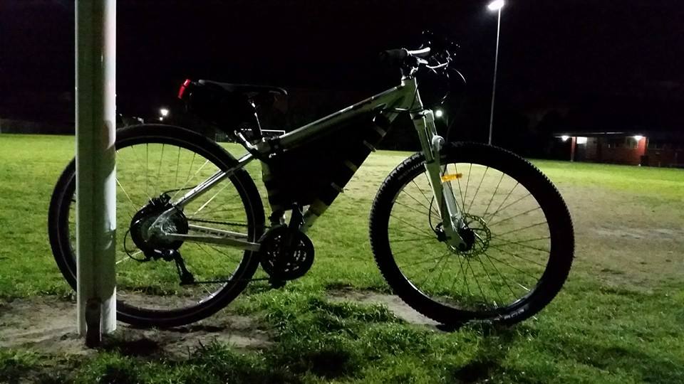

Test ride to work today
On the way home I decided to take a snap in the local park :

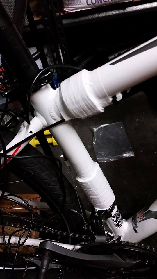

I used some automotive rubber hose cut up to protect the frame. Then some hose clamps through some slits in the metal to clamp it down. 2 at the bottom to hold it down and 1 at the top near the back to stop sideways movement. I've burned through about 150 cable ties, 100m roll of duct tape and about 5 Litres of good whiskey.
So far so good. I've got way too many cables to jam into the triangle at the moment (should make it fit if I shorten the cables) but balance cables are everywhere... it's a frocking mess. So I've left the controller in a bum bag under the seat. Waiting on a large 21cm wedge saddle bag to make it all fit nice (Ebay + Hong Kong == whenever it arrives, it arrives... But hey... It's cheap ).
The ride difference between having the weight on a rear rack/pannier compared to in the centre frame is like night and day. Heaps more manoeuvrable and less bumpy (probably since I have a hard tail). Its also reduced the tendency to lift the front wheel (since weight is now more centred) but still bunny hops a bit if you punch the throttle from stand still. If you have your weight on a rear rack, make the change to centre triangle. You won't regret it.
When the 2 extra batteries come in I'll try to fit the controller and all connectors into the triangle, but so far it's good enough to get to work and back.
Thanks for all the help guys, it's been a great experience and heaps of fun (except the being doored part) =)

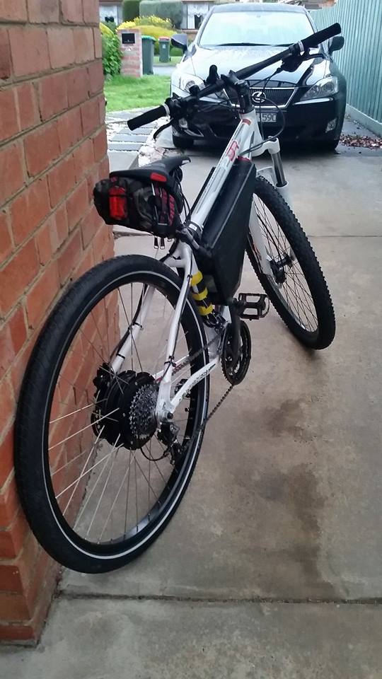

Update 2014-07-13 : Nearly complete (as in how I want it)!
Final specifications :
Bike : Focus Black Forest 7.0 29er hardtail from bikes.com.au - Strong MTB frame, Medium size gap in frame triangle, Hydraulic disc brakes, 29er wheels.
Motor and wheel : MAC 10T on Alex Rim 29er with Disc brake from em3ev
Controller : 12 FET IRFB3077. handle up to max 60V and 40A. (Typically used for 48V). 2KW setup... from em3ev
Battery BMS : 14S 40A BMS from em3ev.
Charger : 14S charger from em3ev. Charging the pack via BMS is so simple... Just plug in 1 connector and go. I don't know how you guys do separate charging...
Battery : 6 x Zippy Compact 7S 5800mAH 25C. Wired as 14S3P (58V fully charged). Yes thats 17400 mAh fully charged.
The Extra two Zippy Compact 7S 5800mAh batteries came in and fit in the in frame box nicely :
Took the time to clean up the rubber protection hose pads by cutting them to only where the hose clamps are and then wrapping them in white electrical tape. Looks a lot cleaner :

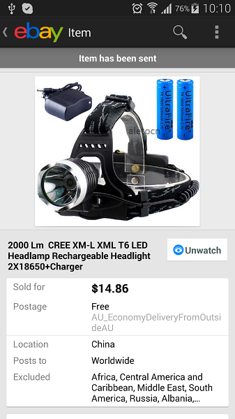

I forget to put up pics of the controller in the saddle bag... $9 ebay special... Its a large bag so it fits the 12FET with room to spare =)

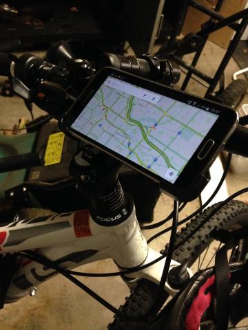

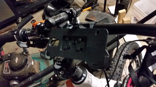

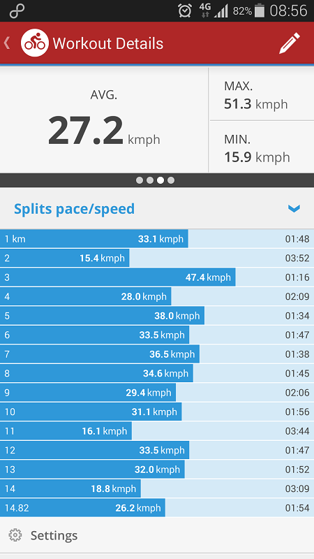

Man... talk about continual work in progress =) So I've been running without a bike computer and decided to order a wireless unit from ebay for AUD$7.15 ... From China/Hong Kong, so its anyones guess on when it will arrive here. So being the impatient bastard I am, I've torn apart my car phone holder mount and bolted it onto a spare lock mounting mechanism I had lying around to have mobile tracking/maps while riding. The phone holder was $7-8, so no biggie if I frock it up.
This is what I ended up with :
With my Galaxy S5 mounted in there (Galaxy S5 is waterproof) :
First thing I do the next day is obviously map my ride / top speed / average speed. It turns out all my calculations on top speed with a 29er/700c wheel with the MAC10T was based on 48V operating voltage (no real measurement until today). With 14S, I'm running 58V hot off charger or 57V on commute charge. This pips the MAC10T to about 50km/h with the larger diameter wheel. FREE BONUS SPEED THAT I DIDNT KNOW ABOUT!!!! WHEEEE!!!!
My ride to work in 8am traffic. (gotta slow down closer to CBD as traffic goes everywhere) :
So to anyone who is wondering. YES! A MAC10T on a 29er will do 50km/h on a 14S battery Pack. And when choosing battery size, every 5800mAH = 15km (mix of hills and flats).

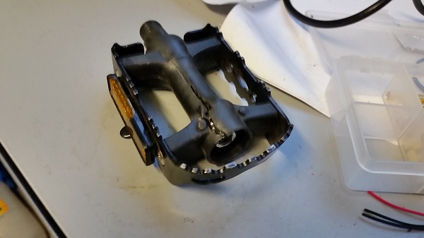

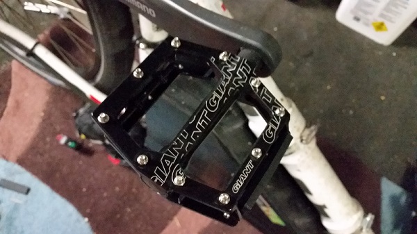

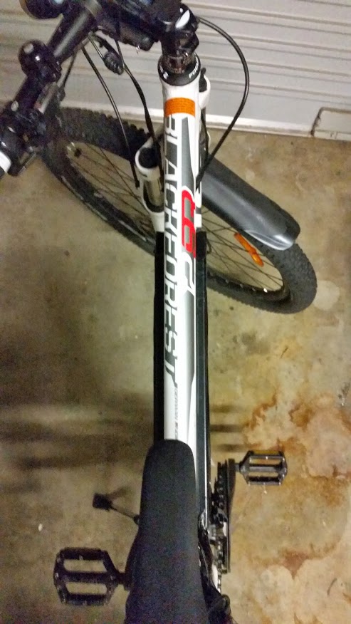

First failure! And it's not the motor or batteries... It seems the stock pedals cant handle 90kg pounding on it, so it finally 'cracked' it!... right down the middle =( Should be illegal to sell pedals that are so crap!
Having a chat to my other MTB mates, they highly recommend the Giant Brand MTB Core pedal (large for fat feet people like me) and the pins provide amazing grip for the price. You can get these at any Giant store for between AUD$40 and AUD$50. Quick swap over... and OMG... The grip they provide is like night and day compared to the pedals that came with the bike!
The 9 speed freewheel came in and it dialed into the rear derailer pretty perfectly on the MAC motor. I'm not sure why everyone recommends the 7speed? There isnt an 'abundance' of room, but nothing rubs on the frame or anything?

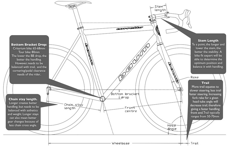

It's probably the MTB geometry, but the bike feels a bit wobbly at that speed... I need a longer wheelbase for more stability I think...
I've struggled with this and it's a pain to get rid of. Two wheel vehicle handling is tricky. It might not be as simple as a longer wheel base. It could be, as in my case, that the fork is too long. Or the fork could be too short. I don't know, I'm not an expert.

Post by Samd » Aug 10 2014 6:57pm
It's coming along.
Headstem angle is key.
http://ballaratebikes.com/
Raged   1 kW
Posts: 384
Joined: Jan 02 2014 12:15pm
Re: Raged Focus Black Forest 29er MAC 10T 40A Build log!
Post by Raged » Aug 11 2014 12:09am
Samd wrote:It's coming along.
Reading a bit about bike geometry and came across this gem :
http://cyclingtips.com.au/2011/02/the-g ... -handling/
I'll lock out the forks tonight then try to lower the stem a bit (mine's set too high anyway) to increase stability to see how it goes

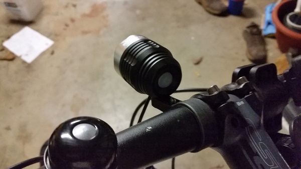

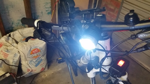

Adjusted my Samsung Galaxy phone mount to take video... Bike light is in the way on the left, but lights are important... and I couldn't be assed moving it. You can get a sense of speed and the versatility of a 29er to roll over stuff like an MTB as well as have the wheel diameter to punch speed like a 700c wheel with the added benefits of suspension on the roads.
This is the MAC 10T on full charge (14S lipo) riding around Murumbeena on a typical Melbourne day (overcast and heaps of wind).

Some more parts came in!!! Ebay $14.86 delivered cree XML-T6 headlight with 2 18650 batteries (probably fake 1000mAh... but there's 2 of them!) and charger.
First off, lets just say it's probably about 800-1000 lumens which is VERY bright but not retina burning 2000 lumens.

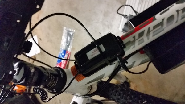

I purchased this as I was using a XML-T6 torch mounted to the handlebar previously. As it's angled down, changing batteries every day was a pain and a half. I needed a simpler solution to charge my lights when I charge my bike.

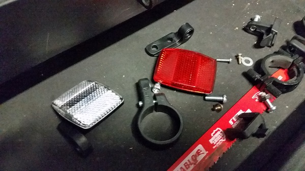

I took off the headband so all you have left is the lighting kit. Then used some spare mounting brackets from the various spare parts drawer...
And mounted it :
Battery pack holder cable tied down :
The headlight just screws out with 1 phillips head screwdriver and mounts onto the handlebar mount pretty much perfectly with an additional small washer which I luckily had on hand (computer case tab).
The light has 3 modes. One press is high beam, 2nd press is low beam and 3rd press is flash.
Additionally, the add says its waterproof. It's not. There's a big gaping hole on the bottom where the wire comes out that isnt sealed. Some silicone should fix that up pretty easily though.
The charger that comes with it has an extremely short cable which I will probably lengthen when I get around to it. But now I can charge my bike and lights at the same time.

Yeah this hill climb vid - 12% :
It's just my samsung Galaxy S5 on the handlebar mount pictured before.
I just rotate it so the camera points above the handlebars.
It works ok for what it is, it's just a bit bouncy as it's mounted directly to the bike. When you mount it on your body, your legs act as an extra level of suspension so videos are smoother.
Heres a video I took on the way home last year... as you can see... its a bit bouncy.

Updates :
Evolution of my battery box. The previous setup was ok, but I just wasn't riding as comfortable as my fat legs were rubbing on the battery box. I had to redesign to make it thinner.
Solution was to use the bottle battery mounts and instead of double stacking the batteries sideways, I'd just have 1 stack organised tighter and higher. I'd have a reduced 11600mAh of juice (14S2P instead of 14S3P), but it wouldn't make a difference to my commute anyway.
Ended up with this :
The metal is a piece of steel wall peer. $13 for 3m...
You can pick it up at the local hardware store :
http://www.bunnings.com.au/steel-track- ... t_p1090596
Use of rubber hose to space the battery box out from the frame so I can still adjust front derailleur if I needed to... then white duct tape to blend it in and a hose clamp to hold it in place.

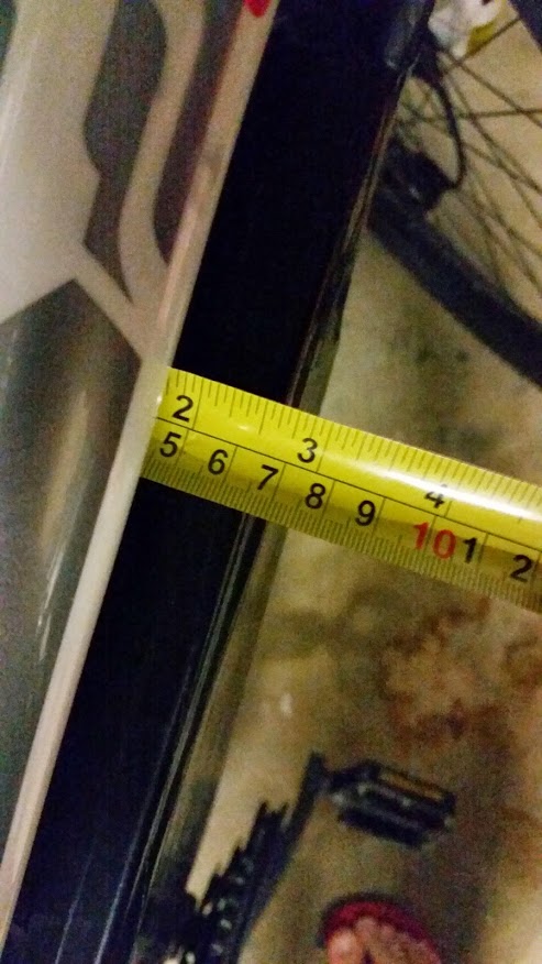

1 stack of batteries greatly reduce the width of the battery pack
7cm wide. I can pedal like normal and there is no knee rubbing!
