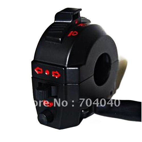

I've been using a cheap eBay motorcycle bar control with horn button for regen, for a few yrs now. Its the only way to go. I choose when to regen.

I prefer the Chinese horn button meant for an ebike for this use. That's because it puts my thumb below the handlebar instead of even with it, a better place in terms of safety because in hard braking situations I want both hands and thumbs wrapped around the bar, not a thumb kinda parallel to it. It feels more natural too.

I've never been a fan of the ebrake levers and have been using horn buttons since golden motor started supplying them with their magic pie kits back in 09 (ok the pissing contest to see who was doing this first is now on :lol: )
The ones integrated with the throttle are good but I prefer this style as it can go on the left hand side so you can activate it with your thumb while still modulating the front brakes as precisely as you like. You can still activate the rear lever with the same hand but it feels a little less precise if you're holding your thumb on the button while squeezing the lever with your other few fingers.
They are a bit flimsy though and I did manage to break one in a light crash.
When I built up my custom stealth a few years back I switched to motorcycle switch gear. It's heavier duty, the buttons feel nicer to operate and it looks cooler too.

I like the horn button idea...I'd use the one on my ex-scooter handlebar control cluster, but it is being used by the pair of car horns. So I'm presently using two parallel brake levers on hte left side--one is for the brakelight and will be for the rear mechanical brake once I weld studs on (if I ever get around to it), and the other is the regen ebrake (presently on the front wheel). The rigthhand only has the one brake lever, which is just for the mechanical front brake. If I were to have both motors on htere front and rear, with regen available on each one, I'd probably add another lever just for regen on the righthand, too.
So with normal braking "instincts" I can use any or all of the levers as needed, with my thumbs free to use on controls or whatever. (or to hold on better if I have to :lol:).
But the button would probably work better for most people. :)

I recently bought a pack of momentary buttons off eBay. They are quite small and work perfect for regen on my cargo bike. Will get link later. Prob not as durable as horn button I'm using, looks just like the control with turn signal hyena posted.

+ 1 on the motorcycle handlebar controls.
Some of the left controls have headlight on/off, headlight hi/lo, 3-position turn signal, momentary horn, and a choke lever either electric or cable.
It would be great to be able to use the choke lever to control the rate of regen on hill. You could use a switch to toggle from variable-always-on to one-setting via horn button, or whatever the choke lever has selected in conjunction with the horn button.
Kill switches are good to have if you are trained to use them reflexively.
The front brake levers (right side) on cable brake motorcycles are rugged and have built-in N.O. switches. On later (1980+) motorcycles, some had a switch on the clutch lever, so that could be repurposed for e-brakes.
Also, the lever perches have mirror thread-mounts. The Yamaha perches have reverse thread on the right so if something whacks the mirror toward the back of the bike, it loosens.
My 1976 Yamaha RD400 had a nice turn signal switch that allowed you to simply mash straight in to return to the center 'off' position without fine control needed by your thumb.
Lots of possibilities with all those switches available. You could even have a (variable?) resistive braking circuit for redundancy and for high current regen situations.
