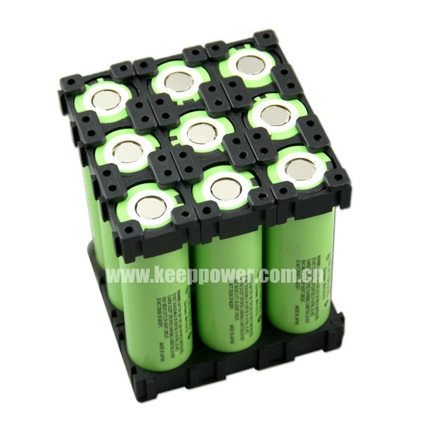

latecurtis wrote:
Aug 04 2018 6:37pm
Also hot glue together defeats the purpose of soldering wires to the cells. It should be simple to replace a bad cell. If they are all glued together it would be messy and difficult to accomplish. I am developing another method to the madness. Thanks.
Or.... This is a crazy, crazy idea, but hear me out. Use a 18650 spacer like everyone else?
Like this:Image
NO. Waste of money. My way is better. I will post pictures to prove it.
