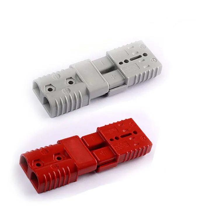

I think it might be worth it for you to get some polarised connectors so that you can't screw them up. I used to be a fan of XT90s because they were small and difficult to screw up, but I've lately taken to Anderson SB50s:
here: https://www.aliexpress.com/item/10pcs-6 ... 85105.html?
10 pieces for $15 including shipping. 10 pieces make 5 connections.
They are larger than XT90s, but mostly that's a good thing. They are easier to assemble and disassemble. You can see the + and - are embossed on them very clearly, so when soldering, it's harder to mess up, and there's a bolt through the centre you can use to fix it to something firm, so you only have to hold one side when connecting them.

My first recommendation to change everything to SB50s still stands:
1. They are big enough that your fingers don't need to be near the contact point.
2. The contactors don't touch until after the the plastic is fully over them, meaning any arcing is completely contained.
3. The contactors from the back end, finish pretty deep inside the casing, preventing any arcing from that direction, or accidental contact. Unlike poorly assembled XT90s (See the exposed rear contacts at the back. Most people heatshrink over them, but it's still possible for a soldering iron to melt through the heat shrink to cause a spark during assemblyImage
Short of a spark suppressing connector which generally aren't factory made to the size required for eBikes, the Anderson SB range is as good as you're going to get.
If you don't want to rewire stuff and just want to use adaptors, I think you're still going to be prone to error.

Sure.
By the way, if you are totally solder free, but still want to do a polarity protected connector, you can buy premade leads like this:
And connect them to whatever you need using Terminal Blocks:
No soldering, solid connections, you can update them if you want. Terminal blocks are usually only a few cents each, but pigtail leads are a couple bucks more than just the raw connector, as you might expect.
Still pretty cheap insurance against another mistake.

We all are different. I like these EC3 and EC5 connections. You like Anderson power poles.
If or When I build a Death Bike with the FX - 75-5 motor I will take a hard long look at the Power poles as I will be dealing with voltage over 100 volts. For now though I feel that the EC3 and EC5 connections to be superior to bullets and XT connecters.
HOWEVER. The mistake I made that cooked 20 LG cells and a BMS is the SAME mistake I made with the SONA packs many times over. That was using wire nuts and SEPERATING the wires coming from the pack. It was the Physical separation of the positive and negative that was the cause of error. NOT the type of plug I used.
Here I was thinking you were learning, but it seems you have just adopted a few better practices without learning or being willing to think it out.
I did learn something by going thru all of this. And has little to do with what type of connecter I use.
1. DO NOT EVER separate the positive and negative when using bullets. XT60 and XT90 plugs will work but EC3 and EC5 plugs are better.
2. NEVER go cheap when purchasing a BMS. Go for quality and what has been proven to work. If I spent a few extra bucks on those BMSs when assembling those LG packs I would still have a functioning 4P pack.
The problem was the taped up bullet wires coming from the kill switch and the fuse and controller looked just like the taped up bullets coming from the SONA packs and LG packs. The two battery wires coming from the SONA packs and the Samsung packs are taped at the ends so that it is NOT possible to physically plug them togeather therefore not repeating the mistake.
They say every cloud has a silver lining. I have learned the importance of a quality BMS like the ones in the SONA packs and when they die someday will look at it and see who makes it.
Also when I start building packs again I will take you and DAs advice and anyone here who has built packs as to which BMS to get. I never liked the BMSs that I bought for the LG packs as there was a seperate charging wire where the SONA packs as well as the Samsung packs the charger hooks to the same wires as the controller.
I did not like the extra wire as when hooking them in parallel to packs that do not have that extra wire I would need to charge them seperate. That now brings me to my question of the day.

Any polarised connectors are fine. XT?? EC? SB?? Even polarised and joined bullets are fine. Hell, XT90s are nothing more than 4mm bullets in a housing. Looks like EC3 may be the same. The only thing that's not fine are unpolarised bullets. That means either separating them as you did, or introducing reversed polarity joined ones, as you sounded like you were going to do.
I just like the Anderson SB50s, because they are very easy to make - with or without a soldering iron, they are big enough that you don't fumble with them, they are designed to be bolted down to something solid, and the arc is fully shielded.
