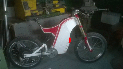

new design nearly ready for production
Post by dustyearlobe » Sep 09 2014 2:09pm
Bogg runner ebike,s and frames selling soon

Re: new design nearly ready for production
Post by Drunkskunk » Sep 09 2014 3:04pm
Cool. Details?
And from the pics it looks like if the front wheel ever went to it's full compressed position, it would impact the frame in that area that might be a controller housing?
Post by docnjoj » Sep 09 2014 3:11pm
I'm guessing that any good engineer would test that fork at full compression. Maybe?
Post by GiantEV » Sep 09 2014 3:47pm
What size wheels?
How do you access the battery compartment?
Post by dustyearlobe » Sep 09 2014 4:28pm
HI ,Wheels are 24"x3" with 3" tyres i was going to go for 2.5" rims but i wanted to max these but for full builds 2.5" rims would be used as i can only fit a 5 speed on the back ,but 3" could be an option,the wider rims reduce any tyer side movment.the front wheel has good clearance ,i will show this later ,battery cover is a one bolt fitting that also covers the controller mounting plate ,it is the front molding behind the front wheel ,just need to turn the wheel one side or other ,this frame is allowing for 8ah nano tecs ,opening for batterrys is 350x110 total space to be 350x110x220 on this one,got the battery space close to the ground as possible,not alot going on above wheel hight, will be offering fat frame also, 350x150x220 opening 350x150 ,will add more info later as still got some stuff to finish ,jigs all done ,but production time aint going to be super quick at present ,spare time only (evn and weekends )any one thinking they may like one (be one of the first)need to talk to Matt (idontwanttopeddal)or Pm me.we may have a couple of early bird speacials..
best regards Gary
ahh forgot to mention 135 or 150 drop out
Post by Hillhater » Sep 09 2014 6:40pm
dustyearlobe wrote:...
Drunkskunk wrote:Cool. Details?
:shock: Seriously ?
Post by mlt34 » Sep 10 2014 1:30am
:shock: Seriously ?
I think he means you turn the wheel one side or the other to access and remove the panel. Not that you need to turn the wheel if you think you're about to hit full compression on the fork :lol:
Post by dogman dan » Sep 10 2014 6:33am
Better be. Where I ride, you'd compress that fork to the stops.
I see a lot of bikes looking like that, battery or a controller on the downtube. They always look too tight to me. But I haven't heard the gone to the hospital story from any of them.
BTW, start another thread to sell these, in for sale new.
Prices, location, etc.
Post by Drunkskunk » Sep 10 2014 10:12am
This is how I see your frame:
Also, at full compression, your crank would hit the ground if the rear wheel has nearly as much travel as the front. The crash that would cause would be almost as disastrous as the front wheel jamming on the frame.
Monster Bike:http://endless-sphere.com/forums/viewto ... =6&t=38667
Post by mlt34 » Sep 10 2014 11:00am
Drunkskunk wrote:This is how I see your frame:
Cool GIF to illustrate it, but the picture isn't exactly orthogonal so it's not quite a fair simulation.
Post by dustyearlobe » Sep 10 2014 12:07pm
Not a problem
There is about 15mm clear at the front ,remember they are 3x24 with big nobbys ,maybe another 50mm would give some harsh contact, but i still think it would just be a rub than a stop.
Wouldnt like to find out thou .There is at full compression front and rear 70mm clearance on the chainring
Post by amberwolf » Sep 10 2014 2:24pm
dustyearlobe wrote:There is at full compression front and rear 70mm clearance on the chainring
On the chainring, or the cranks/pedals?
What happens if someone tries to stand for a big bump and one of the pedals goes down below the chainring, and the suspension bottoms out? :shock:
Reason: removed invalid portion of post
dustyearlobe   100 W
Posts: 250
Joined: Feb 28 2012 4:29pm
Post by dustyearlobe » Sep 10 2014 2:53pm
You Mean like this and he has not hit full travel on the front yet ,well all i can say is mistakes when riding will end up hurting ,but unless you want to stand on pedals 17" from the floor to avoid this (this would make it uncomfortable and no DH Bikes i have ever seen compromise this on a" It could happen")regards Gary
Post by peters » Sep 11 2014 12:30am
Interesting design, I like the curved plates, it is much better in distributing the stress than the sharp welded corners (and I have a design similar from this point of view :) ).
Can you show a photo of the other side?
How much does the frame weigh?
Does it have concentric pivot-BB axle?

Post by peters » Sep 11 2014 12:50am
That is with every downhill bike: 200mm travel(front & rear) + 170mm crank length + cca.30/2mm pedal height/2 = 385mm should be the min. unloaded BB height, rather above 400mm if you want some clearance to the ground - this is quite impracticable and uncomfortable, DH bikes usually have around 350mm.
Fully pressed front and rear suspensions at the same time are not likely to happen, and cranks must be horizontal when you bottom out.
Post by dogman dan » Sep 11 2014 6:49am
Chances are, hitting a downhill hole hard enough to fully compress the fork is going to launch you over the bars anyway. The forks I have compressed to the stop were not badass forks, but 100 mm cheapies. Chances are, you wont hit the stop on that fork ever.
But do consider what happens when some doofus puts a cheap fork on it, while his good one is being repaired. Or, simply what happens if his fork leaks, and drops to the stop. Can he ride it home still? Sounds like a yes.
After a few bent cranks, you do lean to stop landing jumps with one pedal down.
Post by dustyearlobe » Sep 11 2014 3:14pm
Pedals ,has to have Pedals ,i have pedaled this around in the first and second ,but remember its not a motor bike ,it has no filler cap on the tank ,and when all other options have failed you can pedal home ,if you want to.That reminds me again iv a charity bike ride for the local church's this saturday, magic ,they know all about my electric addiction so ebiking its not an option :roll:
As for the cranks,yes bb hight always an issuse ,my cyclone build was built with 26" wheels and big tyres ,and yes had crank clearance built into the desighn .
This was like riding a horse (i have/can ride) when standing the pedals and the seat height had to be raised to get comfortable,hence the change to 24" still to high but better .
There the plot ends at the bare min it is now (70mm clear on the chainring /170mm cranks/200mm on the chainring/Peters already done the maths on that one)this is not allowing for tyre compresion and or a total diffrent set up ,pretty sure Dogman brought this up ,pretty sure if my dad had taught me to ride a bike ,he would have forgot to tell me how to land a jump as well,ahh personal issues saves on syc bills
Post by teklektik » Sep 11 2014 3:53pm
Modbikemax wrote:I am wondering why the pedals at all?
Dunno about Oz, but no pedals = illegal in my state in the US.
Easy to switch to pegs - tough to add working pedals....

Post by dustyearlobe » Sep 11 2014 3:59pm
Somone could make some pegs that bolt on to the bb like cranks but dont rotate ,should be simple

Post by amberwolf » Sep 11 2014 4:53pm
It's pretty easy to turn cranks into pegs, by just unbolting the cranks from the BB, then bolting BMX axle-pegs in their place. ;)
As pointed out, its' tough to do it the other way round though. :P
