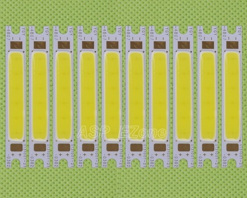

I'm sticking leds to mirrors and getting a nice pattern. Good clean cut-off and what went up now goes down. It's not going to be improved upon by tir's or anything else fancy. It's just what the doctor ordered. Ultimately, a bit of mirror from a disco ball might be all a lot of these lights need to make them right.
Clever solution. The flat led XL-M emitters have a focusing lens built/molded right on them. They seem to be focused :P on high bay lighting apps. With all the transport applications, I would be surprised if they did not have some road specific (low/ wide/ half circle) focus lens chips that are available or maybe in the works. If not, a high temp injection molded / plated reflector would do it. Any optics folks out in the group?
Looking up high end chips, I found a 77 volt capable chip, the larger cxa. http://www.cree.com/LED-Components-and- ... -pages/CXA The cxa2590 looks like it will run right off a 18s pack. 10,000 + lumens :shock:

On the reflectors, heat should be little concern on these sub 10 watt led chips. First surface Plated plastic flash light stuff should be perfect at this power level. The chips molded on lens look to be molded in a super hard silicone (plastic/rubber) material that is a type of high temp / high hardness plastic that is normally used to coat eyeglass lenses. They claim very high efficiency with it. Would not want to mess with the surface finish as it would impart some serious loss in efficiency if you can not polish it back to spec.
The CXA chips look very interesting. http://www.ebay.com/itm/221453210586?_t ... EBIDX%3AIT You should be able to run them right off a 36 volt pack setup. Imagine you would need to limit current some way to 0.3 amps via a simple circuit /supply. Look to be very efficient.

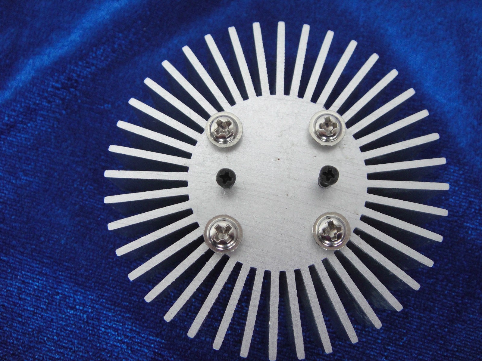

Not so sure. Cooked a XM L2 the other day running a single 18650 cell at 2.5 amps with no heat sink. Just over heated and burnt out after about ...5 minutes? maybe less It was on a bare 10mm MCPCB star

The chips need to be anchored down with thermal paste to a heat sink for certain or they will burn out if you put the juice to them. They run hot. The reflectors separated by a tiny air gap if using anything other than high temp plastic. Glass/metal is best if up tight and pushing near the current limit!

Exactly, they need a heat sink thst is my point, but your bit that I quoted, as I understood what you were saying was that just the pladtic or glass reflector was wnough.
Even if youu use thermal paste to stick an LED star to a plastic reglector or a glass mirror, to my mind that is as good as no heat sink. Maybe thete are some types of glass or plastic that are good thermal conductors? but I bet none as good as a block or plate of copper or orher metal.

I opened up an ebay 5w and measured 65c after a while. It has a plastic reflector but they keep it away from the emitter. I can see it reaching 80c at the most. Certainly if I start making something from scratch I could melt acrylic. I want to modify an existing torch though really. So heat should already be taken care of.

These 10w chips need cooling / heat-sink if you want to run them at the higher range of their specs. Some off of ebay below. Thermal grease between the chips and them will help also. Polished metal foil is your best bet for reflectors if your not able to cool them down enough if sealed up to keep water out. Some plastics will take the heat such as polyimide or peek and lots of ready made ones also listed on ebay that are cheap enough to play around with a bunch of ideas. A interesting time in lighting. Image Image
