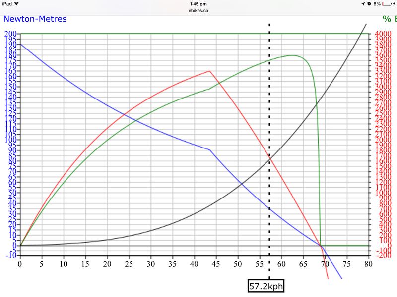

So 66v @ 60amps today near 4kw feels good in this 5T , punched a few trails and open paddocks at speed, climbs hard :)
Dam I need some bigger forks though, flex and travel are an issue. I'm now looking for some down hill forks if anyone's got some suggestions at a reasonable price.

Anyone got any ideas on why I have to run my controller in reverse and set the phase wise like such, I've tried every other combo. It's weird, phase wires are all good. I want to solder them up later on and get it sorted.
