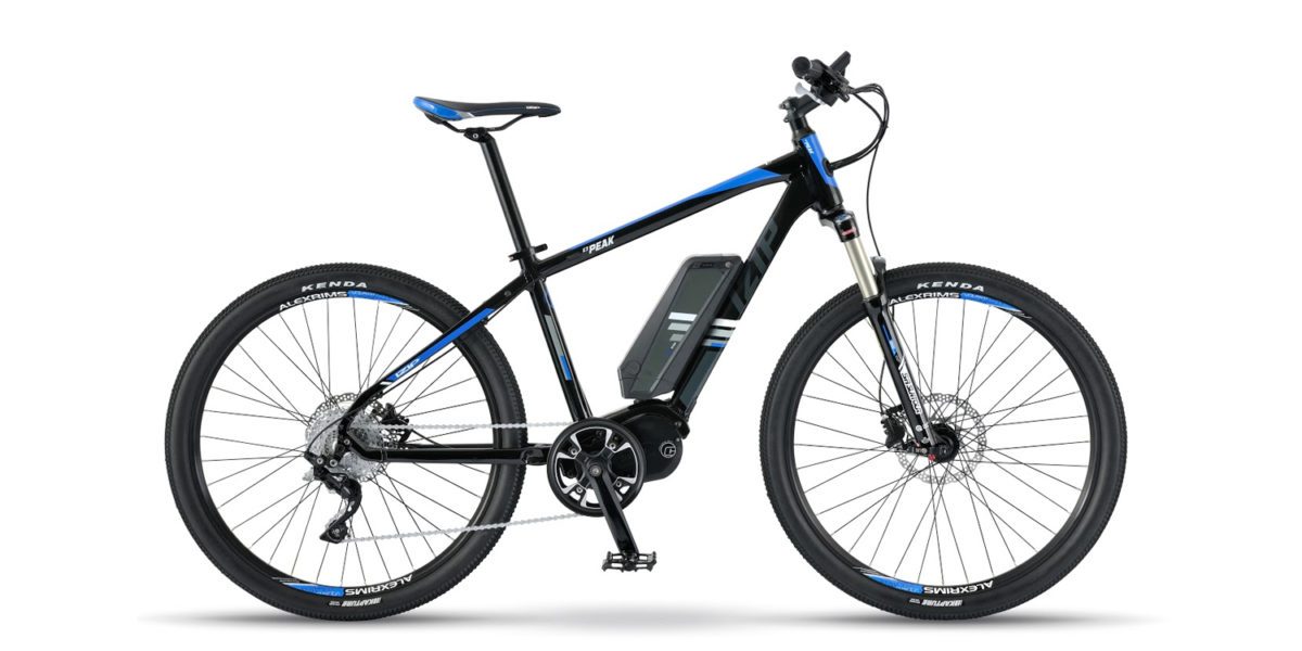

Hi guys,
My workplace may need to soon grow its fleet of ebikes. I'm researching models and have yet to find time to go and visit any of the local retailers.
The kind of urban bike we have currently is excellent. It's got a nice headlight, indicators, back tray, tops pania bags, comfy to ride. 7 speed Shimano gears. I really like the twist throttle just like a motorbike. While these bikes were made in Australia and are excellent, apparently we recently had to get rid of two because they had some kind of design flaw that meant just plugging the power cord in while the wall switch was on damaged the batteries!
I'd like to get some more with at least these features but want to trial new models. We have lots of different types of riders (around a thousand staff) and there are a lot off gravel and bush trails that our current urban model perhaps isn't suitable for.
A mountain bike with regenerative brakes would be great, as I ran out of batteries the other day and want to maximize batt life as much as possible...
Obviously as these are for multiple users at work I'm after something robust that is easily servicable and tough...
Any suggestions of makes and models would be hugely appreciated, as I know very little about ebikes.

The problem with ready made bikes is the cost compared to what you could build. A simple build consisting of the "perfect" bike with a good ebike kit will be much more adapted to your needs but you will need a mechanic to assemble and maintain the bikes.
If you insist of having a built ebike, I suggest haibike or felt with the mid drive. They make excellent mountain and commuter bikes with the Bosch mid drive system.

i would skip the regen, not worth it imo, the power you get back is minute, and it stresses the battery.
even better, a bigger battery and run a 20 - 80% soc - run a 15 ah instead of a 12.
battery life will be better. :-)

I talked to an electric bike shop owner just yesterday, and they have had a pleasant experience renting motiv brand ebikes to tourists. Just an option to consider.
Edit: when you say "work fleet" what kind of ebike work do you mean? The type of work can affect appropriate suggestions...

The bikes are encouraged to be used for recreation as well and work functions. This might involve long rides up several of the mountains around here as well and on and off the large number of bike paths in this city.
The one thing that puts me off all the electric mountain bikes I've looked at is the lack of a back tray. While I appreciate it's not something you generally want on a hardcore mountain bike, it would be useful to get more bikes with good back trays and capability to mount a couple of pania bags in addition to having regen brakes and good off road strength.
Canberra was designed for cars so long rides can required, hence the desire for regenerative brakes. Anything to extend the duration of a charge would be great.

If you wanted something more aggressive for off-road you could always put a rack on this: (years ago, I thought I wanted a enduro motorcycle for both off and on road, but I was on-road more than off, so I just had a really high vibration bike that wasn't well suited to what I did most of the time, and it rattled it's self to the point of cracking the frame in several places, point is, a bike should match what you do MOST of the time, try to do everything, and you will end up often with too many compromises and less practicality)
https://electricbikereview.com/izip/e3-peak/
Another hard-tail yes, but again, KISS principal, less moving parts = less maintenance, parts to service, replace, etc.
*** Discalaimer *** you might have noticed I have posted mostly Izip models, a few years ago I would NEVER have recommended Izip as I didn't like their build quality or lack there of, these days, they seem to have really stepped up in the quality department, and are one of if not the longest Ebike running companies still going, AND they have a very good price point, you will typically spend more in the $7,000+ range to get many of the standard features of these bikes, just my "Humble Opinion" I have not owned one, but from all my researching online of reviews and such, the 2015+ models of IZIP are the best bang for the buck for a "turn key" bike I have seen yet since I got started in this E-Bike thing about 9 yrs ago.
