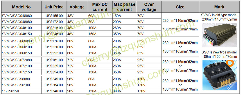

999zip999 wrote:Go 72v 40-60 amp controller. What controller do you have now. What battery ? Little more info.
Got a 54V40AH battery with 48V35A sine wave controller from bmsbattery. I've been considering upgrading controller for a long time but I haven't found any decent sine wave at decent price.
Key requirement is to have a controller that is:
- Sine wave (I can't stand the noise of square wave)
- Have regen braking
- Decent price (Adaptto is a bit over the roof)
Can't find anything yet.
Help me find my stolen electric brompton: http://bit.ly/1a0vbBC and Bosch Sinus B3 http://bit.ly/1eV0WQz

thank you. i've read the thread but can't find out answer about regen. the spec says it has abs regen but i don't know how good it is if it's not variable? i'd like to use regen as my main braking method and i don't know if without variable if that's good enough.
i'm hesitating with sabvoton that are about the same price:
but much heavier,bigger. however it has variable regen and foc

Got to 24s with a 40A controller and you'll top out at 45mph with your motor and can run at least 20 miles at 40mph without over heating it. You'll meed a minimum of 1.4kwh to get 20 miles. 2kwh would be better. Or figure 75wh per mile. Accelleration should be almost twice as fast as it is now with 14s. This controller should work fine. If you ride it hard, you might want a 60A 18 fet, but it only takes 40A for top speed.
http://www.aliexpress.com/store/product ... 95185.html

I was thinking to put on it:
- QS 205 3000W motor on moped rims & tyres
- Sabvoton 72V 150A
- Front suspension 100mm
So it would accelerate fast, reach 45mph and be able to carry passenger? Shall I pay or is it a shit idea?
