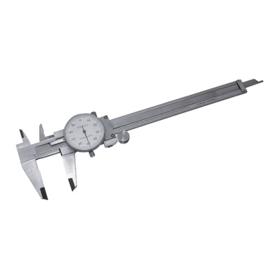

There are a number of ways to do it. To do it right you need a flat file. A round file, a sharpie, some paper, scissors, and some way to measure precisely. a dial caliper like this is best:http://www.ebay.com/itm/like/3907477414 ... ps&lpid=82
First, trace out and cut out a template for your dropout 10mm wide on some stiff paper. Test it to make sure it fits on the motor's axle. The flat sections need to be square with the axle flats, the round section needs to meet the curve of the axle. A close fit is important. It's more important for the fit to be close than it is to be exactly 10mm, so adjust as needed. Use this as your template. Place it on the bike frame around the dropout and use the sharpie to color in everything that is exposed around your dropout. You will need to remove some material in the curved part of the dropout too.
Carefully and slowly start with the flat file. place it in the drop out and with slow strokes, file down each side. try to keep the file flat and moving in flat strokes to avoid rounding out the dropout. after 60 seconds of filing, check your progress with the caliper. When you reach 10mm, start on the rounded portion of the dropout. this needs to be a uniform shape or else the axle won't fully seat in the dropout. Repeat the process for the opposite side.
The secret to success is going slow and measuring often.
