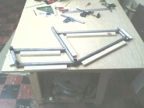

Here's how I tack welded the frame tubes. I made a drawing of the frame on a piece of 3/4" plywood, then screwed on straight boards to clamp the tubes against. Bored holes in the plywood in 3 places for the hubs. I used round & half round files to fit up and weld the tubes one at a time. Now I need to complete the welding.

One nice thing about your design, a lot of it will lay flat on the jig. Should come out nice and straight.

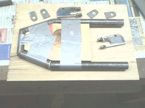

I finished welding the frame, then assembled it with the swing arm and rear springs. I had been working on the spring assemblies prior to starting the frame so I just had to make some adjustments. The springs are swing springs that I got at a hardware store, they should work well here.

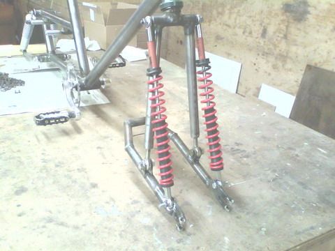

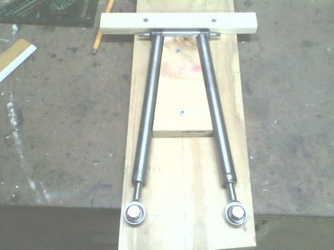

More photos for your amusement. This is how I fixtured the fork & front swing arm for welding. It takes a lot of time to make those little parts with a hack saw and files.

Wheazel-- I watched the video that you linked and can see that's an excellent technique. I do have an angle grinder, but for me hand work is also a good way. The main tubes are 1.25" dia by .035 wall 4130, very thin walls and easy to file. The radius of the file I used for fishmouthing made a perfect match. The drop outs and clevis tabs took more effort than fishmouthing the tubes.
Here's how the front suspension is looking. I am now working on adapting an old derailleur to work as a chain tensioner.

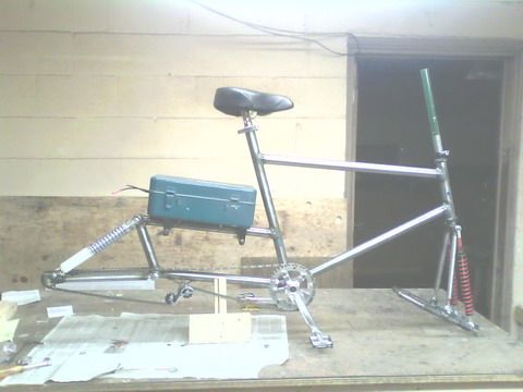

I managed to get part of an old derailleur mounted to serve as a chain tensioner. This will account for changes due to swing arm movements. I aligned it to minimize excess chain slack because I plan to use a 3 spd hub with coaster brake. As shown it only takes about 10 deg of back pedal to take the slack out of the chain, so it should work. I am concerned that the tensioner won't be strong enough to stand on the pedal in the back direction. I will give that a good test when I get the wheel installed. It will also have a front disc brake.
The photo shows the battery pack from my recumbent. I will be able to use this battery, but might eventually make a slightly narrower pack just for this bike.
Now that I got something real to look at I am rethinking ways to do the rear rack. I may be stuck for a few days while making some trial parts.

What if you dropped the battery one bar down and tilt it on its side?
Chain still in the way, or will it clear?

The battery pack in the photo is about 6.5 inch wide so it causes a small problem. If you notice in the photo, I removed a handle and the front latch from the battery box because the heal of my shoe can catch as I pedal. Removing that latch might be a good enough fix. I won't know until I can actually get it out for a ride and that's not happening for awhile.

Seems a bit of a shame to waste all the nice real estate in the triangle. But it is long wheel base so probably will ride well even if you don't use triangle.
Can I ask, what made you choose that particular fork? Never seen one of those before. Have you ridden bikes with forks like that before? Wonder how it handles? Sure will be a cool looking bike, looking forward to see it completed. It will stand out.

The recumbent bike in my avatar has has a similar front suspension and it works great. Because there is no sliding action the friction is very low which helps the suspension respond to bumps.
I also wanted to use a spring that I had.I made those 2 red springs by cutting one long spring in half and closing and grinding the cut ends. Each spring has 13.5 coils, a wire diameter of .170" and a coil diameter of .970". From that I can calculate that each spring has a rate of 97 lbs per inch. So it takes 97 pounds to compress the spring one inch. I also designed the fork so the ratio of the leverage from the wheel to the pivot point versus the leverage from the spring to the pivot point is 1.3:1. From this I can calculate that it takes about 115 pounds to displace the wheel one inch. I estimate that the static weight on the front wheel is about 90 pounds. That's the condensed story, I actually built up a spread sheet to try many combinations.

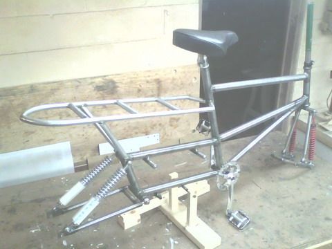

When I started this thread I asked for suggestions and got some good ones and made some changes. But, there was one aspect of the change that I never liked. In the original design the rear rack also served as a primary structure from the seat down to the rear axle. After moving the battery there was no longer a direct load path from seat/top tube junction to the rear axle. So here's a current photo. I added a tube within the main triangle to improve the frames structure. Maybe it was not needed, but it's a homemade bike and I'd rather be too strong than too light.
Since the rack is no longer needed for structure I made it from cheap electrical conduit. I spun the pieces of conduit in the lathe and sanded off the plating before welding.

Post by Chalo » Feb 15, 2016 4:05 pm
Your frame still lacks bracing behind the seat tube. Maybe the tubes have enough beef to be loaded as beams, but that's less than ideal in any case
