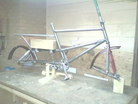

It's been slow going since I last posted. The battery box from my recumbent was about a 1/2 inch too wide to freely clear my heals so I made a thinner wood box which will eventually also fit the recumbent. Then I also made a smaller wood box for the controller. I didn't like the derailleur I was using for chain tension so I made a new one from scratch, it took 4 tries before I got one that worked. Also added a bottle bracket.
Then I got fenders from ebay and mounted them, but they will need more work when I get wheels. The rear fender is mounted to the swing arm so it will fit close to the wheel. I didn't leave enough room between the fork legs for the fender to ride up and down between them so the front fender is mounted to the fork with lots of wheel clearance for suspension travel. Here's what it looks like now.

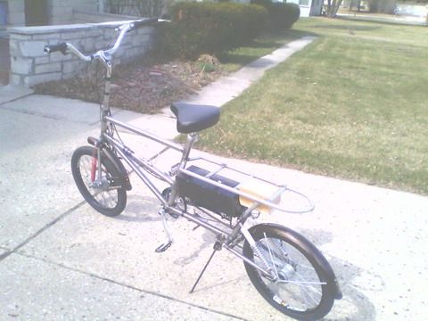

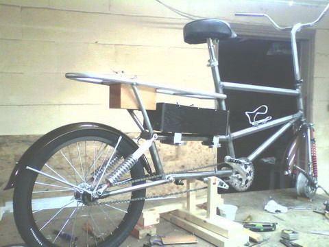

It rained a few days ago and washed the road salt away and then warmed up a bit. So, I got my recumbent bike out and dismantled the bike I had been riding for the winter. I laced the rear 3 speed hub into a 20" rim and, put on the handle bars and seat. I don't have spokes yet for the front hub motor. Here's how it looks now.

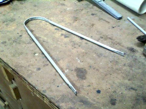

With the rear wheel in place and because I was warned about their importance, I made 2 new fender stays. I made them from 1/4 inch brake line tube. Flattened the middle and ends, bent it around a tube, and drilled some holes.
I didn't take photos of the battery, The box is built for 10s 15p 18650 cells. As it is now it is 10s12p with some wood blocks holding places for future additions. At the bottom of the page of the following link shows how I made an 8s7p battery, I used the same approach for this one.

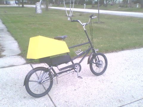

It's about as done as a homemade bike ever get's done. A new properly adjusted headset corrected the heavy steering. I gave it a really ugly flat black brushed paint job. I've ridden it over 80 miles with no problems, just a few rattles that need attention. So now I am starting on a big box to put on the rack. I am happy with how it performs, but it's not going to get any prettier.
Re: Building a compact cargo bike
What's a cargo bike without a big ugly box. There are 4 nuts welded to the rack so this box can be added or removed in about 2 minutes. The plan is to build other cargo attachments, say a structure that can carry 2 grocery bags pannier style.
