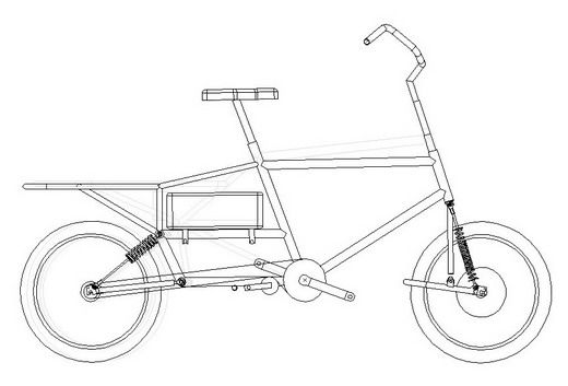

I recently started seriously thinking about building a small cargo bike, mostly because of what I've seen on this forum. So I've been working on a design for a few weeks and thought before I get far into building I would post and see if anyone finds any major flaws. Here is a 3D CAD image and a 2D CAD drawing with some dimensions. I will be building soon and will post my slow progress.
I have built bikes before, but I am far from an expert at knowing the intricacies of bicycle design. This will have 20 inch wheels and a low powered front hub with top speed around 18 mph.

Nice design!
You'll have a much smoother ride if you move the pivot points. On the rear, you can move that pivot point all the way up near the crank. Long arm suspensions ride much smoother since the angle of the motor changes much less through the same amount of suspension travel. Same idea in the front, if you move the pivot point back, you can get a much smoother ride.
I'm curious about why you chose a dual shock setup front and rear?

Those are good suggestions. I make the swing arm stays from 3/4 tubes. I weld plugs in the pivot end and then drill & tap them on an old lathe. The lathe can take up to 3/4 dia thru the spindle so that limits the tube size. If I made the swing arm longer then it woul reduce it's torsional stifness, so that is why I don't want to make it longer. Also I ride roads and paved bike trails so I don't need long suspension travel. There will be stops to limit wheel travel to 2.0 inch and it will have a fairly stiff springs so it seldom bottoms out.
I would prefer longer swing arm length on the front. I made compromises to get the spring leverage to wheel leverage so I could use springs that I have and get the spring rates that I wanted.
The battery box shown is 5.6" wide by 4.1" high by 15.3" long and can be built up with 10s15p 18650 cells
I have a similar leading link front suspension on my recumbent and it works great. Conventional is not always superior.

I really like the front fork. For a front hub motor, that's a great idea. I think it solves the weakness of the Monarch Springer design with that lower hoop. If it works out, you might have a marketable front suspension for hub motors.

The cargo rack is a little higher than it strictly needs to be, lower would be a bit better.
With that high top tube getting on and off with the rack loaded where you can't swing your leg over it is going to be a bit awkward depending on how old/agile you are. A mixte type of frame in the front would give you a lower top tube.
Like your front suspension design and the frame generally looks pretty stiff for predictable handling.

Thanks for the comments, they are helpful. I originally planned on just having a carrying rack with the option of setting a box on it, that's why it's so wide. But maybe paniers would would be a good idea, I will consider making the rack as narrow as the battery. And maybe the top tube is a bit too high, I will look into that.
The cargo rack is 26" from gound, I need room for suspension travel and a fender, I will take another look at that too.
The drawing shows the trail being 2.92", I thought I might get a comment or recommendation on trail. It seems too much to me, but that's about what I use on recumbents with good results.

Long with a lot of trail and not too much steering axis inclination will make it stable which is a good thing for a cargo bike particularly when you are loaded.
What I've noticed playing around with different bikes and motorcycles over the years is that the inclination of the steering axis tends to affect low speed stability the most and the trail is more about high speed stability.

I think in general, it's a really good design. I might mount the rear shocks a tad more vertically, but other wise it mostly looks real good.
since I greatly prefer a rear motor now, I'd make it rear motor drive. And then use a regular front shock. I'd shorten the headset tube to the same 5" or so length common on MTB's to allow more shock choices. This will also lower the top bar some in the process.
Carry the first battery in the triangle, still plenty of room for a nice triangle bag or box. Then the second battery if needed in the rear trunk.
My last two longtails have been no rear shocks. One has no shocks at all. This works fine with a long enough bike. The shorter the bike, the more it will need that rear shock. Similarly, the heavier you load it, the more it needs that rear shock.

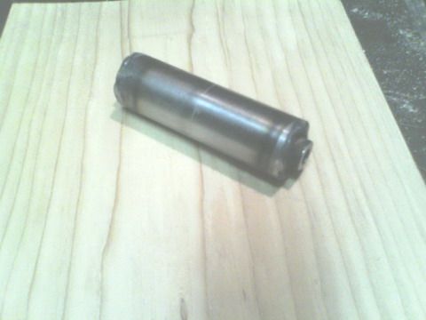

A few days ago I started making the rear swing arm. That comes first because I need the pivot hub before I can make the frame. I have also started making parts for the spring assemblies. But most of my time is spent making design chamges to the frame. Your comments are making me reconsider and it will take some time to get things worked out. Here's some photos of how I make a swing arm.
First I make a hub with bosses with 3/8 tapped holes in each end.

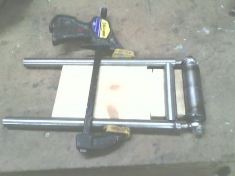

Them make chain stays with 3/8 tapped hole in one end and fit the tubes using a board to help with allignment for welding.

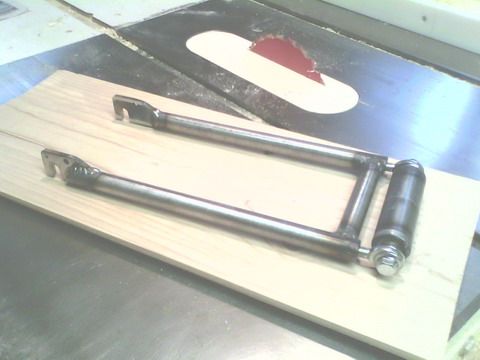

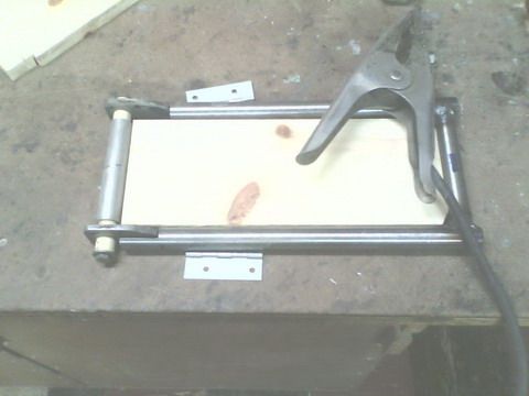

Then I make 3/16 thick drop outs and weld into notched tubes.
Kind of crude, but it works and its a start

Looking a lot better than I could do. Explain about how your pivot works. It almost looks to me like just some eyebolts pivoting on a bolt screwed into the center piece. Is it just that simple?
How does that get lubed? Is there a bushing in there or something I don't see? Cheap walmart bikes just pivot on a plastic bushing, no lube.

Dogman, those are called Heim Joints, some guys call them rod end bearings, I bet you've seen them before. It's like a small ball joint, these are cheap ones but they work well for this. You can get better ones that have grease fittings, but I just put a few drops of oil on them once or twice a year.

You guys had some good sugestions, here's a revised side view.
--I shortened the head tube and lowered the top tube, it improves the structure and looks better
--You don't see it in the side view, but the carrying rack is narrower for better use of paniers
--I decided to use the same battery as for my recumbent, it's a different shape so it loads from the side instead of the back
--I lengthed the wheelbase 1" in the back to make just enough space for the battery
The changes in the back have had a bad affect on frame strength. The original version had a straight line load path from the axle to intersect of seat and top tubes. Now the battery is right where there ought te be a strucural member. At some point I may add an additional strengthening tube.
