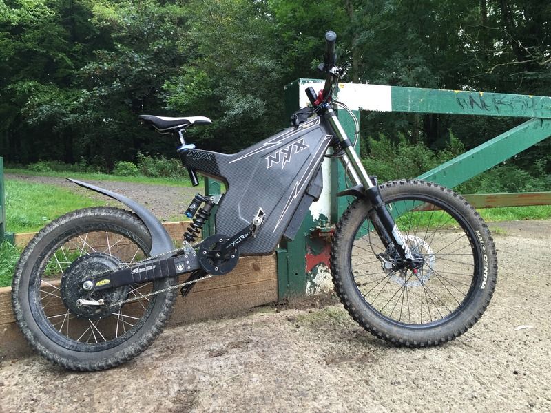

Post by brumbrum » Nov 12 2016 5:14am
Ham wrote:I'm just South of London: I put up a thread about a meet up but no responses as yet...viewtopic.php?f=25&t=84674
Hi Ham, i am 2 hours down the M4 motorway in Cardiff and ride off road only in hilly terrain here in Wales. You would be welcome to come and try my cromotor ride. 6-9kw or lower if you want. Fully adustable with my adaptto controller.

Post by Ham » Nov 12 2016 2:52pm
Andrew.
That Sir is a thing of beauty right there! I may very well take you up on that, time permitting...I'll obviously bring my Tangent ride and we can swap and compare...maybe a video too.
How heavy is your set up?

Post by MadRhino » Nov 12 2016 6:07pm
See, it didn't take long to find. ES is wonderfull.
That bike is pefect to ride the hills of Wales, even better fun than a Welsh pony I bet. :D

Post by brumbrum » Nov 13 2016 3:42am
MadRhino wrote:See, it didn't take long to find. ES is wonderfull.
Yes, but not as much fun as a welsh sheep :wink: :lol:
And to answer Ham's question, i have never actually weighed my bike. The battery is about 12-13kg, motor in 17" moto rim with 3" trials tyre is about 14kg, frame and swing arm is 6kg, So i am guessing about 40kg. I can pick it up and carry over obstacles when necessary, but its still a lump.

Post by MadRhino » Nov 13 2016 12:11pm
Up the Amps BrumBrum
At 40 Kg fed 9 Kw, I'd be close to call it a Welsh back cow :mrgreen:

Post by brumbrum » Nov 13 2016 1:53pm
MadRhino wrote:Up the Amps BrumBrum
Haaah, i can out run all but the fastest of welsh cows...
My peak amps are at 110 on multistar lipos. Which is a little less than 4C discharge on my 30ah pack. Thats enough for me with phase amps up at 350 on the Adaptto. The 4s 10ah multistars are good for Upto 3C continuous draw. The torque/thrust at this level is enough, you then need to adjust PWR timing for mid speed acceleration and then OVS timing for extra top speed.
I could put phase upto 395 and maybe a little higher for peak amps :wink: , the cro quickly settles at around 75 amps and then drops to about 50 or so on flat.

Post by Ham » Nov 13 2016 2:36pm
40kg is lighter than I was expecting...I'll bring the scales :)
