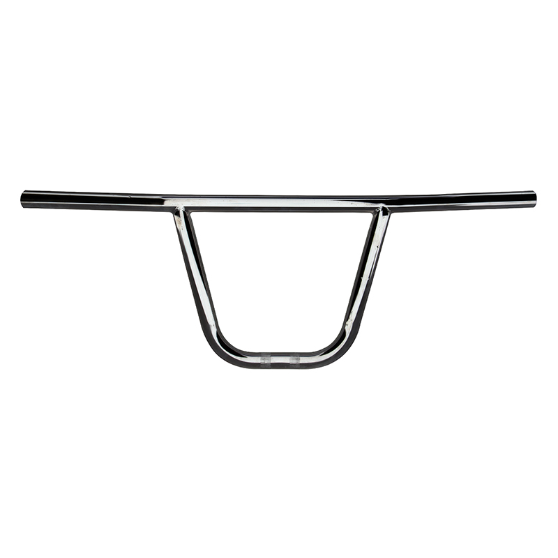

Shifter pods like yours make more room on the bars for the grips. Otherwise, a bar with a bend that close to the end might not have enough room for everything. However, the shifter will foul the bar when it's adjusted to some angles, and that can be inconvenient.
I tend to use a CW style bar when I want BMX rise but have to fit MTB controls on it. Because the grip section of the bar doesn't bend, it allows much more room to fit things.
The BMX bars for my lame little moped were leftovers in the garage. I'll try to make them work before I start throwing more money at it. Thanks for the idea, I may well have to go that route.
