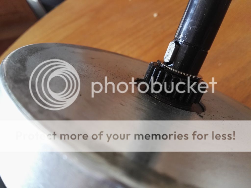

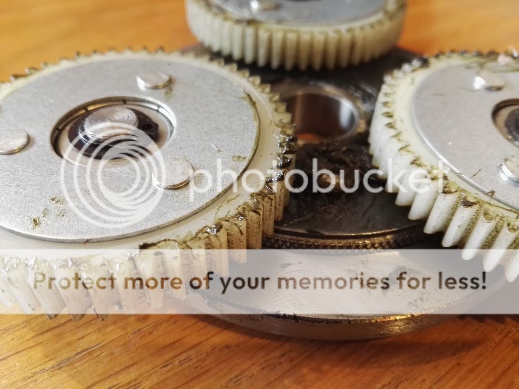

Post by mxer » Apr 30 2017 3:33am
Here's some pics of inside the motor.
My symptoms are, motor Will not turn the wheel under load ie wheel on the floor, I just get an internal motor spinning noise?.
If I lift the wheel of the ground and hand spin the wheel it will spin the wheel fine.
I'm thinking the clutch but as you can see from the pics there is no sign of wear? No swawf, metal fillings, nothing..
Can anyone tell from the photos the clutch has gone?..
I may replace it anyway as it was not my motor from new, does anyone know where I will get a clutch?

Post by nutnspecial » Apr 30 2017 3:55am
Mysterious! I've never had a geared hub, so I'd prob email that last post to em3ev support- they may have input and any pertinent parts.

Post by mxer » Apr 30 2017 4:04am
Indeed? I've tried to force the clutch in drive direction and it's red face tight?.
Strange?...I've messaged EMV3ev to see if they have the parts?..hopefully this is not going to stop the build.
Thanks nutspecial.
