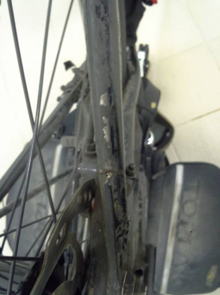

and the reason i'm doing (it's rather a long story) is in case the welding on my current custom steel frame which developed a crack for the second time on the chain stay ( custom because when i ordered i saw no 29ers at all with 68mm shells).

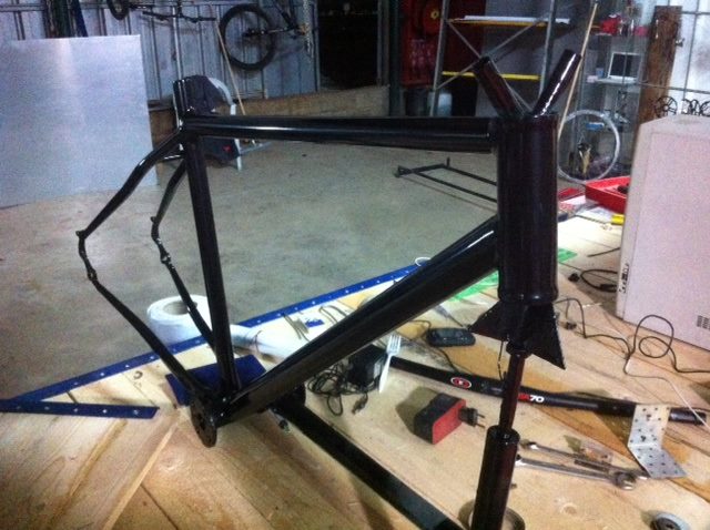

i was never really sure about the ride of alu vs steel, i have a trek 7700 with another gng with bust shaft bearing (which still works, but maks a horrible horrible sound) with a ridig fork , and that's hard to ride.
but i'm currently a fan of a frame that works
this is the original brake on the frame
and this is the 2n one
and this is before i messed it up :)
you can see the ritchey one is rather similar (except ritchey's is tripple butted and this one is not i believe, and this one is 42 mm down tube, richey's sould be 24), but look at what richey has on the brake side.

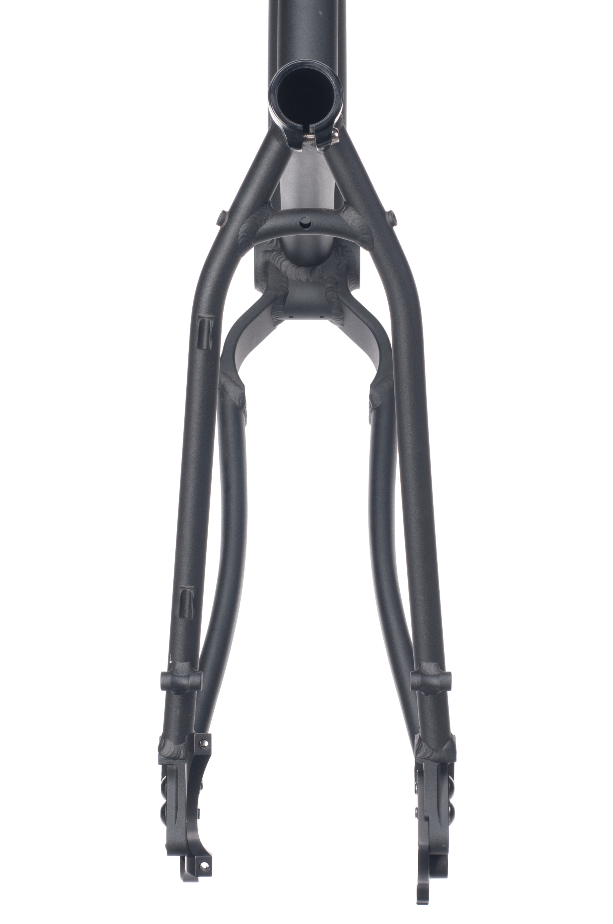

meanwhile i found this hardtail which looks nice: http://carverbikes.com/frames/aluminum-gnarvester/
btw i've noticed many frames include post on the chain stay exactly where my frame broke.
I can see by the tubing , and weight that it would be a strong frame.
" meanwhile i found this hardtail which looks nice: http://carverbikes.com/frames/aluminum-gnarvester/ "
It does have a tapered head tube, which is good, as it is getting harder every month to find a good suspension front fork with straight head tube steerer.
