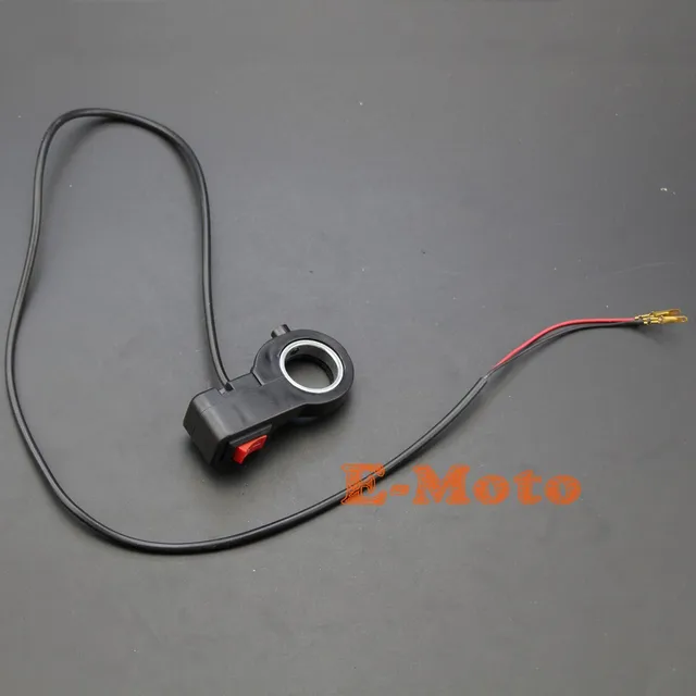

I recently got a new Phaserunner V2 that has extra wires in the throttle cable to allow one to set up a remote switch for turning on/off the Controller (and I an presuming also the motor and the Cycle Analyst attached to the controller).
The Phaserunner v2 manual says that "These two wires contain the full battery voltage" which in my case is 52v. I presume that its very low current though since its mainly a signal and the wire gauge is suitable only for signals.
It also says that you should use a "toggle" switch so I presume that it is definitely not a momentary switch and should be the equivalent of an SPST switch.
So I am looking for such a switch that I could easily mount somewhere, like maybe on a handlebar / T-Cycle cockpit arm. There seems to be many for motorcycles and such but they are all rated for 12V.
So my first question is: Are all my presumptions correct?
Second could I use a switch that is rated at 12v DC (and probably much more amps than I'm dealing with) for switching the 52vDC here?
Something like: https://www.amazon.com/dp/B0171G7BKC?th=1

rberger wrote: So my first question is: Are all my presumptions correct?
yes
rberger wrote:Second could I use a switch that is rated at 12v DC (and probably much more amps than I'm dealing with) for switching the 52vDC here?
12V switches used to turn on/off battery packs are somewhat of a crapshoot. I've found 12V-rated 15+A switches that work fine with a 14S battery pack whereas other switches rated the same immediately welded shut upon first application.
I know that doesn't answer your question but really, the only way to know for sure is by trying the switch in the application and seeing if it fails.

The controller wires you are describing are the same as the 'ignition' wires found in other controllers. These carry battery voltage but only supply a very small current for the processor and a bit of other electronics - something in the neighborhood of 50ma - plus the power for the CA (10ma) and any other accessories you have plugged in to the CA power port. Turning this off kills the processor power which renders the controller inoperable even though the main traction power is still 'on'.
Normally, arcing is not a material problem because of the low current and the switch you describe is certainly more than adequate. That said, the CA power port can supply up to an amp, so there is some possibility of arcing if you load the port and use a switch with really low current capacity.

Another option would be to use a simple snap-in rocker switch with a small electronics project box that your mount somewhere on your rig. The tricky part here is that most rocker switches are rated for vac, but I did find a handy conversion matrix for dc applications that is easy to understand.

AC rated switches sometimes do not have enough separation to interrupt the arc formed from a DC load. As contacts separate, an arc is formed until the dielectric strength of the air increases to a point that extinguishes t. With AC, the current passes through zero 120 times per second, which aids in extinguishing the arc quickly. With DC, it never passes through zero, so only the distance is used to extinguish it. If the distance is designed around switching of AC only, it may have amost no capacity to switch DC of any appreciable amount of current. As an example, I have used for AC contactors rated for 500A at 600VAC, but they are rated for only 0.4A at 24VDC. There is no guarantee that the switch you are using will function for very long.

That is cheap and mounts on the handlebar.
3$ shipped on aliexpress. They have them in many types and groups.

As a reality check. I have been using that switch (https://www.amazon.com/dp/B0171G7BKC?th=1) for switching the PhaseRunner remote on/off for a year now with no problems...
The Phaserunner switch on V1 or the remote switch on V2 only turns the Phaserunner CPU off and on. It doesn't disconnect the battery from the PR controller. So turning the PR switch off and on doesn't disconnect the Battery from the Controller so there are no issues there with pre-charge or in rush current.
