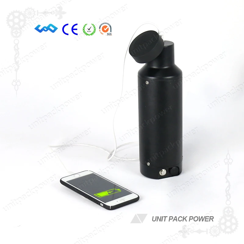

I bought a 10S-3P bottle battery from UPP this month. It arrived 10 days after the order, well packed, and with the requisite lithium battery shipping label needed in the USA. The battery seems well made, although I didn't pay enough attention to the specifications, so it's a big longer (110 cm) and heavier (4.4 pounds) than I expected, as I was looking at pictures of their 10S-2P batteries. Still it's pretty slim and looks good. I hope it stays in the cradle, but I could add something in front.
Here's their smaller version. My wife can ride for about an hour on a 10S-2P, so 10S-3P will work fine..
I won' t be able to give it a good run til after New Years.
Thanks for good comments.
