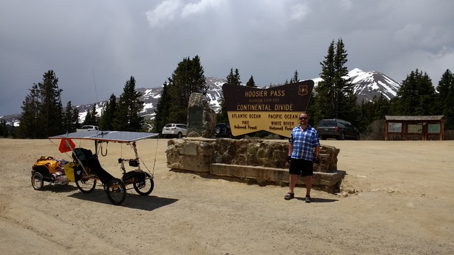

My "Heavy Solar" was stolen after my ride from Kansas to Utah. I am thinking about abasic rebuild. Fortunately the panels and charge controller were off the trike when it was stolen; so I have some of the expensive parts. For V.2 I am thinking of putting the panels on a trailer. I had a problem with them on top of the trike, it was a bit too top heavy. I will still have some sort of frame on top, if for no reason than to support a sunshade.
I am thinking of going with a KMX trike this time. First, it is cheaper. Second, I think the square tubing will be easier to attach things to. For my application I don't see much advantage to going with aluminum; however, that may be subject to change.
