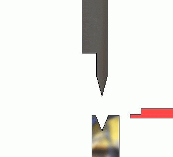

So how complex can a battery box be?
Maybe I just make trouble for myself here, but it would slide in and sit nicely in the frame then. Only need a removable lid on one side.
Sheet metal works do require some tools and equipment. Your box is not very complicated, but it does require some experience to make it neat.
Start by buying a Press brake
Or bend metal with some 2x4s and C-clamps.
To cut metal. I have had used a jig saw. Or email drawings to a Laser cutting shop.
Here is a fun place to play with drawings https://www.emachineshop.com/
What program do you use to draw battery box?
Ha ha, no wasn't thinking of bending it myself, but it seems complex to me. Anyone made any similar?
I would say that as illustrated it is extremely difficult if not impossible to fabricate with conventional tools (shear, box brake, plate roller). In the absence of a custom die to press the radiused parts, it would need to be partially wrangled by hand.
The biggest problem with your design is the inside radiused tube saddles that are part of the single large sheet that forms the entire box. In addition, although this aspect of the design looks cool and gives some mounting stability, it offers no increase in usable internal volume and probably requires some internal spacers to be fabricated so the battery rests on flat surfaces. So you have a design that doesn't buy much at the cost of being very difficult to make.
I think you need to go to YouTube and watch some videos on sheet metal fabrication so you understand the tools and techniques. Twenty minutes will be enlightening and will help you weigh design features vs fabrication difficulty.

Yes, that is what we call over-engineering to no use.

So this would be doable I think.

I used to make all kinds of sheet metal boxes, covers, and panels when I worked doing prototyping for a power electronics company. The key element I had to master was called "bend allowance", which is how much stretch across the metal's surface you get when you bend it. It varies by metal type, thickness, bend angle, and the specific adjustment of the brake (I used a manual finger brake). So I always had to set up my brake for the material I was going to use, and then bend a sample or two so I could measure the bend allowance. Only then could I cut my flat pattern after taking the bend allowance into account.
You can get the shape you want, but you can't just flatten your solid model and expect it to come out the same. There's more to it.
