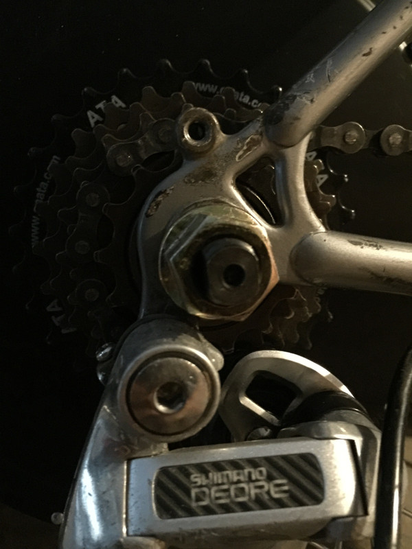

Post by 420b » Aug 18 2018 5:25pm
Thanks for the explanation folks. Here is my axle. Imageimage hosting services It’s not aluminum (99% sure) and it looks pretty tough. That said, I’d like to get some torque arms to make sure the worst doesn’t happen. There isn’t much of an online market for torque arms for bikes, so what would you guys recommend?

Re: Regenerative Braking, is it this easy!?
Post by wturber » Aug 18 2018 6:09pm
There are a gazillion ideas here: viewtopic.php?t=26444&start=15
The approach I (and many others) took should work pretty well with your dropouts. Just make sure that you make the hole for the axle nice and snug fitting. the tighter the fit, the better. And use two. One on each side.
Post by 420b » Aug 18 2018 7:11pm
wturber wrote:
Aug 18 2018 6:09pm
viewtopic.php?f=2&t=26444&start=175#p1315521
Those look clean. What tool did you use to make the hole for the axle?
Post by wturber » Aug 18 2018 9:36pm
420b wrote:
Aug 18 2018 7:11pm
I forget exactly. A drill press for sure. I think I drilled two holes and removes the remainder and got the final shape with hand files. I may have used a coping saw with a metal blade for some sections. The outside shape was done with a hand held electric grinder and hand files. Of couse, I sanded things as well before painting.
