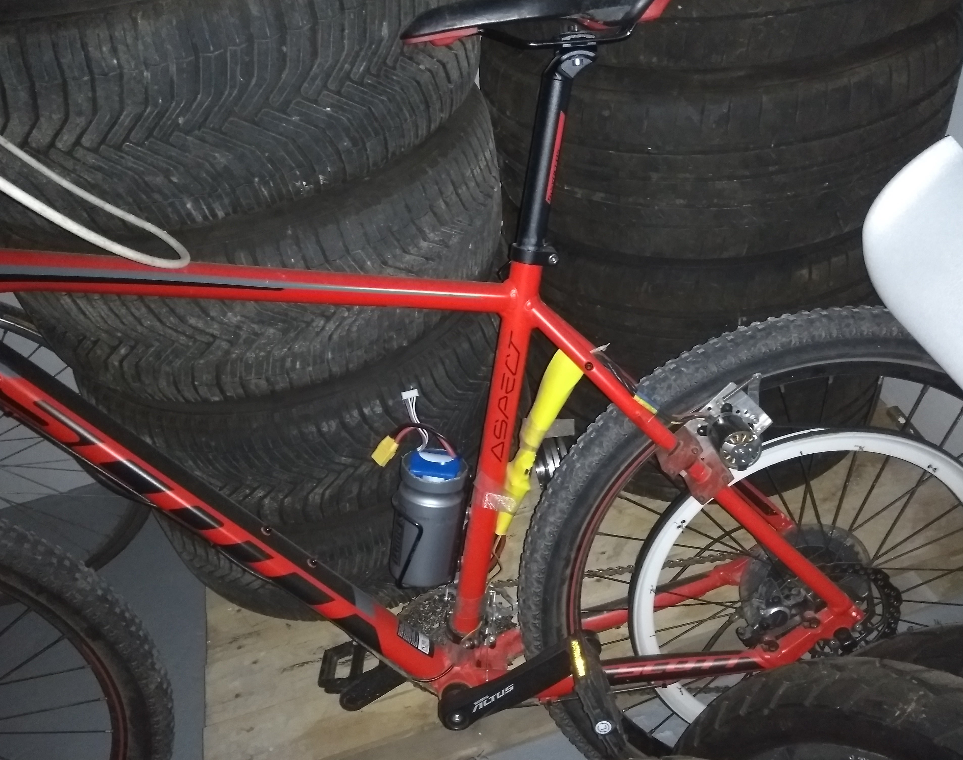

Just wanted to share a few details on my first build:
- Scott Aspect MTB
- 3D printed 440mm diameter belt wheel, fixed to 16 spokes. No teeths, just friction tape
- NTM 4248mm 650kv outrunner w 20T GT2 timing pulley
- 10mm wide 1524mm GT2 belt
- 30:1 gear ratio
- 4S 16Ah Multistar LiPo pack
- 50A VESC
- Tensioner by rubber band loaded dual ball bearings
- Type of riding: Power supported daily commute.
So far I've done 6-7 short trips, and today I took the bike for work - 10km each way. It worked well, my average speed was are 25km hour +- 2km/h depending on wind. Recharged during work with 6004mAh, so consumption around 600mAh @ 4S per KM. Perhaps less for the return trip, as this had tailwind. This would translate into 200 watts of assist power. The motor temp is around 20*C above ambient, so electric efficiency would be at least 80%, I guess.
The bike does more or less what I hoped, perhaps it's more power hungry than I expected.
Is 200W to be expected for light/medium assist? I was perhaps expecting 100watts, but there are losses, ofc.
thx / vbr

thanks :D
Efficiency
The recharge was 6Ah, or 6004mAh, not 600. The 600mAh is per km, resulting in the 200W. I just finished recharging after the home run, this was 4400mAh for the 26min drive, or 152W average power, so the wind has indeed an effect.
3D belt wheel
I persuaded one of my employees to draw and print the drive wheel. Initially we decided to go for a tooth-less approach as there's more than 120cm of belt contact. The surface is convex to help the belt line up, but the material turned out to be very slippery, so we decided to go for the friction tape. And, yes, I'm keeping an eye on wear. I can share the file, if anybody wants to use it. I am getting another, larger wheel shortly, but that had to be printed in several pieces (3D printer size limitation), that will need to be glued together.
Free wheeling
Originally, I had envisaged the belt wheel riding on 8 or 16 ball bearings (fixed to the spokes) with a ratchet mechanism for free wheeling when pedalling hard or coasting. I'm not sure if I want to implement that because it will prevent me from picking up brake energy. But the belt tensioner is a problem, because it only works in the drive direction.
Two way tensioner
I consider replacing the single action tensioner with a double pulley tensioner that will allow force to travel in both directions. The two pulleys will be pushed/drawn togehter by the rubber band, but they will swing freely together to allow for shifting power directions

1mm wire through dual holes around the spokes. In 8 spoke positions I cut small recesses as half of the spokes are outside/higher than the other 8. This way, the rim/ring rests nicely on 16 spokes. I don't expect to transfer monster power this way, but it seems to cope effortlessly with the 2-300watts, I have on tap now.
My current tensioner does not allow braking. It will only make the belt slip on the motor pulley.

Pulley wear at 70km:
Still no slippage, but it doesn't look like it will make it past 100km. Waiting for the brass pulley to arrive. I wonder what causes the wear: Just the fibre inforced belt, or dirt particles picked up from the non-slip surface or from the street?
3M or 5M belt and pulleys most likely a better choice, but the GT2 belt was the most readily available when I started out.
I passed the 100km mark today, and celebrated by replacing the 20T pulley with a fresh 16T Alu pulley (the only one available with the brass pulley sitting in a slow boat somewhere). I also swapped the 4240mm 650KV motor with a 4258 mm 500kv and went from 4 to 6S. The 10mm GT2 belt looks rather sad, but I have yet to experience slipping.
To eliminate the risk of grains of sand from the friction tape transferring from the large wheel to the Alu pulley and to reduce belt wear, I replaced the friction tape with an ordinary 10x4mm adhesive rubber seal/gasket (for windows and doors)
That works remarkably well. I had feared derailing the belt, but the 10km drive home from work on a mix of high speed paved roads and bumpy dirt roads didn't affect it.

The 25T brass pulley arrived after quite some shipping time. Meanwhile, some othe stuff also arrived, including 5 pcs of new 1524mm GT2 belts and a 280kv 5055mm SK3 motor:
It was on sale ($30) at HK, so I grabbed one to get the current down (low KW = equals more cells = lower current), as my SK8 ESC is rated at 50A only. I mounted it, replaced the rubber belt tensioner with a normal spring and tested on the 24v/6S pack. Smooth and powerful, but down to 26km/h topspeed.
Now I searched my basement, and found my old 3 x 3S 5200mAh pack used for the FPV channel flight (https://youtu.be/BwYqwspPHhM), re-did the connections from parallel to serial and, voila, a 9S, 5200mAh pack that still fits the bottle holder :)
On FOC efficiency: After having run different motors in different modes (FOC/"BLDC") and configurations, it seems that the motors always run at a higher temperature and with lower efficiency in FOC mode. I may be loosing up to 20% range in FOC mode. I wonder why? Maybe because I'm running the motors at near full RPM at 50-60% of the time?
Anyway, I'm reverting to traditional PWM ("BLDC") control mode for a while to get results for comparison.
EDIT: I have just concluded a simple 3km test with the exact same set-up and near identical condition. In FOC, the recharge was 1020mAh, and in normal PWM ("BLDC") mode, the recharge was 860mAh. The motor also seemed noticably cooler in "BLDC" mode.
So, in my case, "BLDC" mode outperforms FOC mode in efficiency :shock:

A little update: Currently running the bike with an 4258mm NTM 500KV motor on a single 6S pack (the 3 x 3S packs were just too troublesome to charge - one at the time).With a 16T sprocket the gearing is something like 16:780 or 1:48. I have enlarged the tensioner bearings for lower friction and longer life and I've updated the VESC firmware to the latest available, and gone back to FOC configuration. Clearly less noisy.
My latest 13km ride to work cost only 3030mAh @ 6S, equalling 235mAh/km, corresponding 353mAh/km @ 4S which is the best I've got so far. I think the ride took some 36min, so it should be around 130W of assist power. Maybe there are so many other factors to the efficiency that it's impossible to distinguish the "BLDC" and "FOC" modes...

markz,
sorry for the delay. I'm about 210lbs and the weight added by motor/drive/ESC/battery is very low, like 4lbs.
