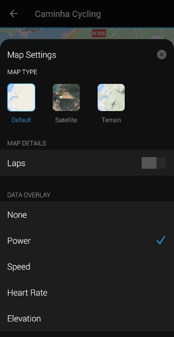

Comparing a Specialized EBike with TSDZ2 EBike
On last days, me and my wife, we were far from home, on holidays. We had planned two full days riding our ebikes with TSDZ2. On first day my ebike TSDZ2 did fail and I had to rent an ebike and I had the luck to be able to have a nice Specialized EBike that I was happy to compare with TSDZ2 EBike.
Experiencing EBike wireless standard with the Specialized EBike
While I was riding I realized that this Specialized EBike is turned on in the battery and not on the display, like if the display is not really needed and quickly I figured out this model could implement the EBike wireless standard. See that I am in the middle of developing the same EBike wireless standard for TSDZ2.
I had my Garmin GPS unit on the handle bard already because I had our route planned and we were following it. I just had to go to wireless sensors configuration and click on discover new sensors and I got this ones from the Specialized EBike:
Note that the heart rate sensor is the one from my watch:
Then automatically the following main screens were added:
EBike main screen to control assist level, see battery status and light status:
At the end of our ride, on the Garmin app, we can see graphs of fitness and cycling metrics but also the pedal human power, speed and cadence were recorded:
And interesting is that there is a map showing the route but with color gradients that we can select for some variables and the pedal human power was available:
