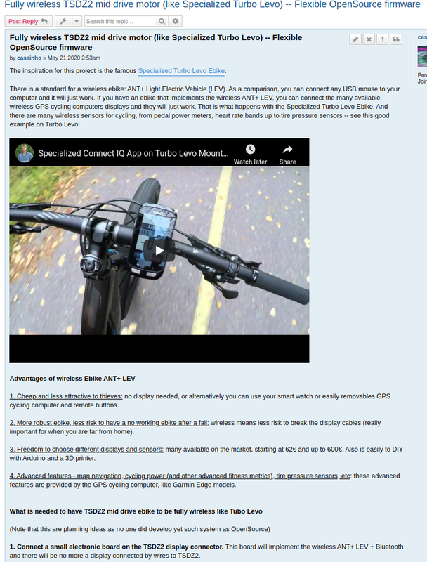

Very good work!! I asked for myself what was your ambition, what would be the new and most advanced feature you wanted to implement -- in my head could be map navigation on the Android app, but, after researching and talking with others, seems VERY hard for someone to do it. And on the journey I ended up seeing how the commercial products are doing it and then I found they are not doing it!! They are instead creating ebikes compatible with the wireless standard ANT+ Light Electric Vehicles (LEV) profile -- then a new world of map navigation and advanced fitness and cycling sensors opens!!
I would like to invite you to read more about this idea of a Fully wireless TSDZ2 mid drive motor (like Specialized Turbo Levo) and I hope we can collaborate in future. As you can see, your board and Android app are a reference, I hope they can be reused on this new project: viewtopic.php?f=28&t=106346
- TSDZ2 OpenSource firmware
Developer of OpenSource knowledge and technology for ebikes: Wireless Ebike boar ANT+ and Bluetooth, Flexible OpenSource firmware for EBikes: TSDZ2 mid drive motor, KT motor controllers and displays: Bafang 850C color, SW102 Bluetooth and KT-LCD3.
hello Casainho,
thanks, but I would have done nothing if your Open Source Firmware had not been there.
I don't have plan to add too many features to the Android App, my intention is to use the app mainly for the setup and monitoring of the motor.
I use the bike mainly for fun to ride in the mountains and normally i don't use nothing else than the switch to change assistance level :).
The only advanced feature i use when i ride on new traks, is map navigation, and for this feature i prefer to have a rugged Android Phone. I had in past also Garmin devices but i think now an Android Phone give a lot more flexibility (my favorite navigation app is Oruxmaps).
In any case your idea is really interesting and i think also ANT+ is now a consolidated standard for the ebikes.
I will be glad to follow the thread and, if i can, i will also give help.

mspider65 wrote:
May 21 2020 8:02am
casainho wrote:
May 21 2020 5:00am
hello Casainho,
Massimo
Maybe the advantage of ANT+ is the cycling sensors (and ANT technology belongs to Garmin). And Garmin advantage is probably their advanced fitness algorithms and metrics, and all integrations between different devices - they even buy the fitness algorithms to FirstBeat.
Since this wireless project have Bluetooth + ANT+ parts, and the Bluetooth part have the same objective as your project, makes sense to just use your project.
On the firmware side I just need a firmware that implements the same you are doing (I already have implemented UART and cycling Bluetooth profiles on SW102 display). Then I need to have ANT+ running simultaneous and implemented the specific profiles on ANT+.
So, I will keep following your project closely. And please implement the last firmware version, you will get motor cadence support up to 120 RPM!!

I really hope we can merge TSDZ2 wireless standard project and this one in the future, so everyone can enjoy the most updated firmware and features.
A video showing the Garmin GPS cycling computer controlling the battery voltage to turn on / off the motor -- changing assist level on the display and when value is zero it disable the motor voltage:
If you like my work, please consider making a donation to help my developments: paypal.me/jorgecasa
I am happy to see that the fully wireless TSDZ2 project is going well :)
