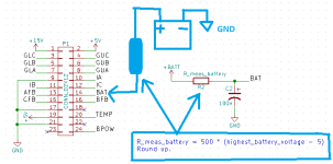

--Brain board wiring and setup, including the 12v DC-DC for running the IMA gate drives, connector pinouts, BobC SMDLebowski board buildup / test instructions & schematic, etc

The Lebowski brain board itself is very small, about a couple of inches across and not much more than a quarter inch tall, if that. It might weigh more than a candy bar wrapper...ok, a couple sticks of gum.
Cables and wires, well, those depend on your usage for it. If you end up using 10g - 6g battery or phase wires, or bigger, it's going to be several pounds more, but then, you would probably already have those wires on your system.
BRAAAAINZZZzzzzz:
For the brain boards...I have a pair of the thru-hole Whereswally606 PCBs, and had begun collecting salvaged parts to build them from, but never got very far, and never assembled any of them, as again my budget at the time prevented purchase of most of the stuff needed, and despite my too-large collection of disused and inoperative electronics :oops: I didn't have very many of the parts required available to salvage. Now I have a bit more money available for a variety of reasons, but the cost of just the parts to build these is higher than buying the SMD versions from Kiwifiat, and I am not sure i trust my assembly skills enough these days anyway, for so complex a project. So these are to be sent on to someone else that might wish to build their own "from scratch" as I thought I was going to. I'll just check with Whereswally606 first to see if he has a preferred list of people that would want them.
So...I bought a pair of Bobc SMD Lebowski brains from Kiwifiat, which came to a bit over $200 including shipping / etc., and they're now in-process and will be here in due time (EDIT last week of April, they have arrived). At his recommendation, becuase I"m using htem with a system that wont' be using the 15v SMPS on them, that section is unpopulated so it wont' waste power/make heat, and so it can't be there to have any failures that could impact other components, or for me to make mistakes with. :oops:
And for the moment, that's it. :)

Voltage measurement resistor, for BAT pin (which is the pin that measures battery voltage, and is NOT the battery power (BPOW) input pin!!!). This is calculated as
R_meas_battery = 500 x (highest battery voltage - 5)
and then round up, to get the value in ohms of this resistor (which can be a tiny 1/8w or less resistor), to the nearest standard resistance value.
So if like me you have a 14s battery, and if it fully charges at say 57.8v, then you would use
R = 500 x (57.8 -5)
R = 500 x 52.8
R = 26400
R = 27kohm resistor.
This resistor simply goes in series with battery voltage into the BAT pin.
Voltage measurement resistor.PNG (12.56 KiB) Viewed 4999 times

Because IGBT's are slow in comparison to mosfets we need to set deadtime to 2000ns and pwm frequency to 6kHz.
The following image shows how to wire a BobC brain board into an IMA inverter:
“You never know if quotes on the internet are genuine.” - Abraham Lincoln

Thanks! I'm not yet at the point of wiring in the brainz, but I'm close. I probably would've gotten there today, but I have to go back to work tomorrow, so had to spend the last little while clean up all the stuff scattered around that I've been working with, so the dogs dont' have a party with it while I'm at work. ;)
