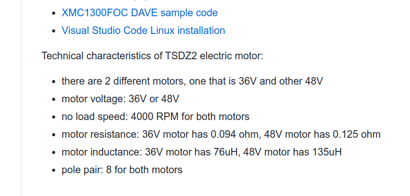

Do we know the motor parameters for the TSDZ2? We need senseful values for making the motor run in sensorless mode with the DAVE FOC APP. This are the default settings in the APP:
motor parameters.JPG (107.67 KiB) Viewed 682 times

stancecoke wrote:
May 02 2021 5:24am
regards
stancecoke
I think it calculates and makes pretty good guesses from the inductance and resistance. Seems to be fairly insensitive. Just measure them and let it calculate the others...
LCR meter, VESC or... MESC can tell you if you plug in the debugger :wink:

stancecoke wrote:
May 02 2021 5:24am
Yes we have!! A developer, at very beginner of this developing our firmware to motor controller V1, did measure the resistance and inductance of the motor, using the tools at his work. We have the value of:
- motor voltage
- no load speed
- motor resistance
- motor inductance
- pole pair
We have everything :-)

casainho wrote:
May 02 2021 2:36pm
stancecoke wrote:
May 02 2021 5:24am
- motor voltage
- no load speed
- motor resistance
- motor inductance
- pole pair
I think @abrainer is testing to run the motor, I hope he can test using this data. I updated the repository with the technical characteristics of TSDZ2 electric motor:

stancecoke   100 kW
Posts: 1458
Joined: Aug 02 2017 2:56pm
Re: TSDZ2 48v 2020 new firmware
Post by stancecoke » May 03 2021 12:39am
casainho wrote:
May 02 2021 2:53pm
We tried a lot over the weekend, but the transition from open loop to FOC mode always fails. :(
Without understanding, how the code works and targeted monitoring of relevant variables at runtime we won't get anywhere at this point.
perhaps @mxlemming can give a code example, that worked on his controller.

stancecoke wrote:
May 03 2021 12:39am
casainho wrote:
May 02 2021 2:53pm
And do you think it is possible to move forward?

casainho wrote:
May 03 2021 2:15am
for me, without hardware, it's not possible.
@mxlemming had the same issue obviously, he solved it in the end:
https://www.infineonforums.com/archive/ ... 125fcafc7f
regards
stancecoke

stancecoke wrote:
May 03 2021 2:25am
casainho wrote:
May 03 2021 2:15am
I have the hardware so I should try. Please tell me your suggestions on what I should do and take care. And I hope you did update the code so I can use it.
So looking at the link, seems he had and issue with an incorrect opamp but since our hardware is already tested, we should have no such issue.
About the hall sensors, is everything already setup to use them?

Post by mxlemming » May 03 2021 2:46am
Hi all,
My issue with the transition was hardware related to crappy TI opamps that phase inverted just below the bias voltage. I replaced the opamps with on semi ones (no idea what part codes, not that it matters) and it immediately worked perfectly and was fairly insensitive to parameters - I had a massive alien outrunner 50kV 65uH running with the same settings as an 1100kV 2826 turnigy with 6uH...
If it's not making the transition, my guess is that your current readings are messed up. Perhaps you're not reading the right channels, they're inverted, swapped over, should be differential... Could be all sorts... And the xmc1300 series has some kind of funny gain settings.
I don't have the hardware to hand, so I'll be of limited use to you... I'll have a quick look through the thread for setup and writing info.
Edit: i just remembered i made a batch of dev boards for this xmc1300 and have them soldered up! So at the least I can join you all in compiling and looking through things. Might be able to shoe horn it into some power stage if I'm really enthusiastic...

Good news! :-)
@abrainer managed to get the motor running in sensorless FOC mode, the error was just the wrong polarity for the half-bridge drivers....
I've updated the masterbranch with his settings already. The motor runs just with a hardcoded setpoint at the moment. There is no throttle input supported yet.
regards
