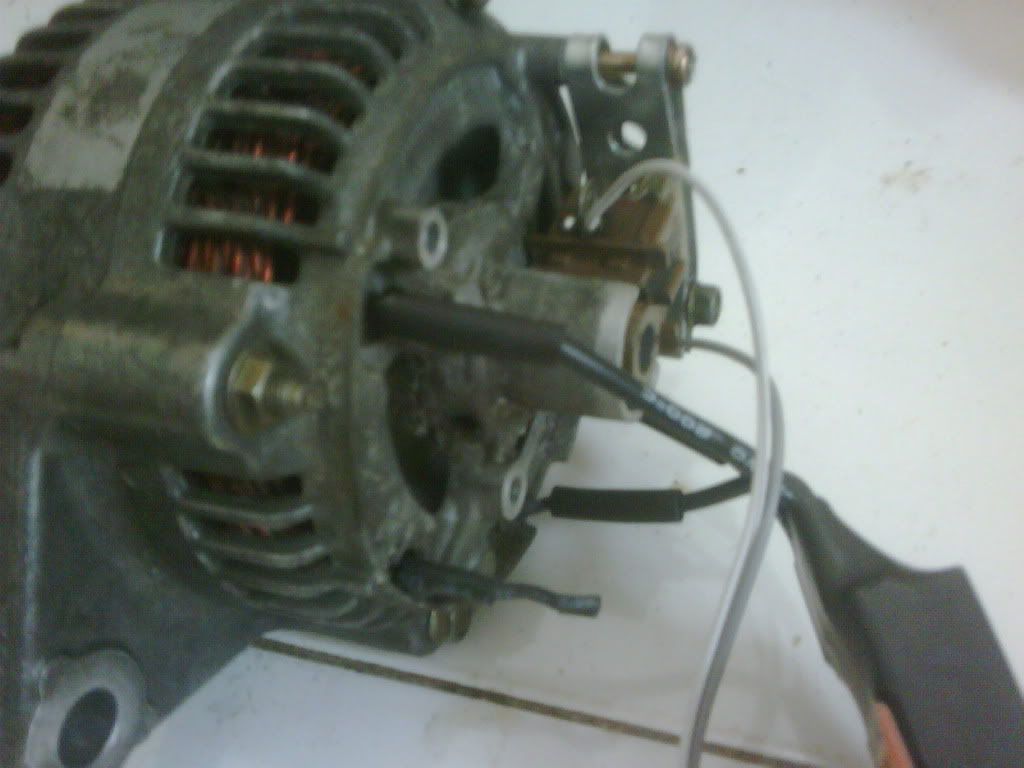

Well alternator is basicly a three phase generator/motor with a controlable rotor flux through a slip ring (i.e. carbon brush), so what I did was removing the diode plane and rewired the cable into a "delta"
In this picture I used ND 30Amps alternator using the default "Star" wire configuration with less power (the Delta provides 1.6 times of power compares to the star if I wasn't mistaken)
Once you power-up the rotor through the slip-ring, it become a normal brushless in-runner motor, so you could spin it off using normal RC brushless ESC, just make sure that you use the large one as the current for start up is quite big. I always used at least 100Amps rated ESC, which is now is quite affordable through the online stores in HK :D .
