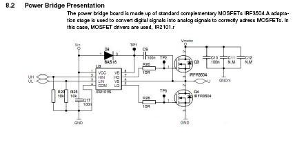

salty9 wrote: Your material use is inspired. I had considered using perf board and ic sockets but didn't know it it were feasible. With care, you should be able to go from prototype to use. I will look at cell phones with different eyes - not as irritating annoyances but as raw materials for use.
Could you post a schematic of your controller?
Well that is actually what I did, a perf board & IC socket, but for the mosfet I used a 10x15 in heat sink. Hope this picture could inspired you
On the schematic, Atmel's Application note AVR32710 clearly explain which only for easy access are shown below
Image, you need to have three of this.
From IR2101 design tips, please note you should use non electrolyte capacitor, so what I used is a 6.8mF tantalum capacitor. I did not use the resistor though, as I was working in a controlled environment. Hence, for the photo above you could see that I only use 2 capacitor and 1 diode for each phase.
