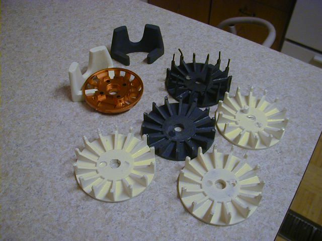

M,
I ran test fans on my motors out in California. (it was 107F-deg that afternoon) the fans work as well as they could have, but I did notice they were deforming under the extreme conditions.
I was going to look for a more sturdy casting compound for additional testing. If you want to test one PM me a shipping address & i'll send you a beta for further evaluation.
These will bolt onto the V1 or V2 magnet cans.

my advice on cooling is to sand (fine sandpaper) the paint away between motor and alu plate you mount the motor on, i have done this on the motor in my ciao and cooling got at least 4x better just by doing that, before i did it the motor would often get so hot that you can smell the copper on the verge of "melting"/shorting, after i sanded it down i just can't get it nowhere near critical no matter how much abuse i do!.
On the 80100 you have to sand down the front plate and also inside the front plate, the plate where the skirt-bearing is mounted also needs to be sanded, doing this you will be pulling heat from the stator out into the alu plate you use for mounting, also remember to use GOOD thermal paste between all the sections.
Now for the 80100 to get the best cooling i recommend making a "wire guide" on you mounting plate so you can attach you motor without the normal front plate, this will make cooling A LOT more efficient, on my C6374-200kv the front plate is apart of the motor, on the 80100 the front plate is separate, - point to above post by turd where you can see the front plate with the white plastic part attached -
