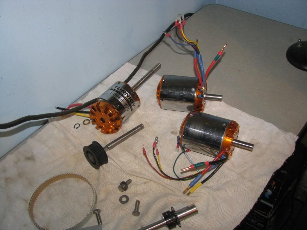

Ok then Roy, you asked for it!!
Then one just to make you jealous, there's over 15 kw of potential there:
I'm thinking of sending this 80-85 in for a wind, I actually want to bump up the KV a bit closer to 200 with better bearings to take the abuse along with hall sensors for the ultimate option.
One thing I must say, be sure to get the Thud 4 1/2" shaft cut off signature! I do believe the guy carries extra cutoff disks in his wallet where condoms used to reside. :lol: :lol: :mrgreen:

Looking just beautiful 8) You're going to kick some butt with those baby's :mrgreen:

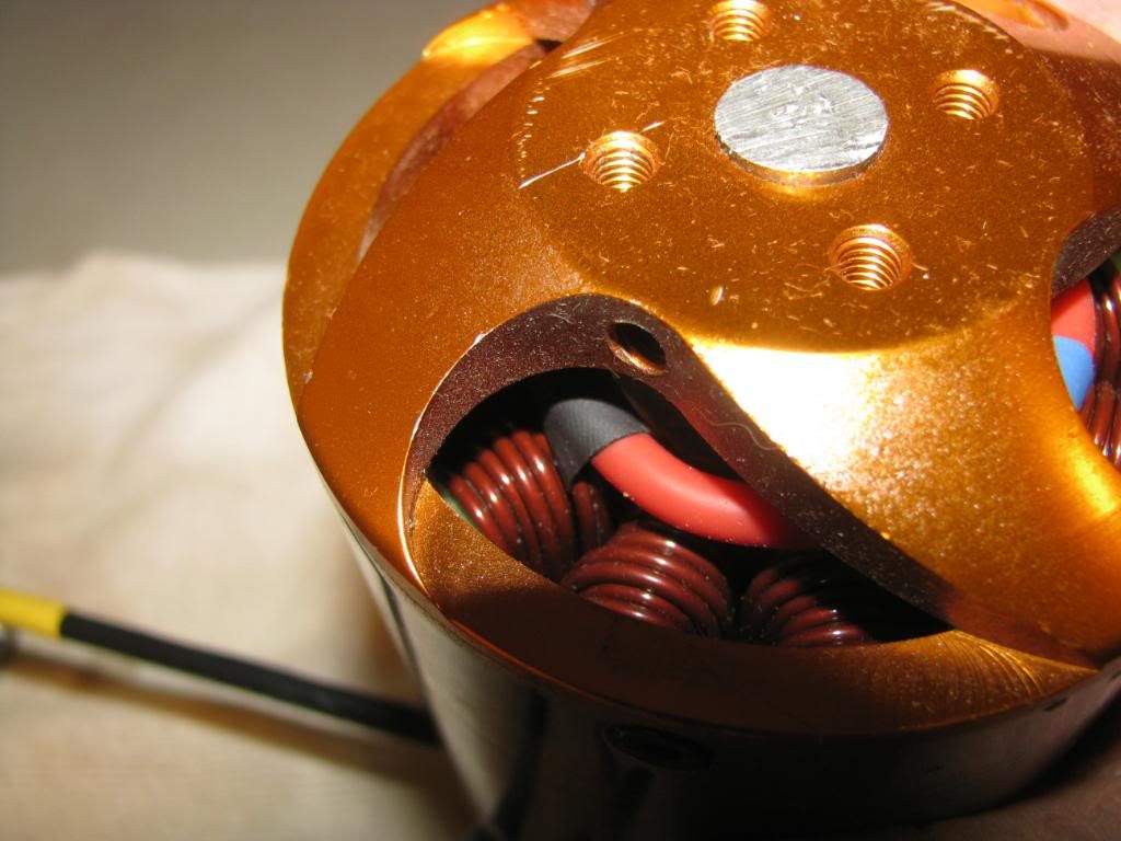

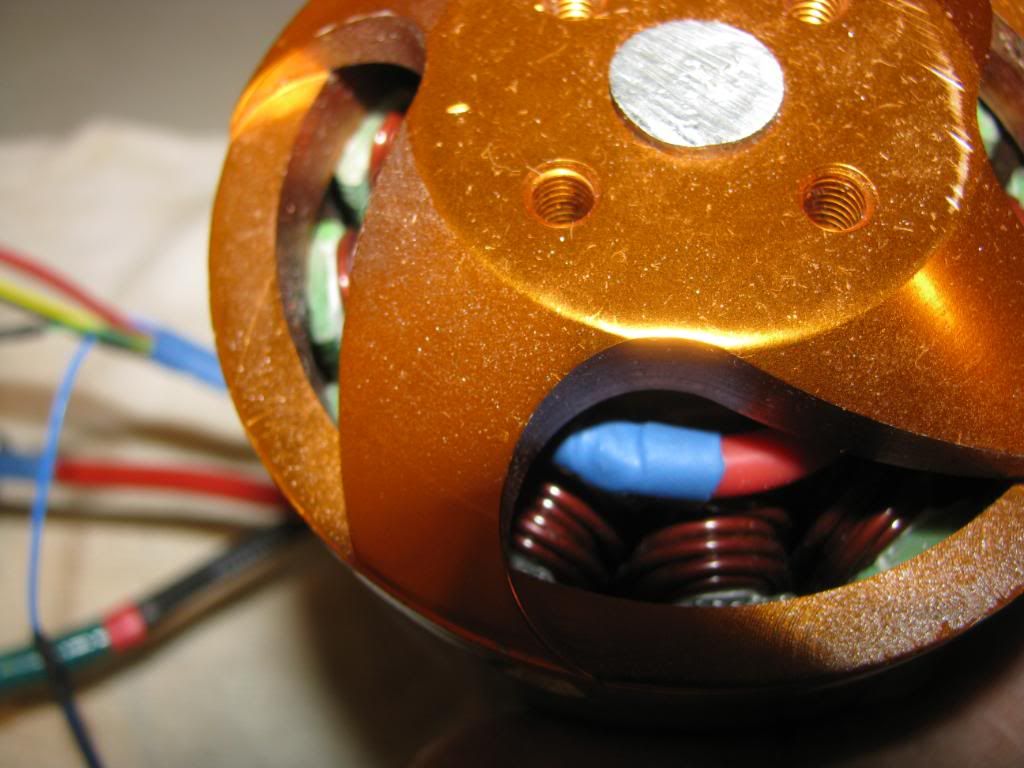

I finally went ahead and stripped my 80-100 for a rewind. The goal was to be able to use a single stage reduction into a nuvinci dev kit. I choose 12t delta for 88kv. This allows me to use a 10:1 reduction into the Nuvinci for a speed range of 16mph-58mph (overdrive). Its not as perfect as Thud's rewinds but this was my first one. A couple more tries and I think I could do much better.

Nice work. Did you use any tools?

E-racer wrote:I finally went ahead and stripped my 80-100 for a rewind. The goal was to be able to use a single stage reduction into a nuvinci dev kit. I choose 12t delta for 88kv. This allows me to use a 10:1 reduction into the Nuvinci for a speed range of 16mph-58mph (overdrive). Its not as perfect as Thud's rewinds but this was my first one. A couple more tries and I think I could do much better.
Looks great. What size wire are you using? Looks like about 14 AWG. Have you measured the phase resistance yet? I did a 9T wye using 14 AWG and it's performing well - low kV and have not destroyed my controller yet.

Thanks! Yes im using 14 gauge. Resistance values were equal between phases I cant remember the values off the top of my head. Believe it or not I modified a couple tooth brushes for poke/pry tools. I haven't run the motor yet (waiting on Burties optical hall setup) but I hooked it to oscope and all looks good. I still have to do a final test then epoxy a couple places to reduce the risk of the coating chaffing.

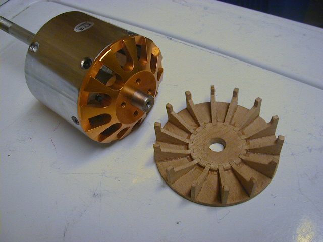

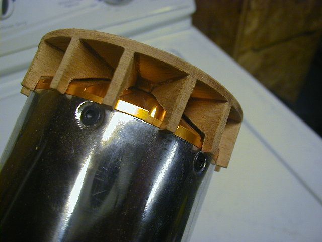

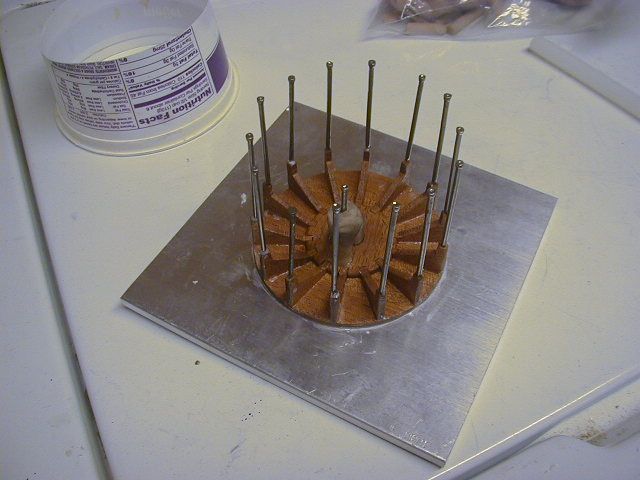

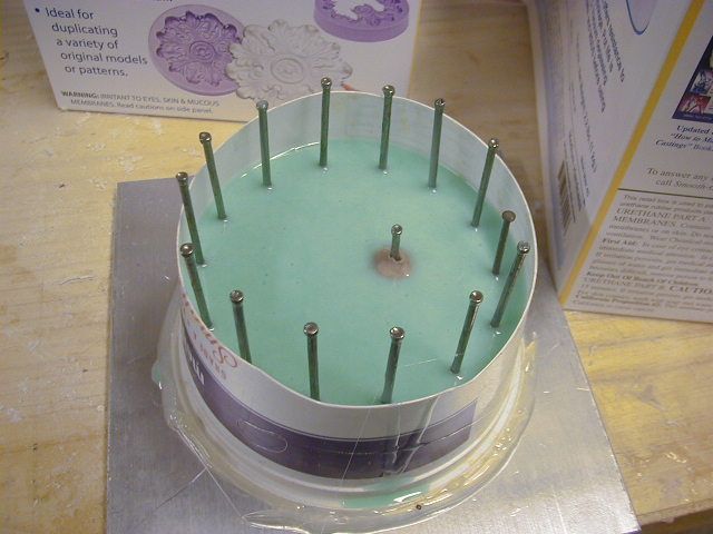

Post by Thud » Jun 03 2012 10:23pm
Had a productive afternoon polishing the 80mm outrunners.
I wound a motor today to power my FS 29er build...since I will be pounding this motor, I thought I would try to air cool it with a few of my personal stylings. cooling: The motor is wound as LRK & terminated in wye...this leaves 6x more area for cooling air to flow thrugh the motor...& odd as it seems I still have a 25% increase in copper over the stock wind's
Now that the motor will pass some meaningful air through it, we need a little air motivator...so I patterned one up & made a mold so I can make these in #s I have a few motors laying around that will benifit from forced air cooling:
the rough plug:
super glued to a piece of aluminum so I can chuck it in the lathe:
A few minutes later it looks like this: (I love mahogany)
So it can do this:
A little Lacquer & some vents & its ready to cast the mold:
Now for the gooey silicone liquid tooling
all poured & ready to cure:
after 18 hours I can make the bottom 1/2 of the mold....then in a short 18 hours I can cast blower fans till the cows come home.
yes they will be available for your motors too.
hope you had fun following along.
I'll post the actual kv from the re-wind after a spin up...
all or your 85's are belong to us......

I wound a motor today to power my FS 29er build...since i will be pounding this motor, I thought I would try to air cool it with a few of my personal stylings. cooling:
The motor is wound as LRK & terminated in wye....this leaves 6x more area for cooling air to flow thrugh the motor...& odd as it seems I still have a 25% increase in copper over the stock wind's
