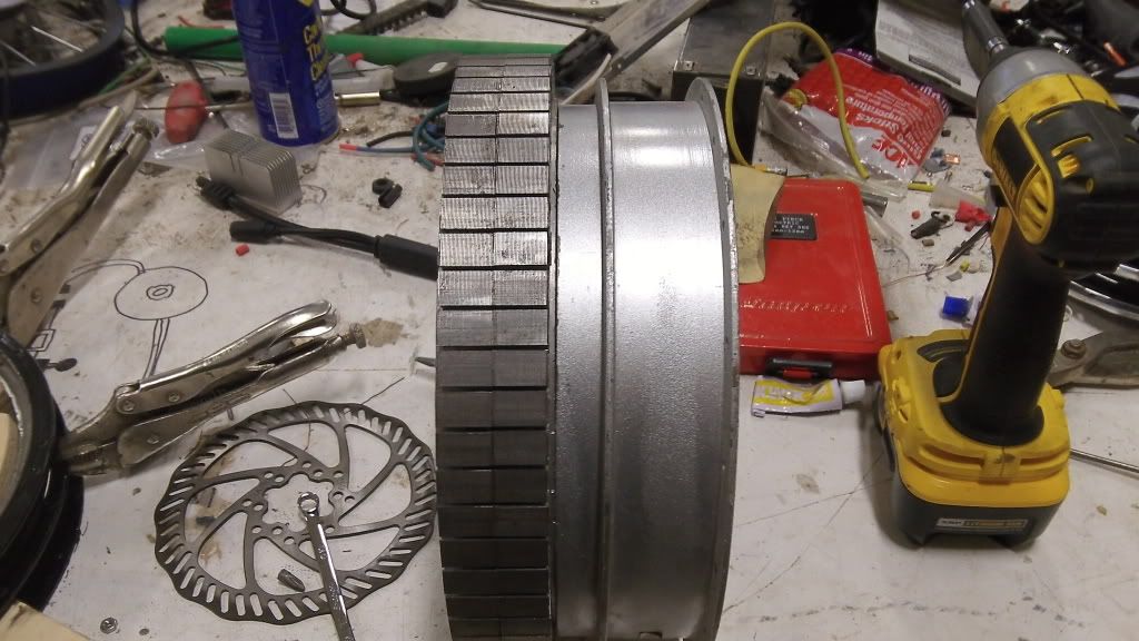

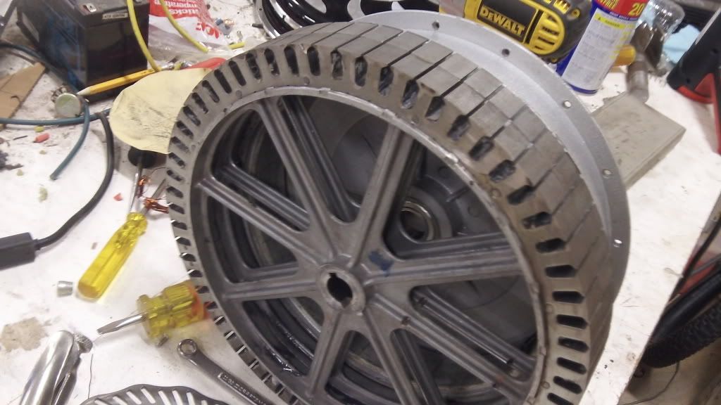

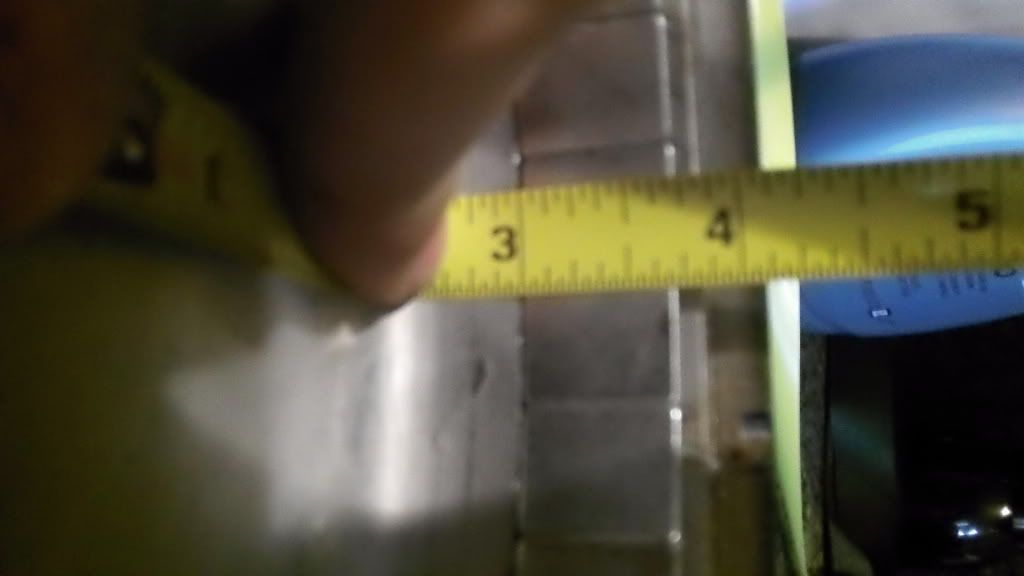

woo! have pictures, the stators weren't as wide as Id hoped, so I may end up doing three of them, but will see what it looks like with two.
looks like it will be 38mm wide, and 260mm in diameter, with 63 teeth and 56 magnets.

just cut one of the coils, and it looks like its 6 turns of 8 wires, as there is 48 wires passing thru one slot. Is this correct?

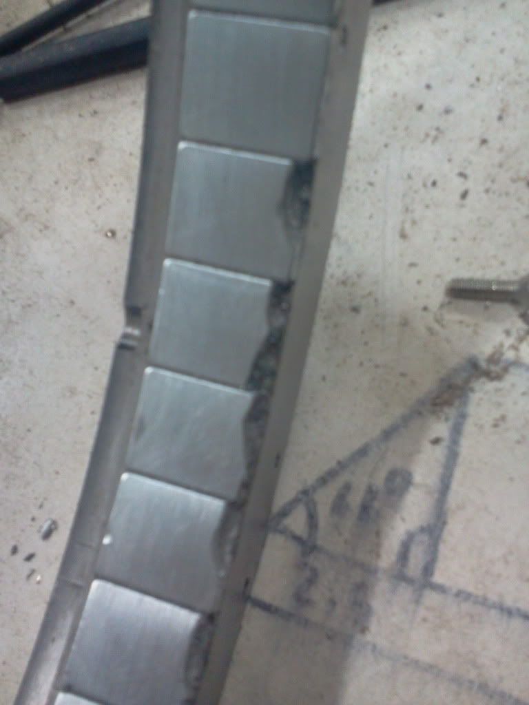

Got the windings cut off and machined the stator cores to mate flush with eachother. But when i was machining the magnet ring to be flush to the magnets I effed up, hopefully not too badly. I lathed the very edge of the magnet ring a little tiny bit which fractured the edges of the magnets. None of them are cracked, and a non-cracked magnet ring will be right next to it, if all else fails i can buy new magnets, as they are just flat magnets and not any special curve.

The magnet chipping is not a real show stopper. I wouldn't worry about it other than you should paint or epoxy over the exposed magnet material. The tiny decrease in magnetic strength will slightly change the voltage constant but probably not enough to measure.

Farfle wrote:Got the windings cut off and machined the stator cores to mate flush with eachother. But when i was machining the magnet ring to be flush to the magnets I effed up, hopefully not too badly. I lathed the very edge of the magnet ring a little tiny bit which fractured the edges of the magnets. None of them are cracked, and a non-cracked magnet ring will be right next to it, if all else fails i can buy new magnets, as they are just flat magnets and not any special curve.
I bet the magnets chiped when the stator was installed into the magnet ring last. To many people are not carefull enough with that.

If you want to see what effect the chips in the magnet have, put a sheet of white paper over the magnets and sprinkle some iron filings on. Tap the paper slightly and you will see the lines of flux. I don't think you will see a huge difference between the chipped ones and the perfect ones.

Arlo, they chipped when I tried mashing into them with the toolholder at 860 rpm while i was machining the sideplate. If any of you get to machine magnets, i would highly reccoment high speed steel, as it produces a spectacular magnesium-like fireworks show.

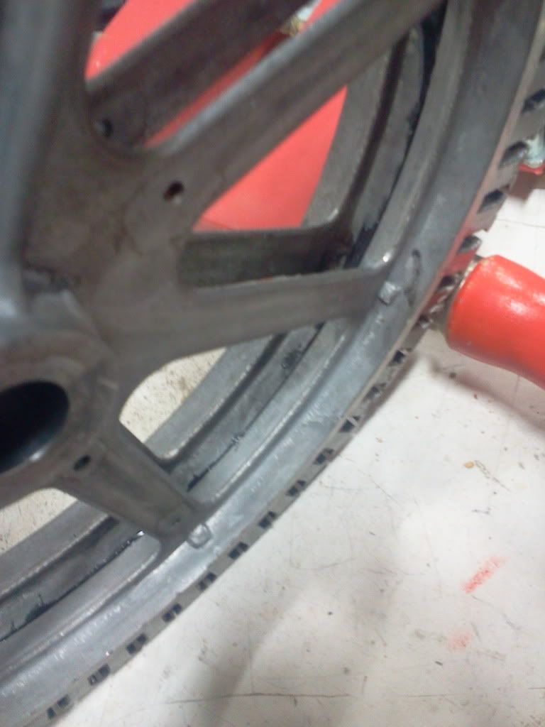

More progress made, I think Doctorbass would be proud :D . I got the two magnet rings glued together with DP420, Thats a B*$&# by the way. They do NOT want to be side by side, ended up machining a massive plywood plug that gets pressed into both rings, screwed it and the bottom ring to the table and stacked the two, and held them together with vise-grips. Hopefully it comes out tomorrow when the glue dries :shock: . Oh and heres some side-by-side comparisons with an old crystalyte outer case:
