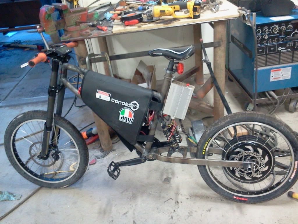

Postby Farfle » Sun Feb 26, 2012 9:28 pm
Im so sorry guys, I took the bike for a run, and left my helmet can at the house :cry:.
Here's some stats from the ride:
MaxA: 229
MinV: 93.2
MaxS: 69.7 (CA wasn't reading speed correctly, it was still accelerating)
Wh/mile: 79.6
Miles traveled: 3.9
The race bike:
24s5p 50c nano tech
Peak power in : 420A at 87v
Peak power out: 34 Hp and 105ft/lb

Postby Farfle » Sun Feb 26, 2012 9:59 pm
Here's some pics of the bike after the ride.

Postby liveforphysics » Sun Feb 26, 2012 10:53 pm
You should be a "proud papa" Farfle.
Thats a badass machine, and you made it yourself. Nothing you can buy can match that level of satisfaction. Savor it my friend.
