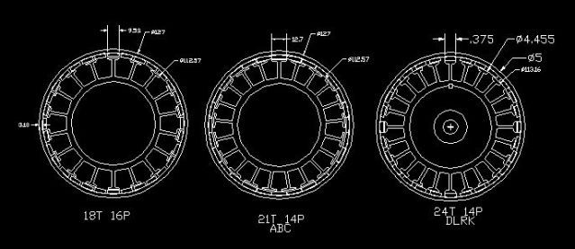

For your pleasure,
Here is a dxf of some stator configs utilizing standard NEO's & DOM steel for the flux cans.
OUTRUNNER MASTER.dxf
3" 4" 4.5" 5" & 6" motor lay-outs.
(249.2 KiB) Downloaded 112 times

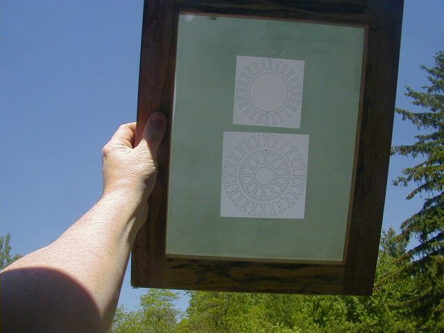

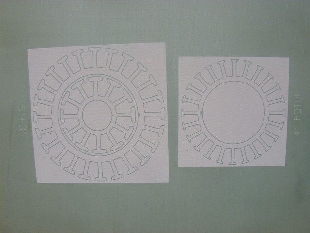

I guess i'll put this here at the risk of duplication when I actually make time to finish the motor prototyping project.
I bought a stock of .008"t shim stock to make laminations & planned on insulateing them with a thin nomex sheet between each lam. The steel is (1080 low carbon) no where near real lamination stock but the only thing in my price & availability range.
After considering my options, I decided photo etching was the only reasonable way a guy in his basment could pull off making a batch of perfect laminations. I Have the screenprint that nests a 3" & a 5" motor in a single pc of stock.
but my shim stock was rolled...I cut it to size on a paper cutter but it has a permanent "cup" in the stock that needs to be relaxed before I can start the printing proccess. (i'll clamp the whole stack between 2 plates & take it to red heat & let it cool slowly to unstress the steel)
Around the new year I purchased the latest Pulsed EDM board from Ben Flemming. Once I have EDM capability it will be a walk in the park to cut proper punch dies for MASS PRODUCTION :twisted:
Any one have any idea on what it would take to make a nice Laser for a bench top cnc ?(Co2 60+ watts?) I searched a little one night, but A clear example W/enough documentaion for me to plagerize didn't apeare....havn't got back to that one yet.

Thud's layouts (above DXF):
3" OD: 2.54" stator 12t 7p [DLRK]
4" OD: 24t 14p [DLRK]
4.5" OD: 4.46" stator 18t 12p [ABC]
5" OD: 24t 14p [DLRK]
6" OD: 24t 16p [ABC]

For design considerations, I am letting "on the shelf" magnets & available tube diameters dictate the motor design.
A 112mm (ish) stator fits lovely into a 5" shell with 3mm thick magnets.
At 16 pole pr's we would have to use 10mm wide magnets. (but an 18t 8p fits with gaps) we can increase copper & concentraight buy stepping to 21t 14p here is a screen shot side by side....along with my 24t 16p
Take your pick.....

Thud wrote: At 16 pole pr's we would have to use 10mm wide magnets. (but an 18t 8p fits with gaps) we can increase copper & concentraight buy stepping to 21t 14p here is a screen shot side by side....along with my 24t 16p
Take your pick.....
21t 14p would have greater cogging. If we want to run this at relatively slow speeds...
24t 14p has quite a low winding factor (0.76).
My vote is with 18t 16p.
BTW Thud, you wrote 16 pole pairs. I just assumed you doubled up on the magnets for curvature?

I did not, but tha is an option i supose....I been using nomenclature to fit my moods lately... so I have it drawn a little wrong. :oops:
I'll re-sketch it for the 8 pole pr count & adjust the tooth size acordingly for a better "looks about right" design.
