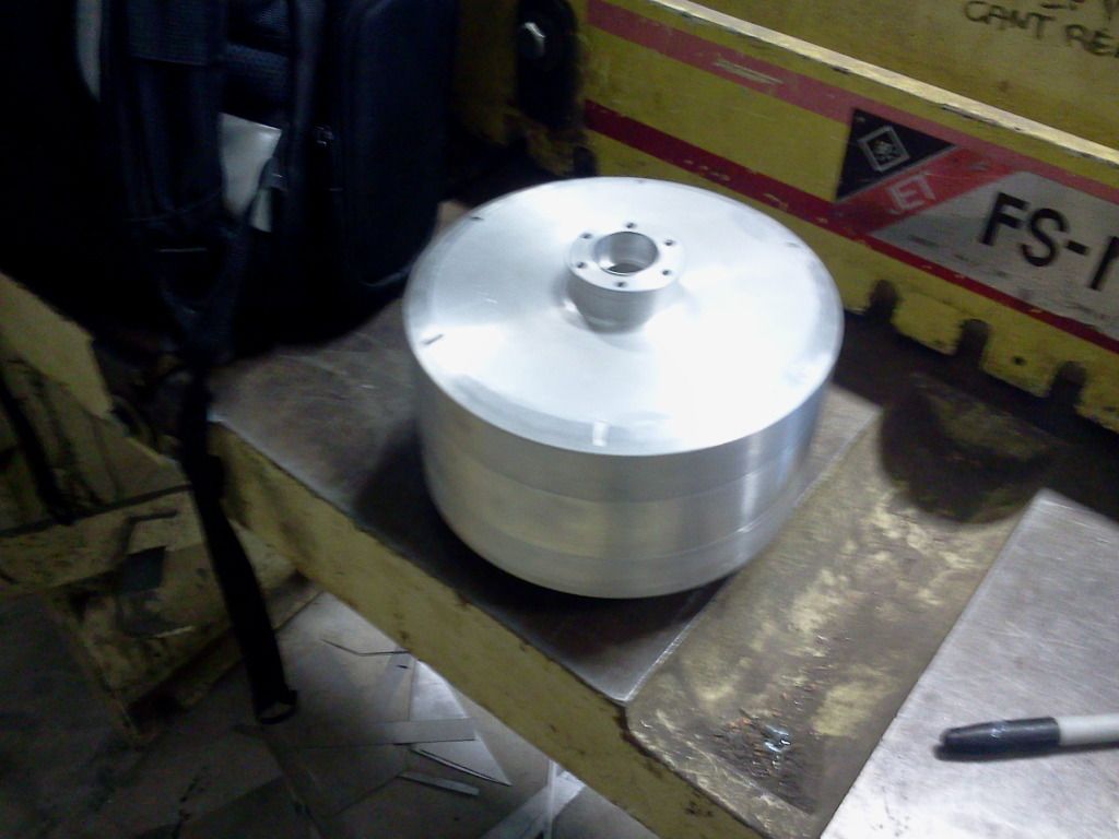

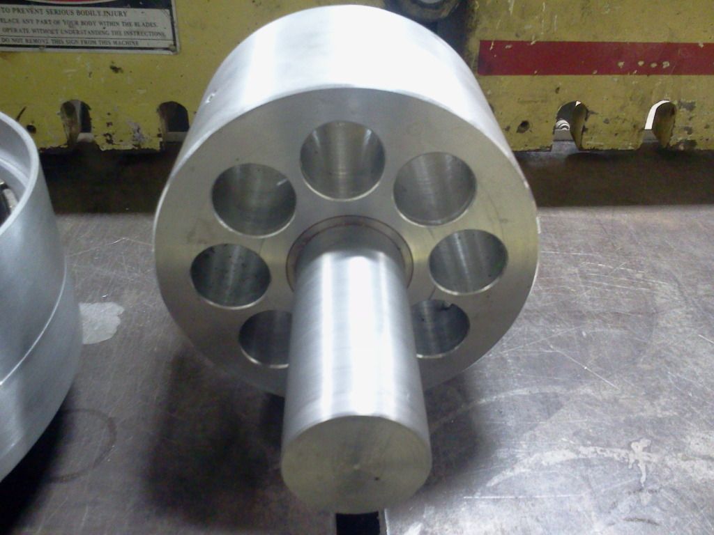

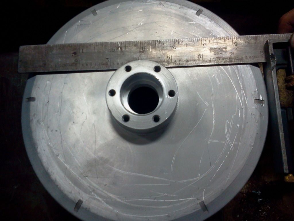

heres some pics of the outside of the motor, and the stator support. Weight so far is 8 pounds:

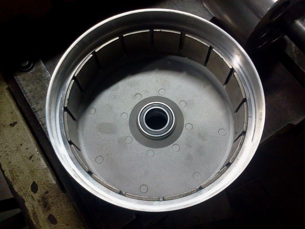

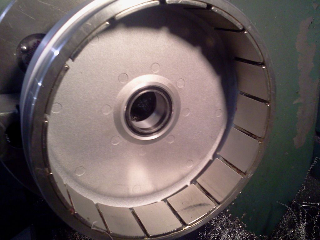

Post by Farfle » Jul 20 2012 10:21am
Heres a pic of the complete "can" . Its got less than a thousandth of wobble, so no vibrations spinning at 3000 rpm.

Bearings are machined into the sidecovers, and the new axle is pressed into the the sator center.

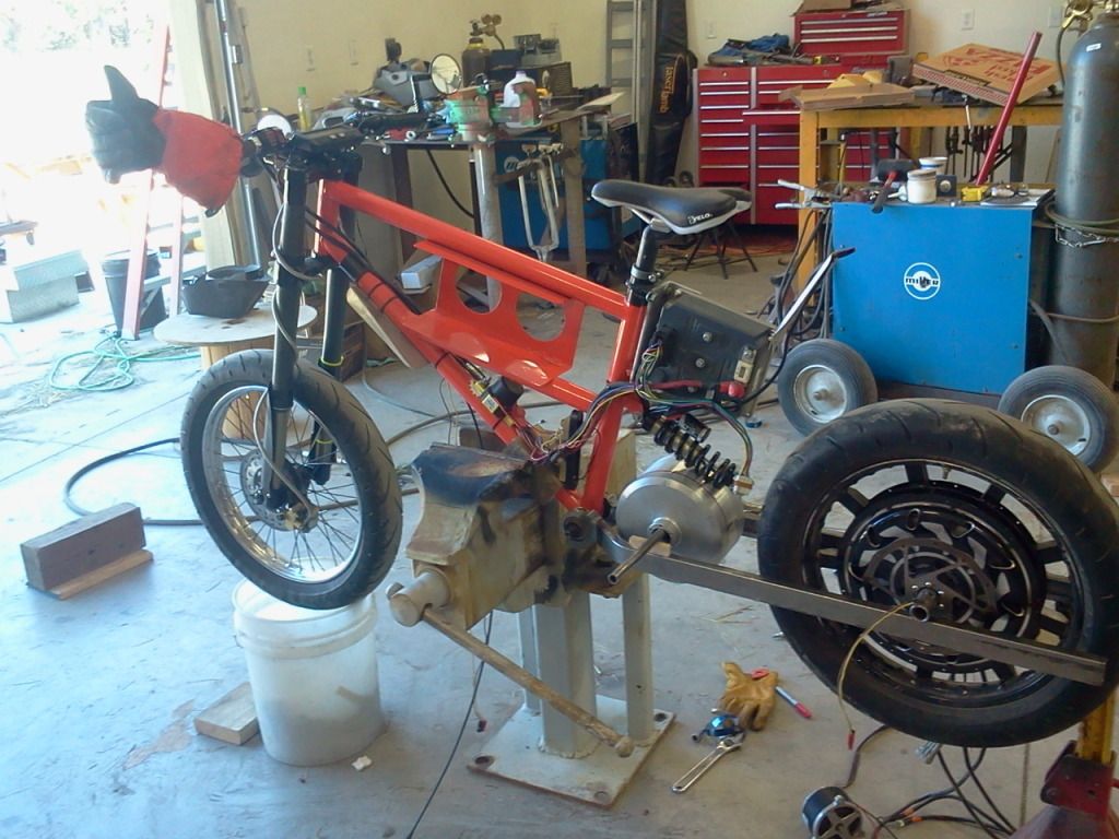

Post by Farfle » Jul 23 2012 1:20am
BB concentric swingarm pivot is almost done.

yeah, Its called turning. Anywho, heres a mock up pic of the motor :D .

nice work!!! is that a dirt bike fork? if so, where did you get the headtube to make a good fit?

fractal wrote:nice work!!! is that a dirt bike fork? if so, where did you get the headtube to make a good fit?
nope, its a Manitou Dorado, you can find them pretty cheap in need of a rebuild, which isn't real hard.

Hey Farfle, I'm really interested in your rear swingarm linkage. How did you make it ? Are they all custom made pieces? Did you use a special BB? Bearings, ...etc? Having the swingarm link on the BB seems like a good and simple idea.
