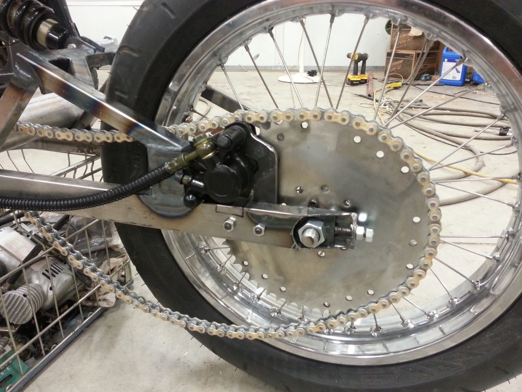

A massive home built motor, steel frame stout as a wrecking ball, and now an implementation of the mythical sprotor to boot?

That sprotor looks interesting! I think you will need to be very careful about lubing the chain, otherwise you might almost completely lose your back brake!

with a motor that big who needs a back brake, e-braking 'could' be brutal. Awesome build, I look forward to seeing it go. Another sevcon, are you diy'ing the programming?
