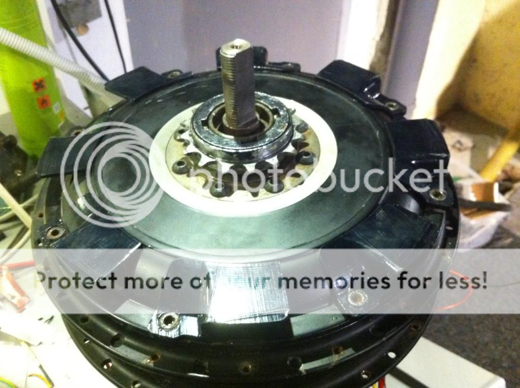

Peter Sternersson wrote:The covers are milled as follows, and I intend to use fan blades on the exhaust side for extra suction.
I think you need either more, or bigger holes. I guess with better fans it is less necessary, but it won't hurt to add some more I think.

I hade some scratches here and there inside the motor after pulling it apart the first time, so the paint was mostly extra protection. I do not think a 1/10th of a millimeter makes much difference in heat dissipation.
The size and position of the holes might not be the best, I simply milled existing drilled holes a bit bigger, but not so big that I milled away the reinforcements in the casting on the covers. I´m a big bloke with a heavy bike, I need as much material to hold me up as I can get :D
With the holes at the windings on at least one side, the copper should succumb to at least some air flowing past it. And with a aluminum stator, I think the air exchange inside the motor, even if not directly on the windings will make a difference.
The fans was bought after seeing them in this thread. This thread even inspired me to try some forced aid cooling before trying to water cool the motor.

I am confused about how these fan blades will work. They will be blocking the air flow as the motor spins. Or is this where the air exits the motor?

They are on the air exit side.
The thought is that the wings will create a low pressure zone behind it, and draw air out of the motor, and it does work.
Me and a friend have experimented to a great extent this summer.
We got his Cromotor V1 to run the same temp or cooler than my Cromotor V2.
My bike, 55kg + 95kg person. 24" wheel, Cromotor V2 with aluminum stator and Kelly 250A controller.
His bike, 55kg + 100kg person, 26" wheel, Cromotor V1 with steel stator and Kelly 250A controller.
Without the wings, his motor ran 10-30C hotter than mine all the time.

Peter, very interesting. Yes makes sense now. Are you going to add vents to the intake side?
Have you done a test with and without the wings on your motor? I'm wondering how much of a difference you noticed by just adding those.

Here's a picture of one of the blades made from rust resistant 1"x1" thin angle steel used in home roofing. I cut them simply with tin snips. The silver part is outside of the motor. The blade edge is at the bottom in the pic. The green is the thickness of the motor shell and the black and yellow protrude inside almost touching the motor end windings.
HubMonster blade.JPG (34.78 KiB) Viewed 3509 times
Here's what they look like mounted on the motor. Note that the angle steel give it good rigidity, and the side facing portion at the perimeter helps prevent air from rushing in to fill the low pressure area behind the blade. I did bend those sides slightly away from the motor thinking that would open up more of the slot behind the blade as well as push air away from that side.
Hubmonster slots and blades.JPG (26.92 KiB) Viewed 3509 times
I apologize for so little documentation, but this started as a test, and it's worked so well I haven't done anything further. The best examples of how well it works are:
1. With the motor already at operating temperature of 50-60°C, I did a high speed climb with the first few km averaging 5% grade, and the last 2.5km a solid continuous 20% very curvy and accelerating hard from very slow in each curve to up to above 80kph when there was enough straight to allow it. It was my first time up the road so I was extremely slow in each curve. The stator only got to 105°C, the hottest I've ever had it.
2. On a 15km ride mostly highway including one 2km 7% climb and back down the other side to a long slight grade into a headwind ending at a 200m net increase in grade, and speeds never below 90kpm after entering the highway and showing off for cars a couple of times up to about 120kph, stator temp very gradually climbed to 68°C when I parked. I haven't worried about motor temps since.
If I used a hubmotor for an offroad bike sure I'd use fans in the motor due to the low speeds, but they'd definitely be radial fans, not axial fans like everyone mistakenly uses. For the motor to act as a centrifugal fan itself, the higher the rpm the better. However, an offroad bike for me would see Pacific beach use too, so I'd go mid-drive using similar ventilation, but put a shell over the motor to provide a protected intake and an exhaust duct common of centrifugal blowers all in an effort to keep salt and sand out. With a hubmotor I'd get someone to build me a Lebowski controller or two, so I could forget about the halls, and epoxy up everything very well, add lots of outside surface area by welding AL blades to the covers, and fill it to an inch or two below the axle with ATF.
One more word about blades. People often mention exterior blades in the form of scoops or whatever. They're all just axial blades, and a waste of time. It's totally impractical to get sufficient blade size for the operating rpm, and even if you did the intake side would deflect sand, dust, and debris directly at the intake side of your motor. OTOH at the motor diameter and rpms we operate a well designed centrifugal fan can create enough pressure to move a lot of air. I can feel the exhaust side of mine throw off more air than the intake even from a couple of feet away from the wheel when spinning it up no load, so I know I moving air. While it's nowhere close to optimized, I quit because it works well enough and I can barely detect any increase in no-load current, so even at high speed the power cost has to be less than the reduced resistance of a cooler motor.
I'll do a good thread with video and lots of pics someday, but I'm really slow with that kind of stuff.

John in CR wrote: I apologize for so little documentation, but this started as a test, and it's worked so well I haven't done anything further. The best examples of how well it works are:
Tanks for the pics. Good Job! I can imagine those big blades will move lots of air through the motor when it spins.
I guess the inlet holes are on the other sidecover?

The way I look at interior blades is that air flow takes the path of least resistance, so it will tend to hug the smoother side covers. I use the blade to ensure the air is spinning at motor speed, and the blades force a restriction right at the stator. It pushes the spinning flow away from the side covers toward the end windings, and because the space between the blade tips and the stator is much smaller than the space between the stator and side cover, it is accelerated and more turbulent. That absolutely and significantly increases the coefficient of convective heat transfer. Think of the difference between blowing on your cup of hot coffee from 2 feet away vs from 2 inches away, or better yet the difference between drinking coffee that's too hot or cooling it with extra airflow right as it's going in your mouth by sipping it. It's not a subtle difference.
It makes little difference if you have little or no fresh air flow, because the air trapped inside can't hold much heat at all due to the low mass and low heat capacity, so the air gets up to max temp either way, but when you have flow then it helps get the air hotter and takes it more directly from the source instead of where it spreads.
I definitely like the ducted fan over centrifugal blowers for generally OFF usage...assuming the non-free intake doesn't harm the air flow rate. That's because they will allow air to flow relatively freely between the blades when off.
I'd suggest the following change to your flow path and wait to bother even installing the ducted fans:
Put your perimeter exhaust on the opposite side as intake. Intake via many small holes in the intake side located from near the center out to even with the interior perimeter of the stator steel. Some will be outside of your cylindrical duct, and those would intake air to flow over the end windings on the intake side. Bolt on some interior blades on both covers. If you're resistant to the look of exterior blades, then try it first with only the interior blades. Evaluate results. Add exterior blades if you want more cooling. Evaluate results. If you have enough high load low rpm demand that heat is still an issue, then add the fans and intake duct. Evaluate, especially checking the intake side cover near the perimeter and between the spoke flanges, which if hot would indicate that the fans are stuffing up the flow through the magnetic gap, in which case simply add some exhaust holes at the intake side perimeter. Don't put exterior blades on that side because it would reduce flow through the gap created by the exterior chain side blades when the fans are off.
The hard part is changing the wiring harness anyway, which is warranted the first time you open the motor, so add your fan wires then. You could go ahead and go whole hog and just do all of the steps I outlined all on the first pass. I like to open motors either never, or only once, but I don't like to take the motor off the bike once installed, so it's do everything all at once for me. Actually I get motors with as much wire as will fit in the axle, so I'd just do the centrifugal flow approach, and if the motor demanded active fans, then I do that on the next motor and do some more things to improve flow on the current motor without removing the motor. That would be doing an air dam on the intake side to increase pressure outside of the intake. Doing so would also prevent the natural air flow at bike speed that is flowing at 90° to the intake direction that hurts flow without a doubt. Hillsofvalp did that using a bowl shaped metal piece fount under spiral electric stovetop burners. He just cut nearly half of one side off to face forward and allow air in. I'd probably go bigger and not use something with a curve that could deflect sand and rocks at the intake side cover. I haven't needed it, so I haven't put much thought into it, but I know an air dam would increase the air flow through the motor.
