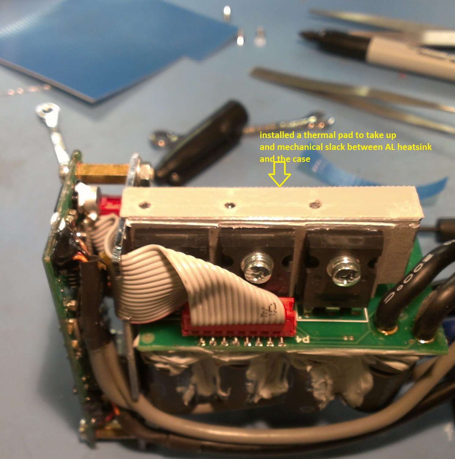

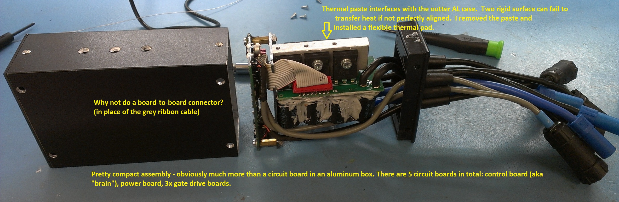

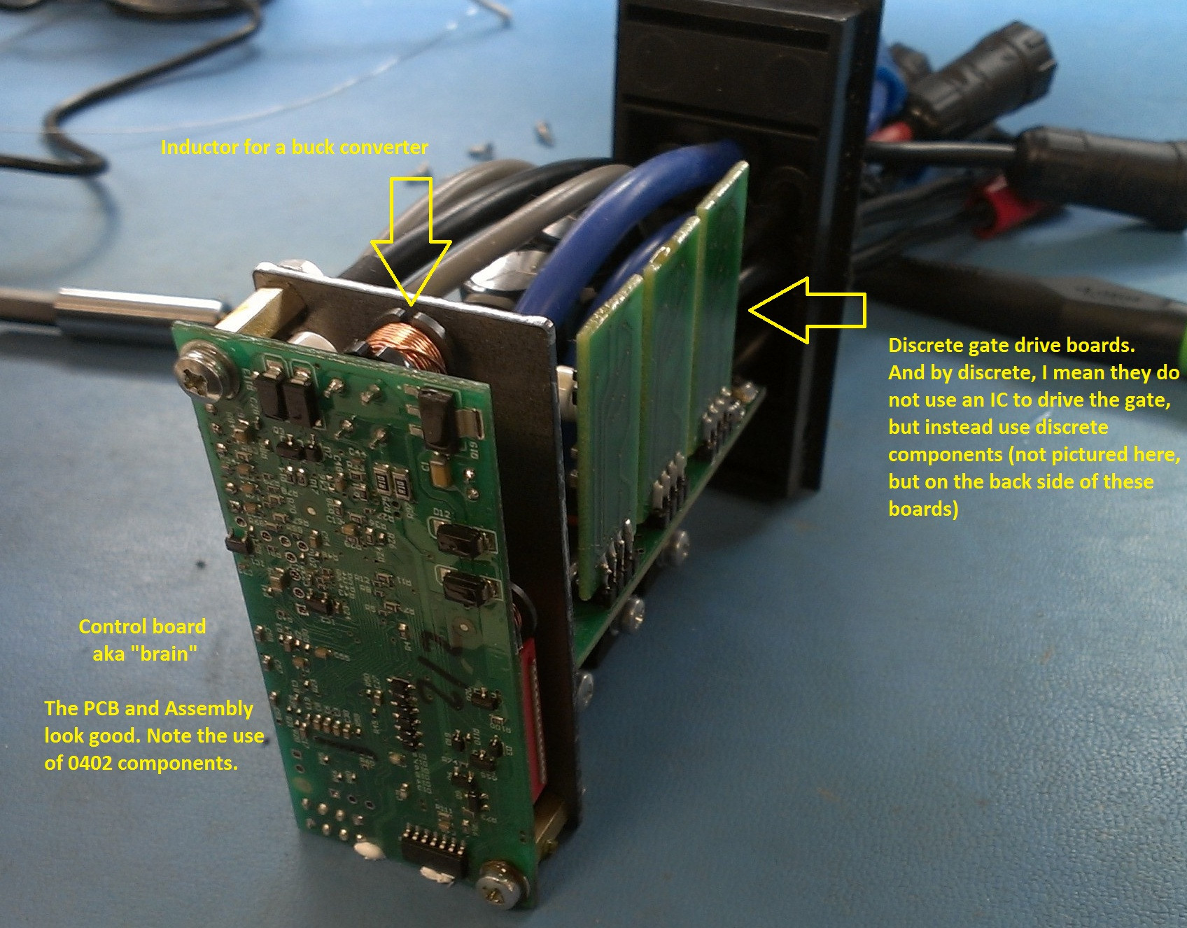

Let's have a look inside the Adaptto Mini-E motor controller.

Very nice. Any close-up shots of the BMS boards?

It's pretty simple. Simple is good. :-)
The heat-path looks like it has some low-hanging fruit available, but using those absurdly good FETs likely means it's not needed.

Are they clustering the FETs instead of putting them in a long line to reduce inductance...like Lebowski's DIY advanced design controller?
jut   1 mW
Posts: 13
Joined: Jul 09 2012 9:40pm
Re: Adaptto Mini-E Controller Teardown
Post by jut » Jul 13 2014 1:37am
spinningmagnets wrote:Are they clustering the FETs instead of putting them in a long line to reduce inductance...like Lebowski's DIY advanced design controller?
I would say yes to that. I like how they put the caps directly underneath the FETs. Makes for a good low impedance path.

Do you guys know which chips they are using on the balance boards? I'm a techie so I'd like to read the data sheets to see what the limits are on these chips. Looks like there is a larger chip on the end, and a smaller chip on each 4S section.
jut   1 mW
Posts: 13
Post by jut » Jul 31 2014 11:03pm
Posted BMS pics here: http://imgur.com/a/Pgpkr#0 ... since the forum doesn't handle high res images that well.
The main BMS board is a 24MHz, ST Cortex M3 processor: http://www.st.com/web/catalog/mmc/FM141 ... 5/PF216837
Part of this family: http://www.st.com/web/catalog/mmc/FM141 ... 5/PF216837
Powerful little guy. Makes me wonder why they're not using the same micro for the inverter. Perhaps I missed it?
The other chip on the BMS daugther boards is a TI msp430f2013: http://www.ti.com/product/msp430f2013
The package markings are:
F2013
1AK G4
D21Z6
I wonder if Adaptto is having IC supply issues being that they're in Russia? I have no idea on this kind of thing.
