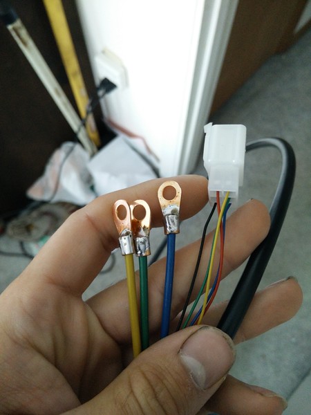

Are you serious... these phase wires are more for a 500w motor... :(

Phase wires look like 18 gauge.. this needs to be remedied... very inadequate for the rating of the motor ( and the hell i plan on putting it through )

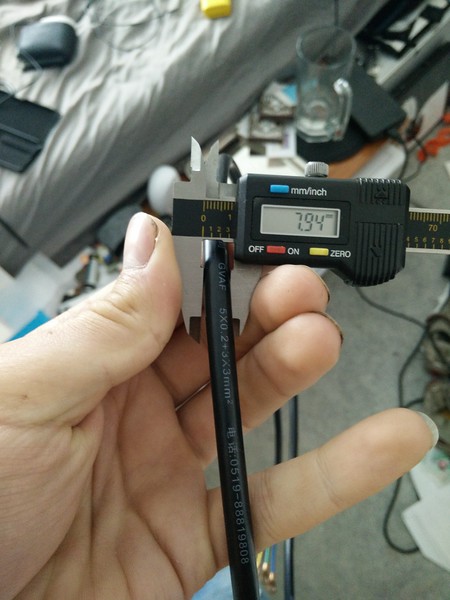

7.94kg for the entire wheel.. nuts, disc brake bolts and all.. so, about 17.5lbs in total. I'd imagine that the hub weight is about 16lb.

O and when I was emailing them they said they were 2mm wires so this equivalates to about 14 AWG.
Unless they were lying to me. :wink:
* Phase wire is 2.0mm.Because no enough room to put thicker wires.
* If possible,we also can make wire to be 4mm.Need to modify axle.If we modify axle,we also need to use other cover to make it.(the bearing is bigger).But the spacing of front motor will more than 120mm,the rear hub motor will be about 155mm.

Given that the phase wires fit in my wire cutter at the 18 gauge point, i'd say that what they're claiming is not matching up one bit ;) ( see pic above also )
What i will do is simply cut the phase wire at about 1.5 inches out of the axle and replace with 12 gauge, as i do with all other motors. Then i get 90% of the benefit of upgrading the entire length of wire. Good enough :)

Nep, those wire cutter are not made for feflon coated wire, where insulation is minuscule. 36awg teflon wire is about1/3 in the diameder to regular vinil? insulated wire (with insulation) :D. To make sure, I measure strand D then calculate area times N of strands. You may be surprised at the end. :wink:
Para, you're probably right, but i cut the wires with the 18ga. setting and replaced the wires with 12 gauge anyway. The 12 gauge looked like double the width.
I have the 12fet 3077 controller all soldered up with 4mm hobbyking bullet connectors as i usually use.. ( these are rated at 90A, yet i've never seen them get warm/hot at 4000w ( battery ) continuous loads for up to 20 minutes, so they should work fine. )
