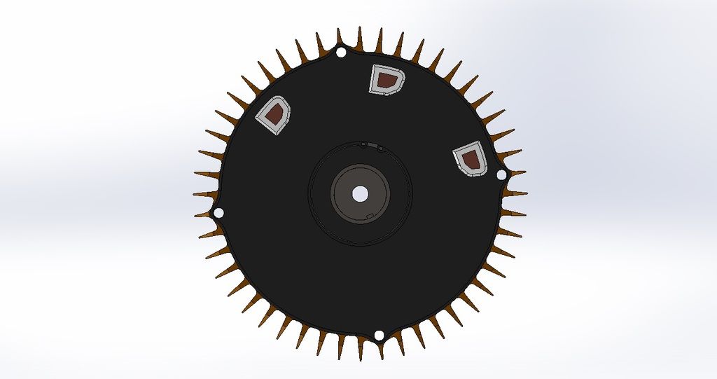

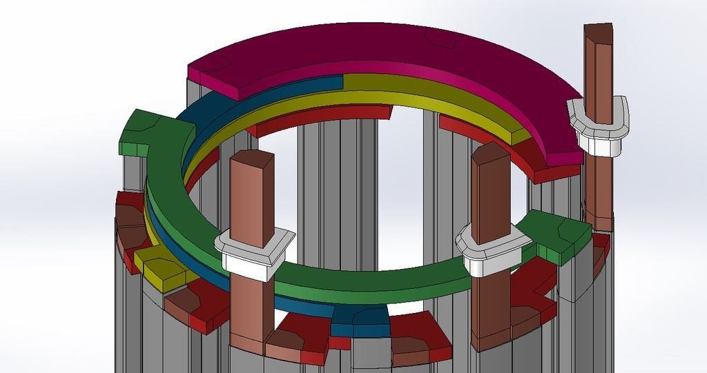

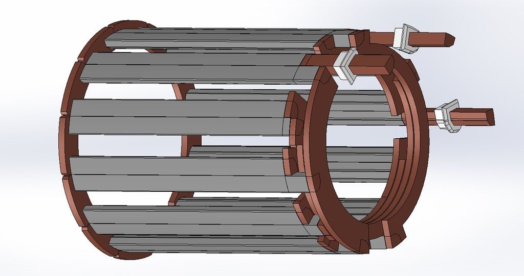

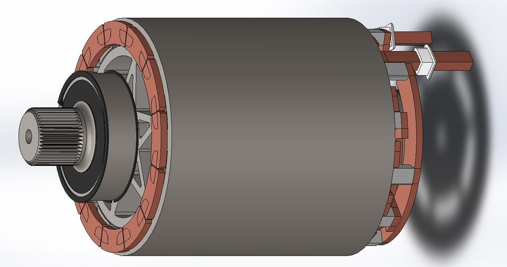

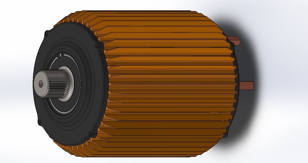

Heya all! quick update. The CAD model for the new motor is done, and it looks awesome. The winding config is 1T with both halves in series, whereas stock is 6t with both halves in paralell. The phase leads will be a machined copper buss that is roughly 125mm^2 cross section. These shaped busses will be joined with waterjet cut "end turns" that will be TIG welded, or copper bolted in place.
Test Review Revise Repeat

Nice work.
So all you will keep is the original rotor and heatsink stack?
Doc

Doctorbass wrote:Nice work.
Doc
All that is being kept is the stator lams, and the three assembled rotors will be mostly untouched. I am unsure about the case on the motor, as I destroyed the existing aluminum cases getting the stators out. The ID is 204.9mm and a press/heat fit to the 205mm stator, as well as a couple of set screws. not too hard to duplicate.

A solidslot motor! Watch out for eddy current losses in the conductors. In most motor designs the cross section of the winding wire is small enough to neglect eddy currents. Not sure if the tooth profile needs to be different for a solidslot motor, as to "shield" the conductors. Looking at a REMY motor with a hairpin winding makes me think you are likely OK, but just throwing it out there.
http://eprints.whiterose.ac.uk/9077/1/Zhu_Influence.pdf
Note the 1 strand winding has 35 turns
Farfle   1 MW
Posts: 1754
Joined: Jun 27 2010 10:42am
Location: Redmond OR
Re: Sextuple Zero 75-7
Post by Farfle » Jul 06 2015 7:11pm
flathill wrote:A solidslot motor! Watch out for eddy current losses in the conductors. In most motor designs the cross section of the winding wire is small enough to neglect eddy currents. Not sure if the tooth profile needs to be different for a solidslot motor, as to "shield" the conductors. Looking at a REMY motor with a hairpin winding makes me think you are likely OK, but just throwing it out there.
It will be an awesome and interesting learning experience to see how all the losses stack up. I have a feeling that the main dominant loss (I^2R) being reduced so drastically will make up for the other potentially increasing losses.
The stock motor has each half as 12 strands of 18awg, and the two halves paralelled for 24x18awg total. each 24x18AWG phase lead is 19.752 mm^2
If the new motor was wound with wire to match the stock amount, it would have 1/6th the turns, which would be 118.51 mm^2, but both halves are in series, so it would only be 59.26 mm^2
With the solid-slot design, SW is saying the cross section will be 124 mm^2, but that is assuming a .5mm nomex insulation wrap, and that the buss bar is a perfect fill in the slot. My machining is not perfect, so I will assume that the windings should be somewhere around 110 mm^2, which is almost double the round wire copper fill :shock: :shock: .

flathill   100 kW
Posts: 1266
Joined: Jul 06 2010 9:26pm
Post by flathill » Jul 06 2015 7:20pm
Note the 1 strand winding has 35 turns (2.65mm) is the thickest they try and you can see the AC losses started to rise faster and faster as the wire size goes up
Don't let this stop you but just something to think of when sizing the conductors. You may want to keep them away from the maximum leakage flux area in the slot
