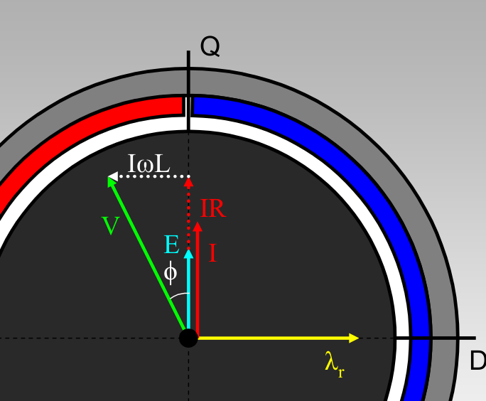

regen vibrates the motor and I know FOC is not working while regen. All this needs work. I don't have much time... It will take time.
I've logged the phase current while riding and while regeneration with FOC disabled (correction angle always 127). The log shows, that the phase current is 120° late at regen. In my fork I normally read phase current at 180°, now I suggest to do the reading of the phase current at 60° when battery current is negative. I've implemented it in the latest commit, but I have not tried it on the road, as it's already dark outside... :shock:
I think you had a similar idea, as you had the parameter
Code: Select all
#define FOC_READ_ID_CURRENT_ANGLE_ADJUST_INVERT 242
in your code at an earlier commit, but I can't find that in the recent master branch any more?!
regards
stancecoke

Thanks for logging and testing. Really nice to see that is really different on both situations.
Also see that 2 lines may not be comparable since the current phase displacemente depends on motor speed and current, and I think you can't assure they were registered on that same conditions.
One thing: I remember to play with magnets and if we think we have 2 magnets, were 1 we control his position (by controlling the pahse current), we need to put at a specific distance to have max attraction force (90 degrees per FOC).
At motoring mode, we want let's say to put current at 90 degres. At regen mode, we want to push to the other side, so, at -90 degrees. Maybe at regen mode we need to put current at -90 degrees, or the same as 270 degrees.
And also, since the current is flowing to battery, on the inverse direction, shouldn't the phase current be inverted 180 degrees also??

After thinking a little: The current controller pulls the dutycycle to zero, if high regen current is wanted. In this case the correction angle can't have any effect, as the PWM puts no sinewave to phase lines.
Can we achieve higher regen current, if we set a higher dutycyle and a "misstuned" correction angle?!
With dutycycle = 0 I get about 1.5A regen current at about 20km/h with my BionX...
regards
stancecoke
No, the current controller tries to decrease the duty_cycle. Let's say motor is rotating at 100 erps and that gives a 12v BEMF. If duty-cycle value equals to a 12v from battery, no current flows. If you decrease duty-cycle a bit, now the voltage from battery will be lower than the BEMF voltage from motor and current will start to be regen.
So, on motor regen duty-cycle is not always zero but will be a value in a way that regen current is not more the value we define/control, so, there will be sinewave phase voltages while regen. Maybe the current phase will simple invert in direction and so shoild have 180 degrees...
You mean changing the angle to get regen?? Idon't think so. On FOC, for regen and invert rotation, we change Iq current from positive to negative. Let's say motor is running with a reference Iq = 10A, to start regen we should put Iq ref = -10A.
If we imagine 2 parallel rails, with 2 magnets on each rail at a very low distance each one, one north pole and other south, they will attract them selfs and stay inline (0 degrees). Now if we move one, the other will follow and if the other has some contrary force to movement direction, like a pull finger, the max torque will be at 90 degrees an not inline 0 degrees. If we push the first magnet to right to move the second one, max torque will be at 90 degrees and after being moving, to brake, max torque will be at -90 degrees (now on the left side).

casainho wrote:
Apr 18 2018 10:18pm
I don't know if it's a matter of the BionX. As I wrote, the max regen current I get at 20 km/h is about 1.5Amps only. If I ask for e.g. 5A regen current, the current controller drives the duty cycle to zero. If I ask for e.g. 0.5 A, of course the dutycycle will be higher than zero...

casainho wrote:
Apr 19 2018 2:38am
Have you ever tried to shift the correction angle by 127 (=180°) for doing regen? In the german forum there was a similar suggestion.
regards
stancecoke

stancecoke wrote:
Apr 23 2018 2:41am
casainho wrote:
Apr 19 2018 2:38am
Yes, that is one idea but I prefer to keep looking at the same place and consider the signal is now inverted and so invert the logic for increase/decrease the ui8_angle_correction. That's because of possible errors on current implementation, due to overflow of the 8bits variables like this ui8_motor_rotor_angle >= FOC_READ_ID_CURRENT_ANGLE_ADJUST.
Anyway, I also need to see because just recently I started to look for the first time to phase current to understand if the system is doing regen:
Code: Select all
  // make sure we just execute one time per ERPS, so use the flag ui8_flag_foc_read_id_current
  if ((ui8_motor_rotor_angle >= ((uint8_t) FOC_READ_ID_CURRENT_ANGLE_ADJUST)) && (ui8_flag_foc_read_id_current))
    ui8_flag_foc_read_id_current = 0;
    // minimum speed to do FOC
    if (ui16_motor_speed_erps > MOTOR_ROTOR_ERPS_START_INTERPOLATION_60_DEGREES)
      // read here the phase B current: FOC Id current
      ui8_adc_id_current = UI8_ADC_MOTOR_PHASE_B_CURRENT;
      if (ui8_adc_id_current > ADC_PHASE_B_CURRENT_ZERO_AMPS_FOC_MAX)
	// limit max ui8_angle_correction value (127 + 15)
	if ((ui8_angle_correction+1) < 143) { ui8_angle_correction++; }
      else if (ui8_adc_id_current < ADC_PHASE_B_CURRENT_ZERO_AMPS_FOC_MIN)
	// limit min ui8_angle_correction value (127 - 15)
	if ((ui8_angle_correction-1) > 112)
	  // decrease only when not regen!! other way ui8_angle_correction will always decrease... CAN WE IMPROVE THIS??
	  if (UI8_ADC_BATTERY_CURRENT > (ui8_adc_battery_current_offset+2)) { ui8_angle_correction--; }
I can look at 2 different values to understand if regen is happening: shunt value or hall phase current sensor. Unfortunately I can't put my ebike with direct drive motor on the bike training roller because the motor bolts are to large to fix the training roller and so it is hard to me to make regen happen and observe in real time with oscilloscope. Sure there are other ways, but they take much time that I don't have currently.
But one way or the other, I think I have now more knowledge that will permit to solve the problem. I think I really need to phase current in real time and see to where it should be adjusted.... and I think:
is the vector I*w*L that gives the direction for phase voltage V, since for regen I will change in direction, will be -I*w*L (maybe the vectors will now be placed on -Q axis of that graph and V should be adjusted now on the inverse direction, because we want to go to the other side/direction of the magnet (D axis, phi magnetic flux).
When regen, I think the V vector will also be negative because now the voltage differential on the coils also invert directional so both I and V will be placed on -Q axis.
So, to resume, I think we should keep the same reference rotor position (D axis, max phi magnetic flux/BEMF) + 90 degrees and looking to battery current (or phase B current??) to understand if regen is happening and if so, adjust increase/decrease phase B voltage angle (ui8_angle_correction) on the inverse direction. (or at the same reference rotor position (D axis, max phi magnetic flux/BEMF) - 90 degrees and keep the same logic for ui8_angle_correction increase/decrease) and you suggest).
