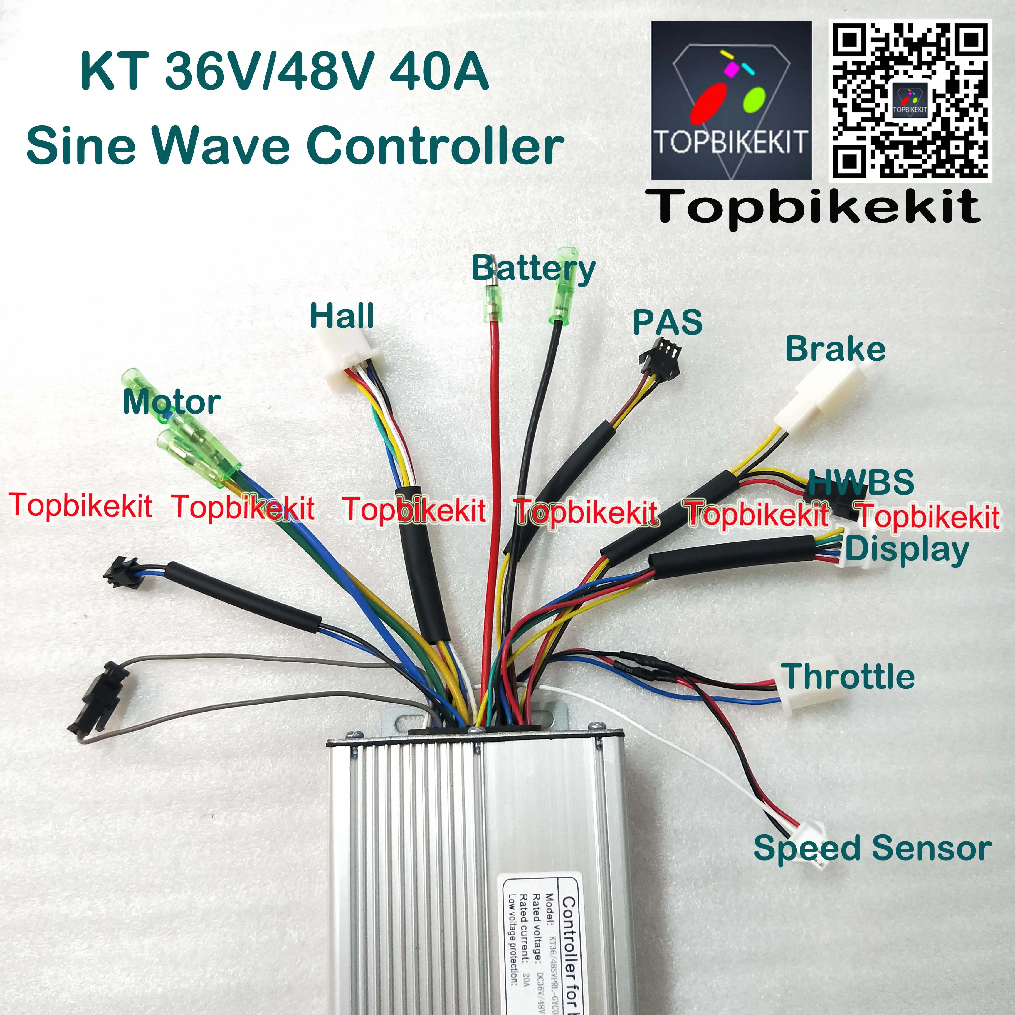

I'm sorry this is a bit OT, but this seem to be the place to ask about KT hardware and software :wink:
Does anyone know what the 3 unmarked connectors on the left could be for (2 of them are connected in the picture)?
obcd   100 W
Posts: 159
Joined: Jul 16 2019 3:45pm
Re: KT motor controllers -- Flexible OpenSource firmware for BMSBattery S/Kunteng KT motor controllers (0.25kW up to 5kW
Post by obcd » Mar 31 2020 9:15am
Some controllers have a 36V output for a headlight / backlight.
It's usually a small additional pcb in the controller that has the switching fet for that output.
Some controllers have an auto sensing of the hall sensor wires.
In such case you usually have to disconnect a link for the auto detect (learning) mode to become active.
It's also possible that the link is there to disable / enable the street legal speed limit.
