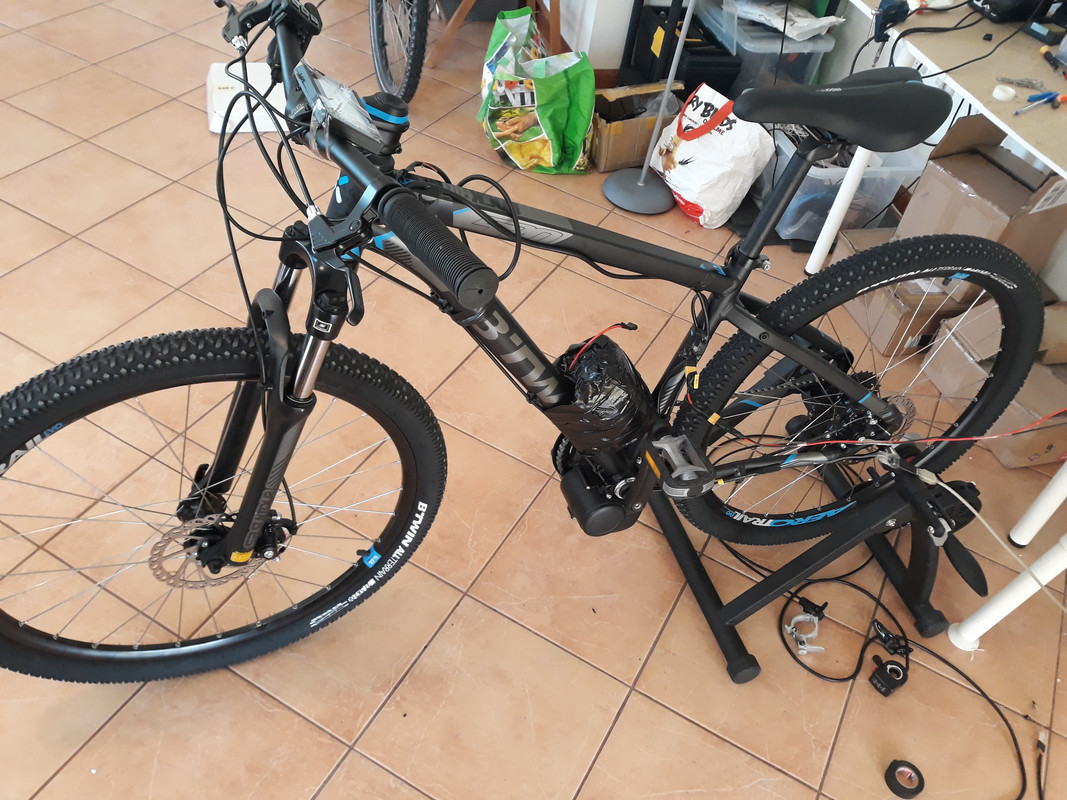

installed the firmware on the new controller. without load - speed 47km/h with a load of 5km/h. the wheel continues to spin after releasing the throttle. Is it possible to adjust the lower value of throttle?

I thought the problem with the released throttle was solved?! Please upload your config.h again!

Sometimes the wheel starts to rotate itself without pressing the throttle.
what to choose? pwm directly or current / speed?

Basia wrote:
Jun 20 2018 4:01pm
Two possibilities:
1. turn the throttle slightly while switching on the system, then release it after a few seconds
2. Put a small offset to the variable ui8_adc_throttle_offset in the adc.c, as you did it for the battery current before.
Code: Select all
for (ui8_i = 0; ui8_i < 16; ui8_i++)
    ui16_counter = TIM2_GetCounter () + 10; // delay ~10ms
    adc_trigger ();
    while (!ADC1_GetFlagStatus (ADC1_FLAG_EOC)) ; // wait for end of conversion
    ui16_adc_throttle_offset += UI8_ADC_THROTTLE;
  ui16_adc_throttle_offset -= 8;
  ui16_adc_throttle_offset >>= 4;
  ui8_adc_throttle_offset = ui16_adc_throttle_offset;
Basia wrote:
Jun 20 2018 4:01pm
You should use current/speed setting.

nothing has changed, after one minute the wheel starts to twitch. short pulses are applied to the wheel. I do not understand anything (((
