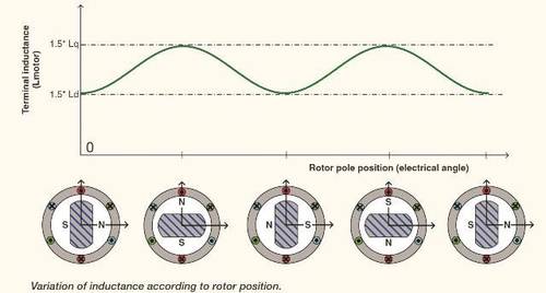

Perhaps measuring phase inductance with an LCR meter at different rotor angles. An IPM has the characteristic of having a minimum and maximum inductance, while SPM in theory™ has a flat inductance
IPM inductance:
The IPM parameter detection we should implement someday is based on measuring these min and max inductances.

It was likely an IPM motor, but we can't tell for sure until we see that motor rotor. If its an SPM the current will work out of the box.
If its an induction motor (unlikely) we are not quite ready to provide ACIM FOC support, it has to come after IPM support, because of the likeliness of these control board users having IPM's.
