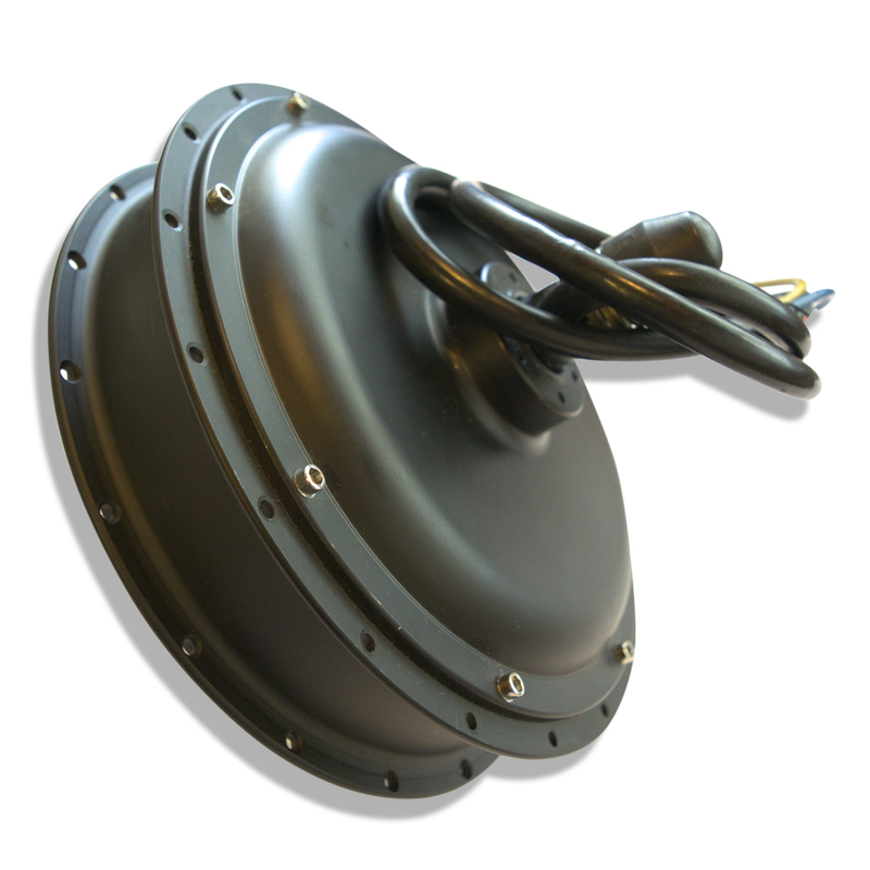

I have this unbranded 3kw hub which is super common in my country but I have no idea what to choose from the list as a type of motor when purchasing the Hubsink V2?
Aren't most of the MXUS/Cromotor and such the same diameter? what about width? and if not, how do I choose?
This is the photo of the actual motor:

The pic is not really reveling much useful information for me. If you could use either a tape measure or a caliper and measure the width between the flanges and the outside diameter of the motor, measured in the middle of the flanges. If you don't got a tape measure at hand use a piece of string or slice an A3 paper and just mark where it meets around the center of the hub and measure the length with a ruler or if your caliper got a ruler on one side.
Most likely you can fit 2 hubsinks side by side if you fancy if that motor is a 205 50H clone or no-name version. Iirc the width of the Qs 205 50H between the flanges are 40 mm. The hubsink is just under 18-19 mm wide. So for a 205 clone two hubsinks will fit side by side should you fancy that, at least 1 hubsink should fit just fine unless your motor us very narrow less then 18 mm between flanges or have an unusual out diameter dead center between flanges.

It's a 45H magnet, not 50H.
I will measure.
but why are the hubsinks so narrow for such a wide motor?
It's expensive enough and I need to buy two?

No no you only need one. Have you got Ferrofluid yet? Hubsink works very well with Ferrofluid.

I talked to the guy through their website and he said that if the flange spacing is higher than 35mm then I can fit two sets but thats super expensive for me.
